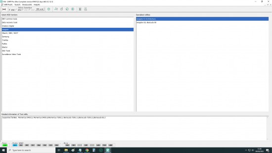

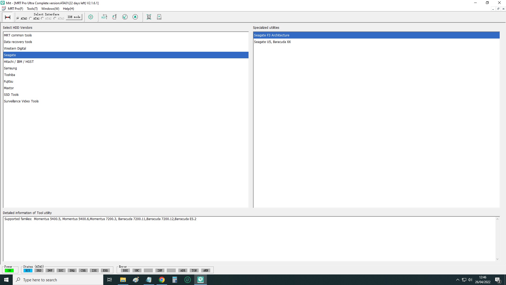

Hi everyone's. I need your help..
My Seagate hard drive
model Barracuda ST500DM002
capacity 500Gb
f/w KC47
date code 14072
It is keep BSY / busy in MRT. Hard drive no clicking, spindle and initial heads movement sound is normal.
Anyway try to swap with same hard drive, problem remain. Sure not head problem.
Your help is appreciated
File comment: Seagate Barracuda ST500DM002 f/w KC47 MRT keep BSY, busy
