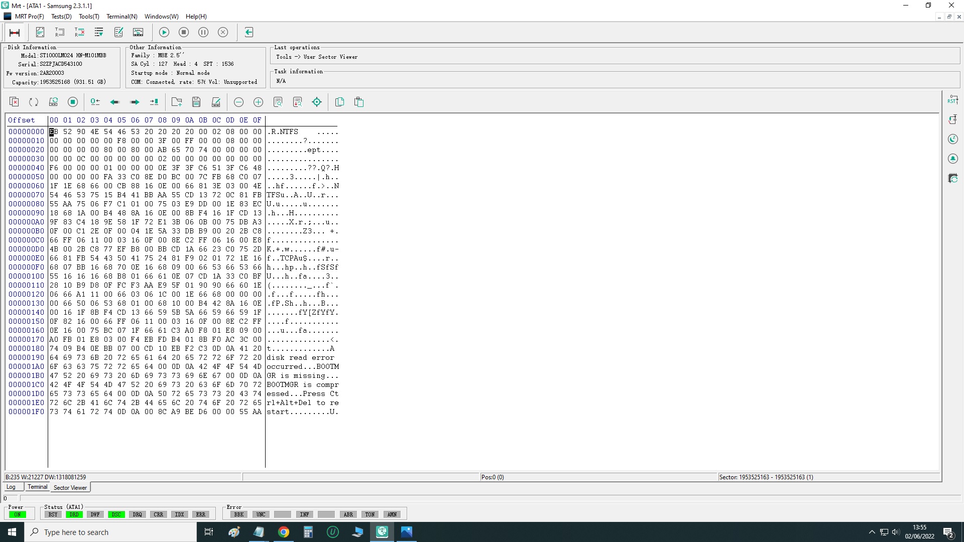

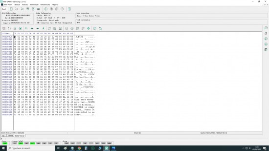

User sector viewer from end to end is works fine, find on attachment. Only DE having problem.

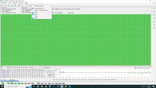

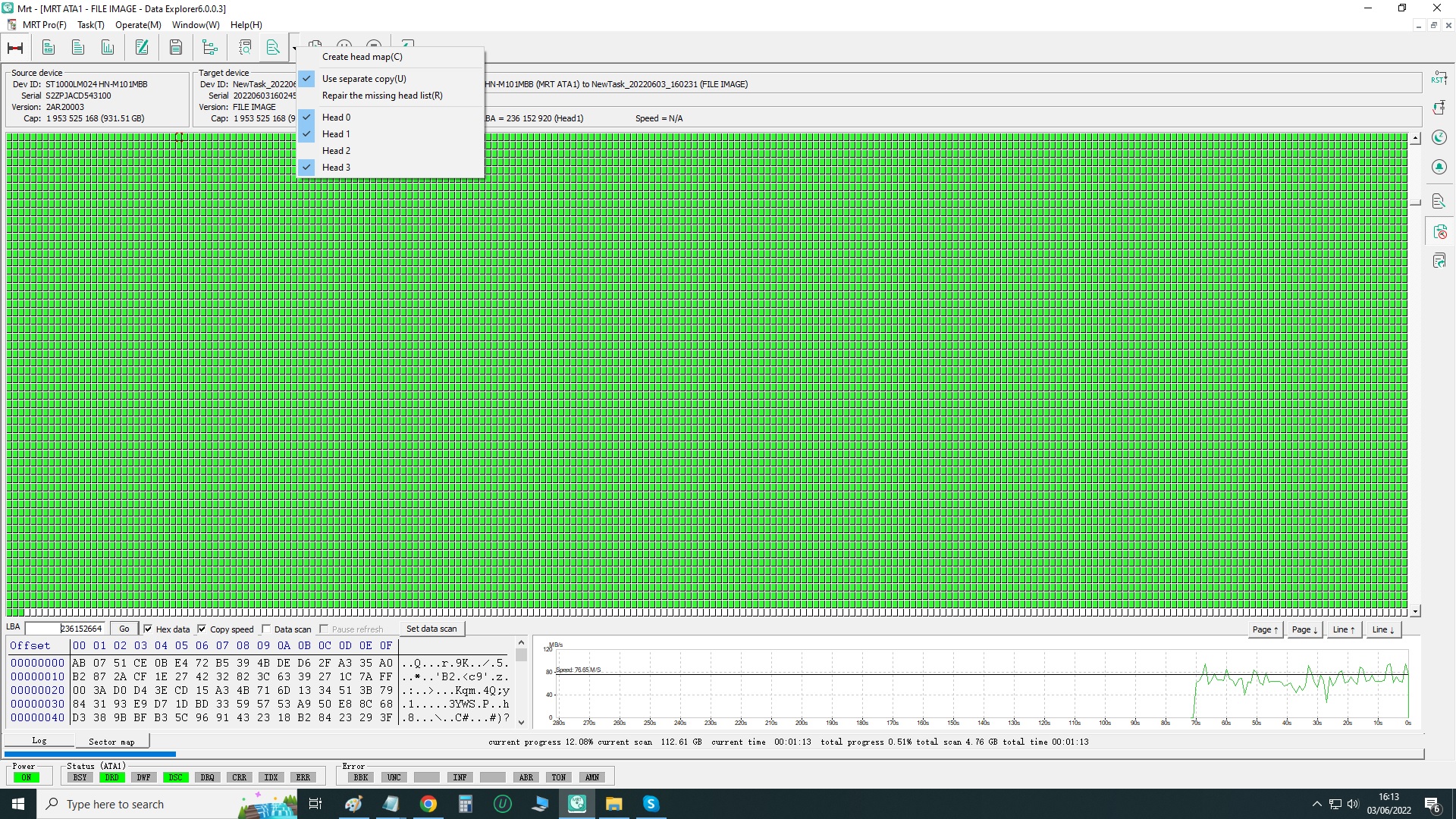

PROBLEM SOLVED !
Hi Pepe..
You are right, one of the head is may bad and effected to all the heads, unless I repeat the DE process and shield/skip Head 2 in advance, and Head 0,1,3 doing the job very well.

Recently one of my same model hdd ST1000LM024, H1 makes issue.
I initialized with hdd with headmap edit in mrt as 00 03 02 03 and selected the option Forbid change in SA.
All 4 heads started to image with some bad sectors ( H1 also read good but slow in initial Area)
 Post subject: Re: Samsung ST1000LM024 HN-M101MBB/AV1 SA good, DE bad
Well,
We are working on a small experiment for ST1000LM024 and i will share results soon
PostPosted: June 8th, 2022, 1:35
Posts: 4779
Are you sure the data from H1 is correct? The way PC3k used to 'change head map' is pretty much inappropriate and if MRT cloned that you might have gotten data from H3 instead of H1.
This is because they remap zones instead of changing head map actually, so drive doesn't report error if you access data from the remapped head.
I never use this function in pc3k, have my own ways...
