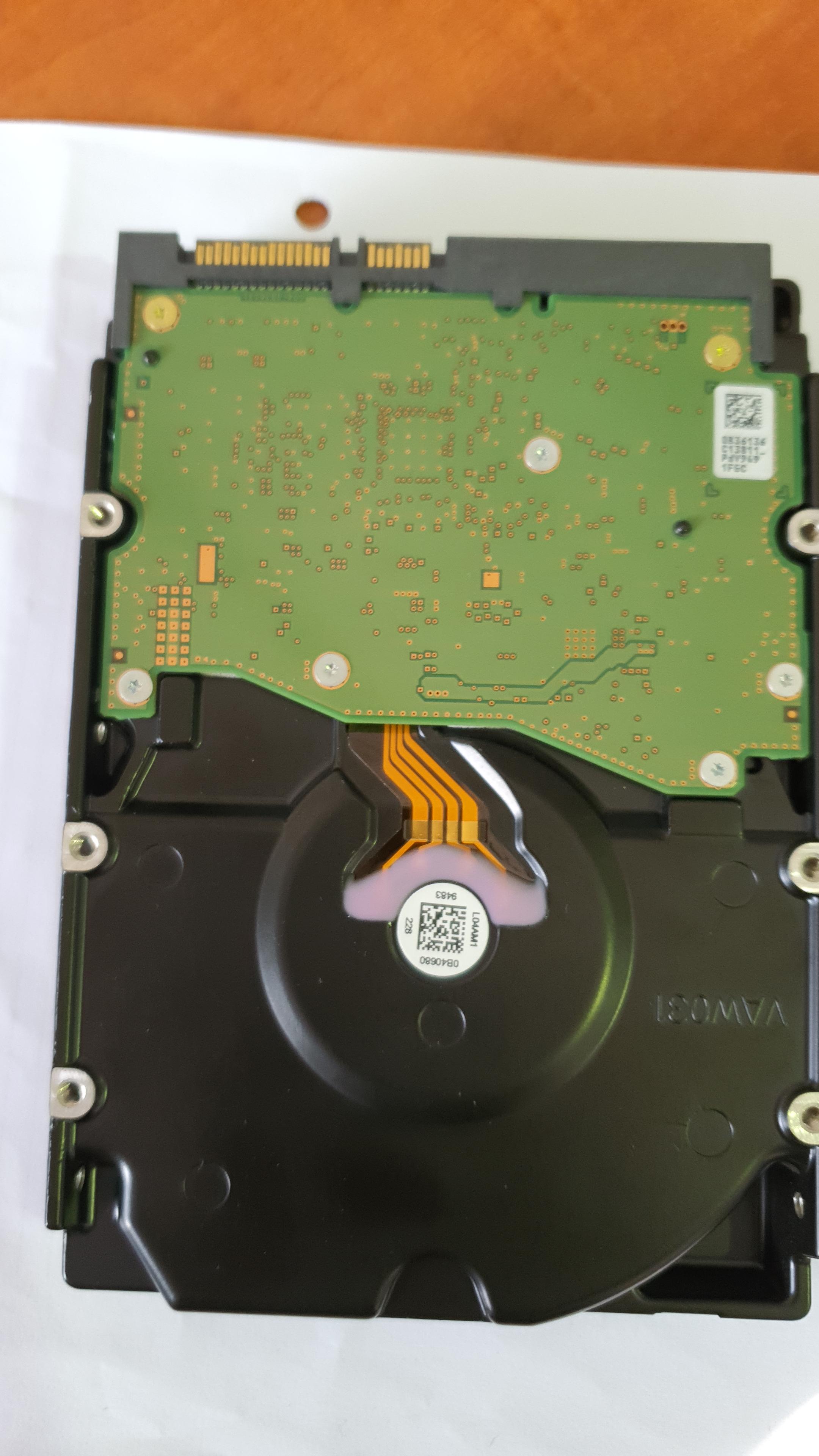

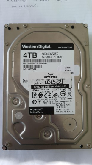

I have a fairly new WD drive which seems to have a locked firmware. PCB version is 004-0836131.
Is there a way to unlock this firmware? MRT does not support this version.
Thank you.

Well ,
Show us a picture please

Please see pictures of the drive.
processed-55bf81a2-1523-4f19-a28f-f445ed984a29_T0Xlyko0.jpeg [ 541.43 KiB | Viewed 12893 times ]
processed-31eeb0c4-ba36-4845-8276-24032bdf0fad_yFFEbWAS.jpeg [ 505.48 KiB | Viewed 12893 times ]

This drive is not WD ROYL but HGST CCB architecture.

This is Hitachi Arch As The Gentlemen Above Said

The PCB is 0B36131. WD PCBs begin with "2060-". HGST PCBs begin with "0A" or "0B".
WD's warranty checker ...
https://support-en.wd.com/app/warrantystatusweb
... identifies the drive as ...
    WD4005FZBX-00K5WB0
    WDVL6
    7200
    256M
    SATA3
    6GB/S
    4.0 TB
    6HD
    STD
    HGST
I think the family could be Vela (Vela-6 ?).
US7SAN6T0 is an Ultrastar DC HC310.
https://documents.westerndigital.com/content/dam/doc-library/en_us/assets/public/western-digital/product/data-center-drives/ultrastar-dc-hc300-series/product-manual-ultrastar-dc-hc310-sata-oem-spec.pdf
Another clue is in the leading characters of the WWN (which you have obscured).
