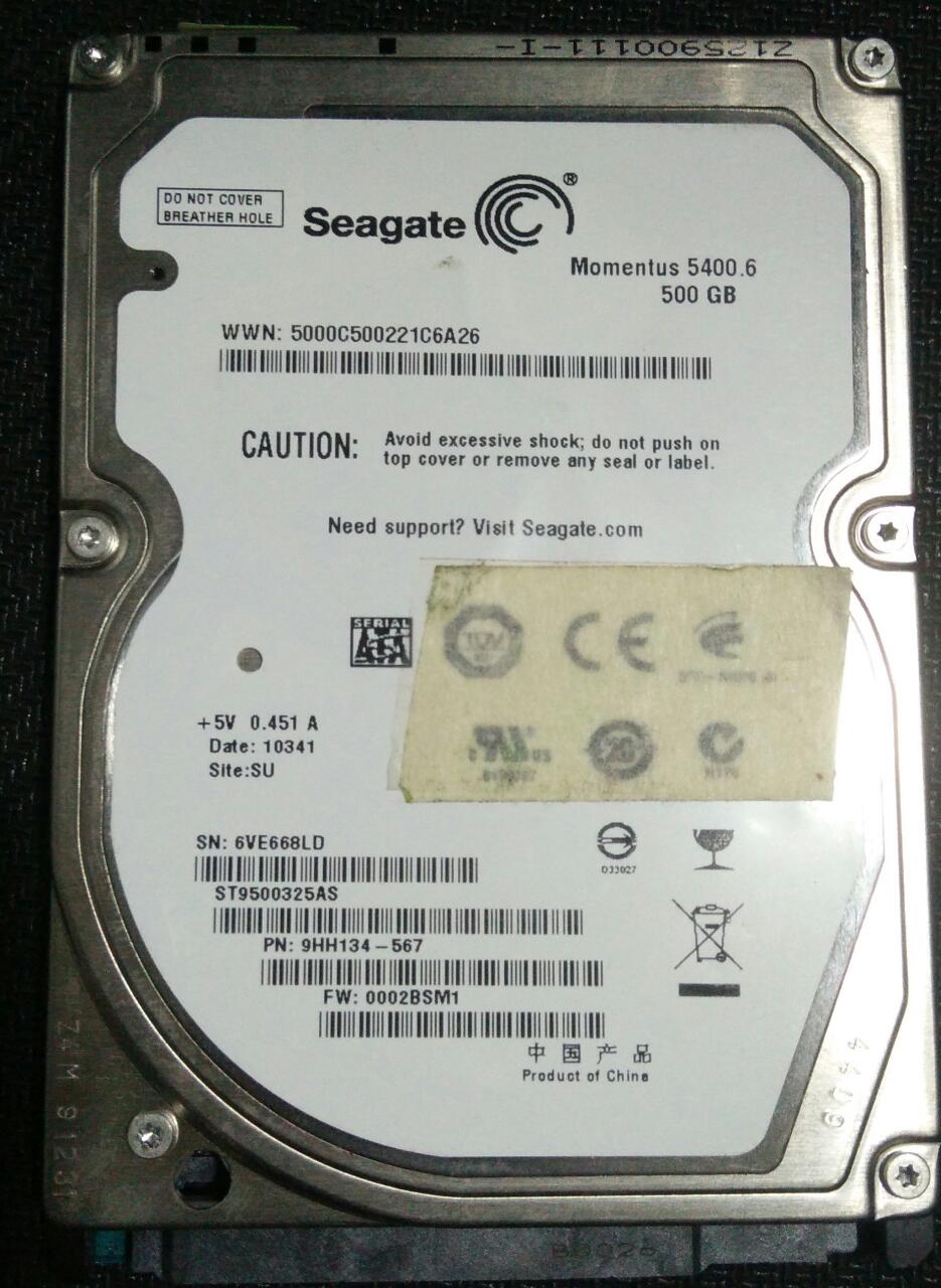

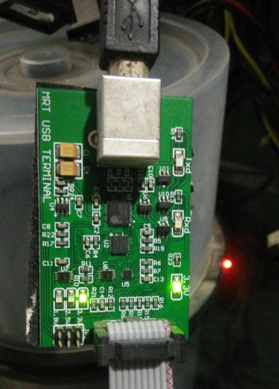

any Seagate Hdd i connect it doesn't give me ROM access or doesn't read via serial port.

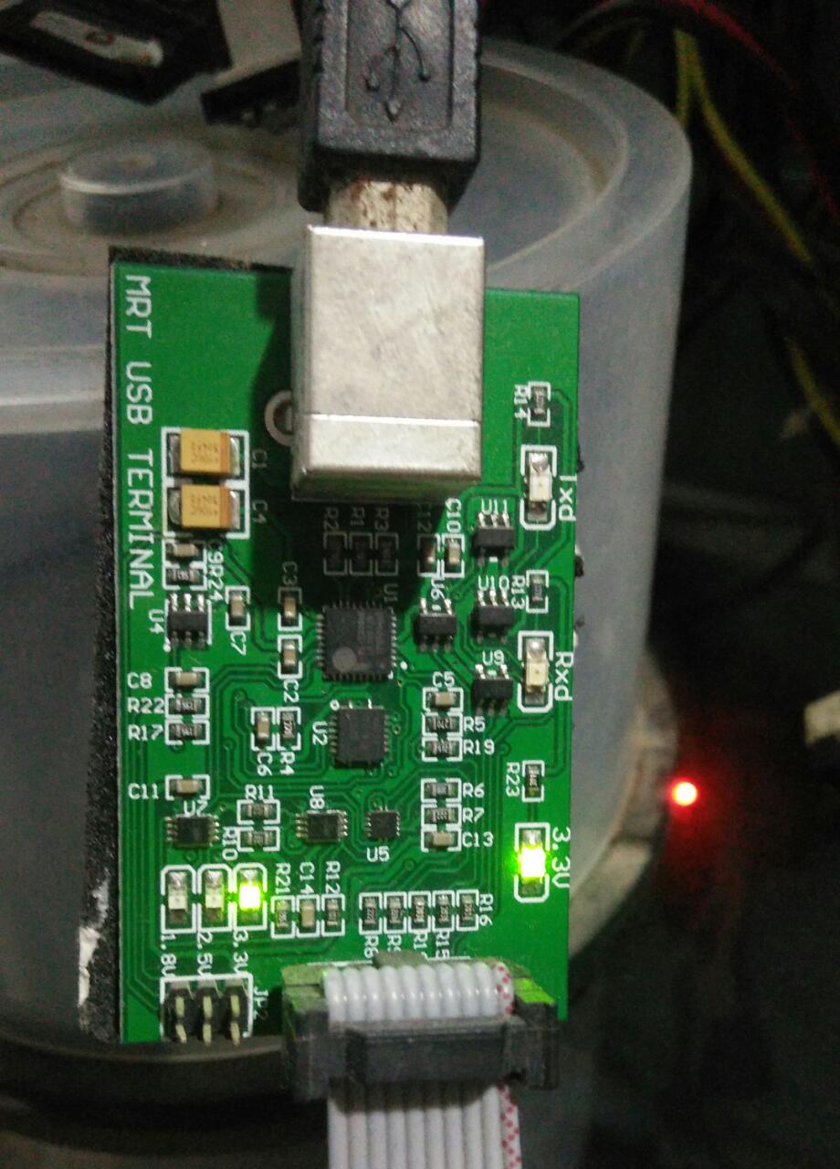

MRT USB TERMINAL (ATTACH IS PHOTO)

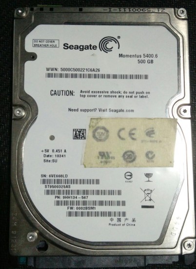

Normal hdd is attached photo
ST3500325AS | 500 GB

SERIAL PORT ERROR AND NOT READING service area.
even while reading ROM it fails via bootcode.
even ctrl-z doesn't work in terminal mode.
what is problem

If i remember well, few years ago i had same issue.
I replaced the terminal adapter and problem solved. Probably your adapter is faulty.
