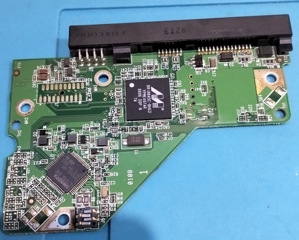

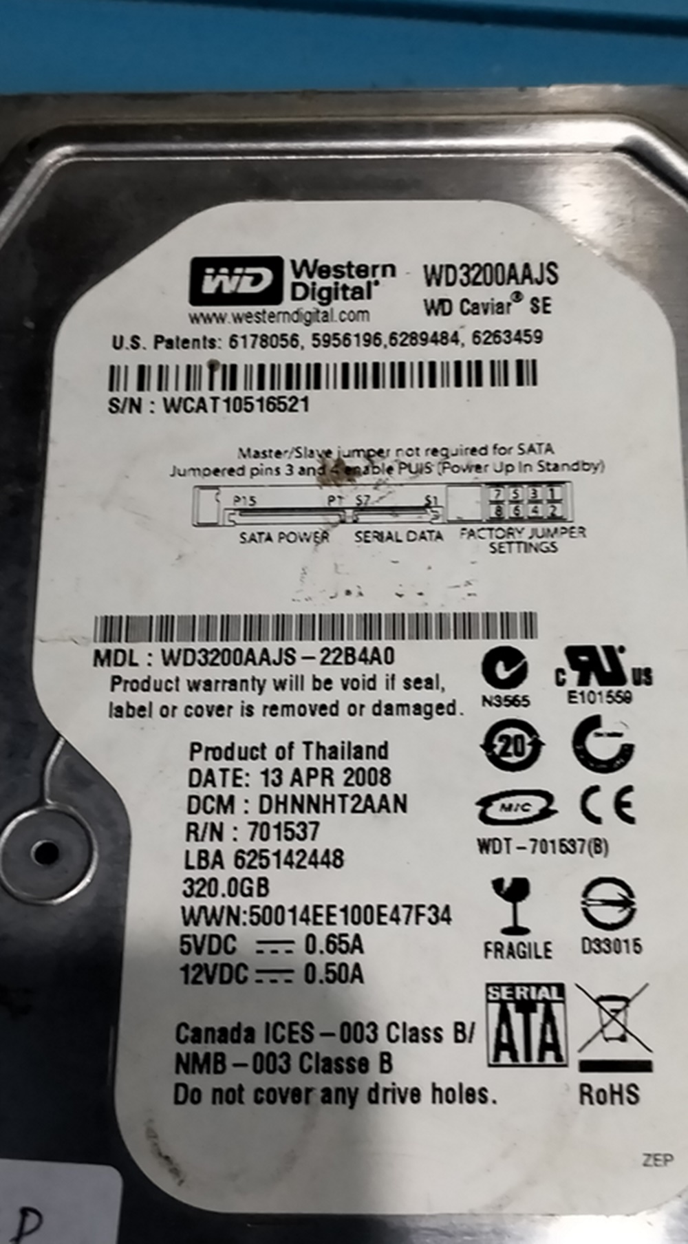

 Post subject: WD family Pinclite WD320AAJS ROM copy failed
PostPosted: November 26th, 2022, 4:21
Joined: January 20th, 2021, 0:27
Posts: 109
Location: Indonesia
I am having problem to copy ROM from old WD family Pinclite 320Gb WD320AAJS using MRT, it is always failed. Other model WD 80Gb WD800AAJST, also have same problem . There is no 8pin IC for copy using external programmer as my option, anybody know how to copy ROM from those WD hard drive?
Thank you.

You need to rebuild ROM with new PCB.
 Post subject: Re: WD family Pinclite WD320AAJS ROM copy failed
PostPosted: November 26th, 2022, 7:09
Posts: 2854
use compatible ROM (something close by SN) should work if drive is healthy
or hotswap

Hi einstein9,
Thanks for advise, I will try to get same hdd.
