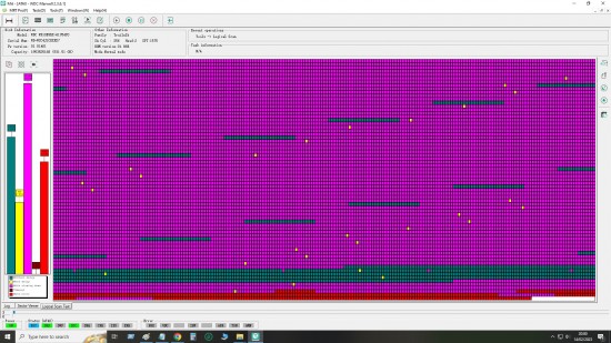

Location: Indonesia

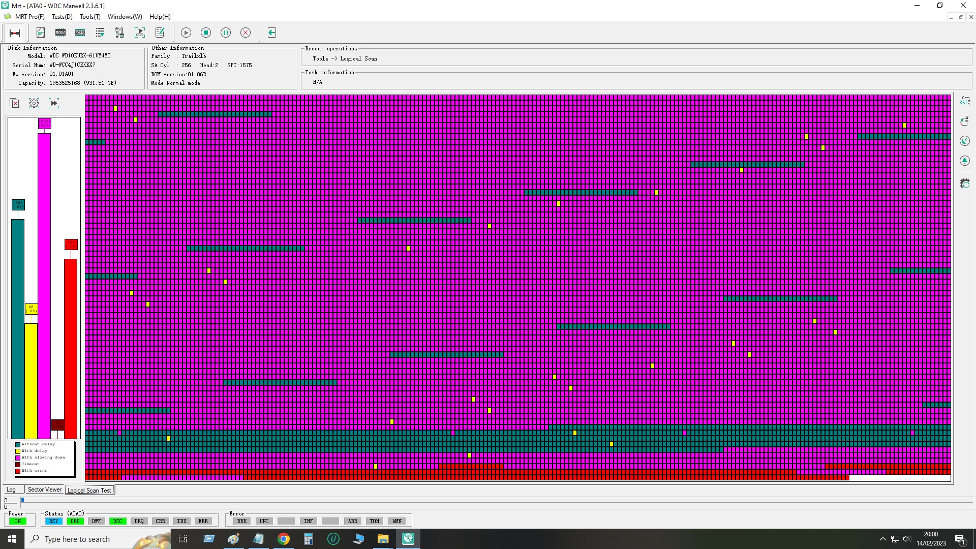

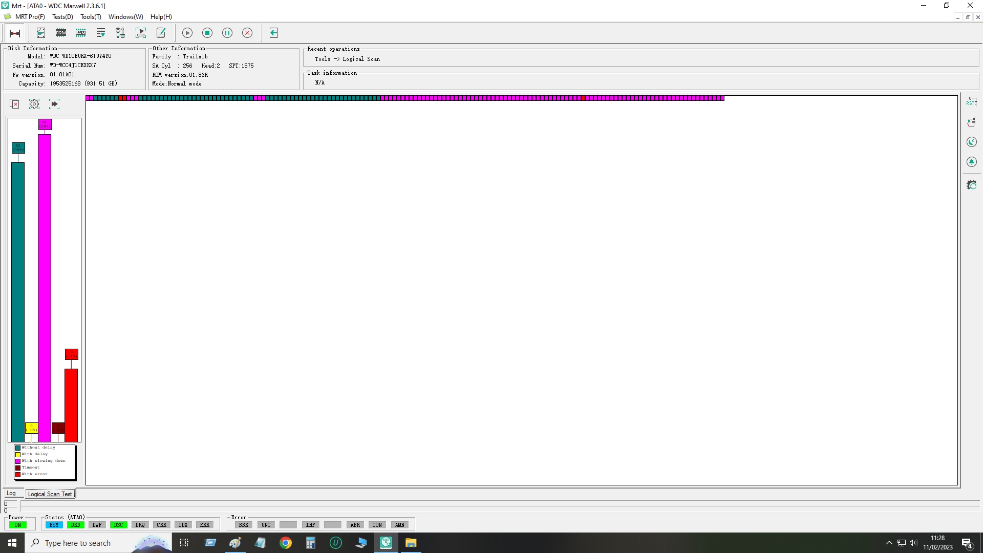

I have problem with WD WD10EURX-61UY4Y0,Trailxlb, 1Tb.
SA, Hdd resources, read and saved > OK
User sector viewer > OK
Head test, min sectors to max sectors> OK
Logical scan test > FAILED , as in attachment pics, from LBA 0 to max LBA 1953525168 , it is remain same problem.
How to fix this issue?
Thank you.

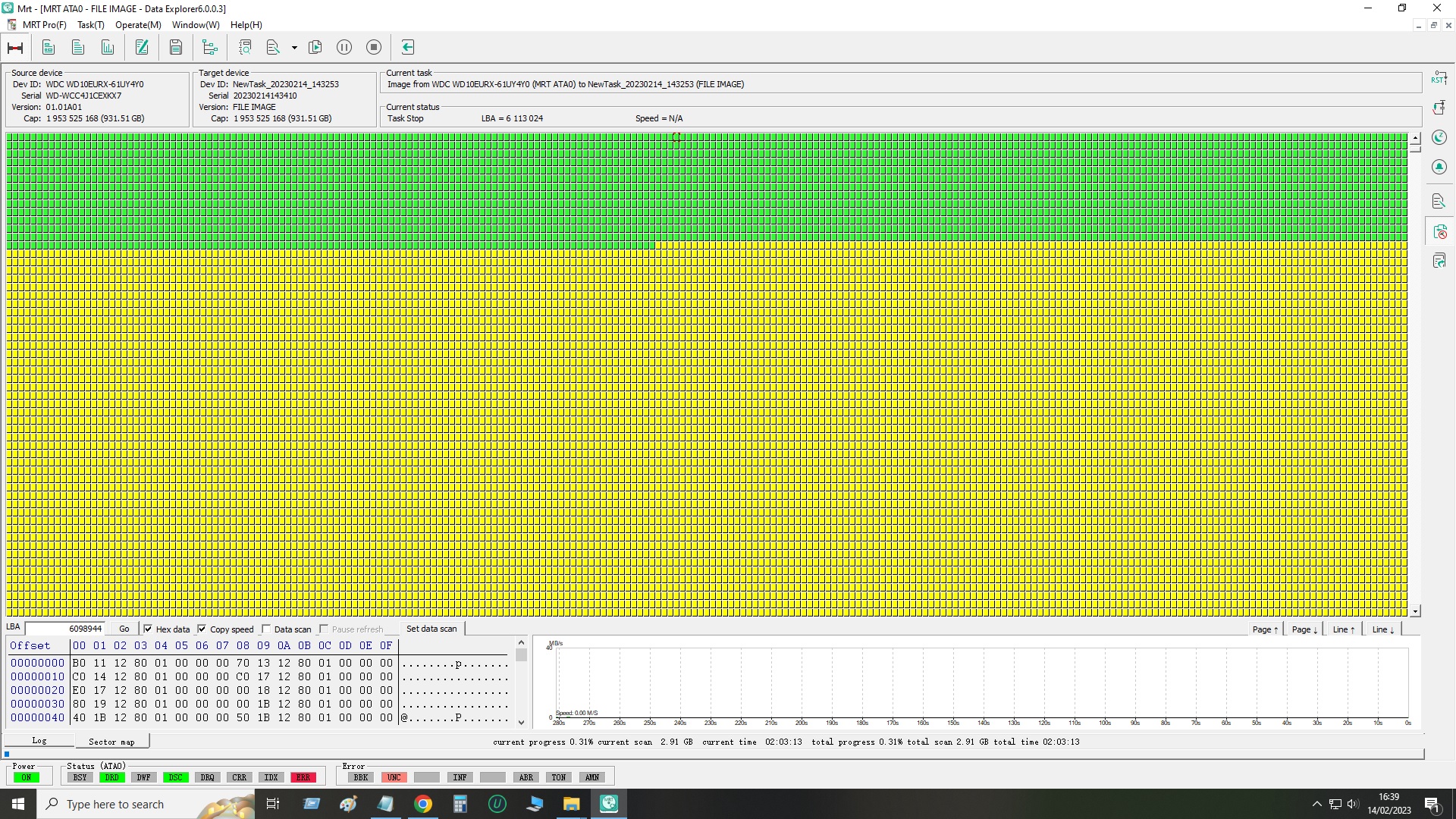

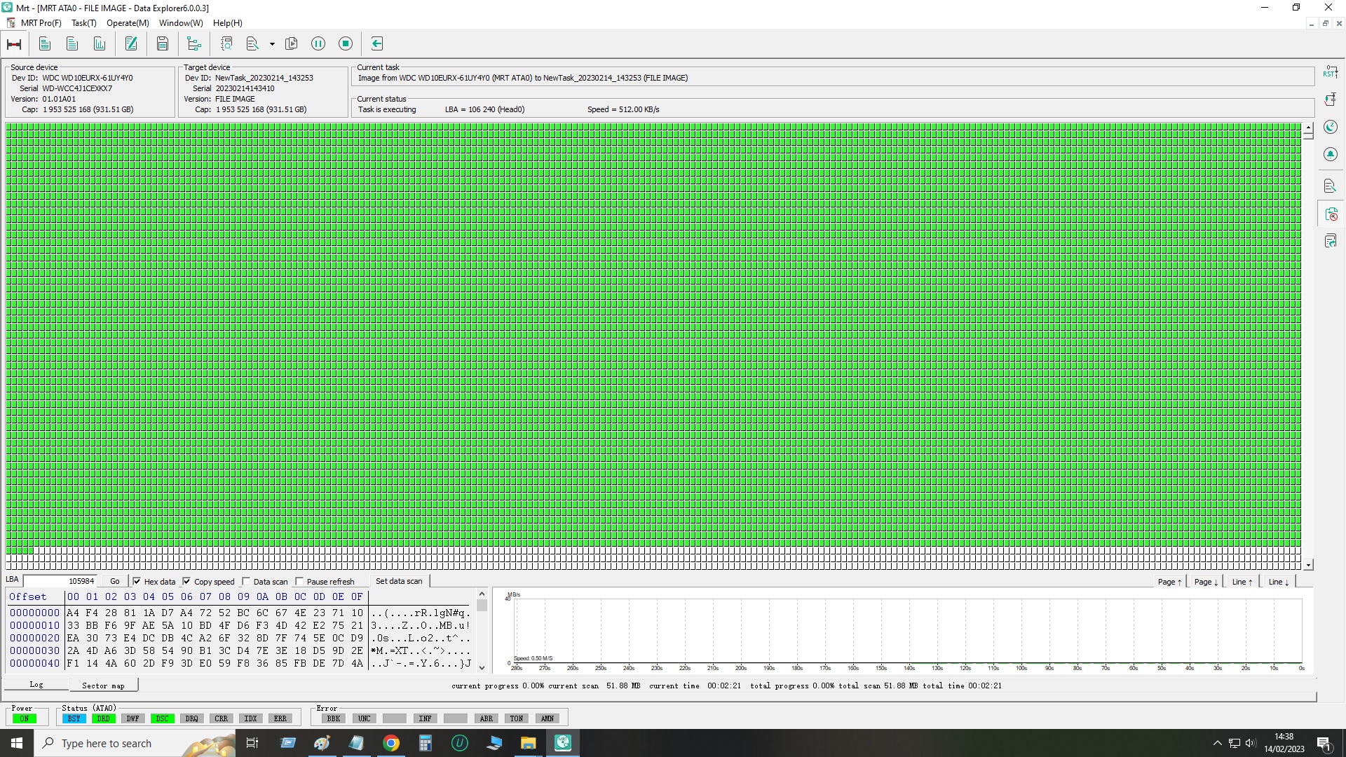

RE-write ROM modules and proceed DE.
It is now DE imaging is works , but in very slow speed 300-500kb/sec only.
Possible the heads weak?

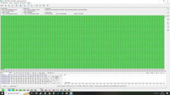

 Post subject: Re: WD WD10EURX-61UY4Y0,Trailxlb, Logical Scan Test failed
PostPosted: February 14th, 2023, 5:33
Posts: 4840
is the speed the same on all heads?

Yes H0 and H1 same speed

Bad luck... it is stop and error to DE :( :(

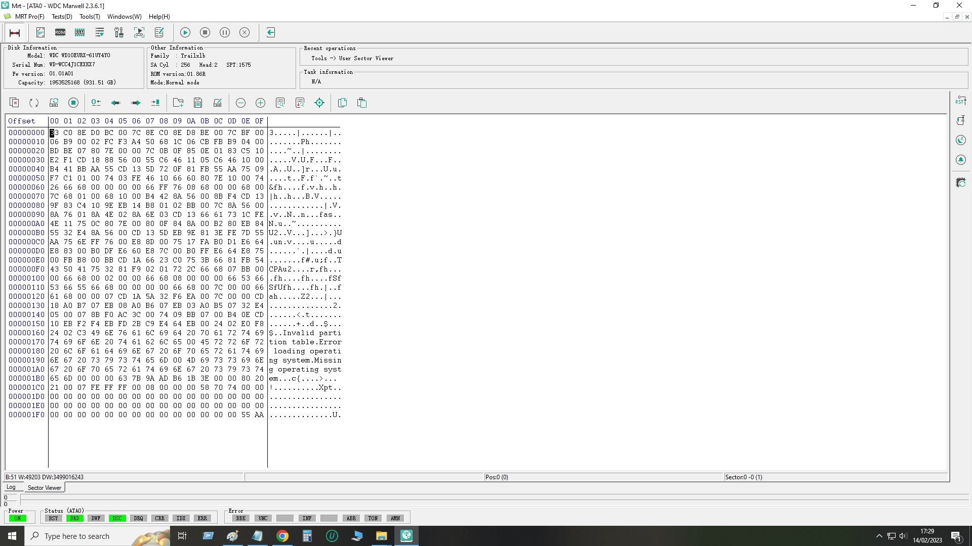

User sector viewer, begin to end no issue

Logical scan test remain failed :(

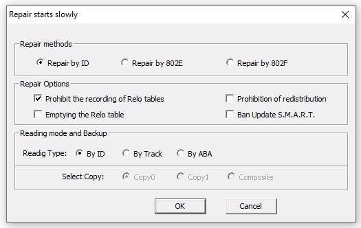

PostPosted: February 15th, 2023, 6:04
Joined: January 20th, 2021, 0:27
Posts: 109
Location: Indonesia
Or it may any special option should I select in "slow response pop up menu"? I just select as it is.
PostPosted: February 15th, 2023, 15:46
Posts: 17311
Repair by 802E/802F is not an option since both modules are empty.
I would think that you should tick all the Repair Options boxes, but I'm not a pro.
I would dump the SA again after applying this fix.
PostPosted: February 16th, 2023, 6:59
Posts: 1768
Location: Verona, Italy
yes, you've to tick all 4 box in "repair options"
