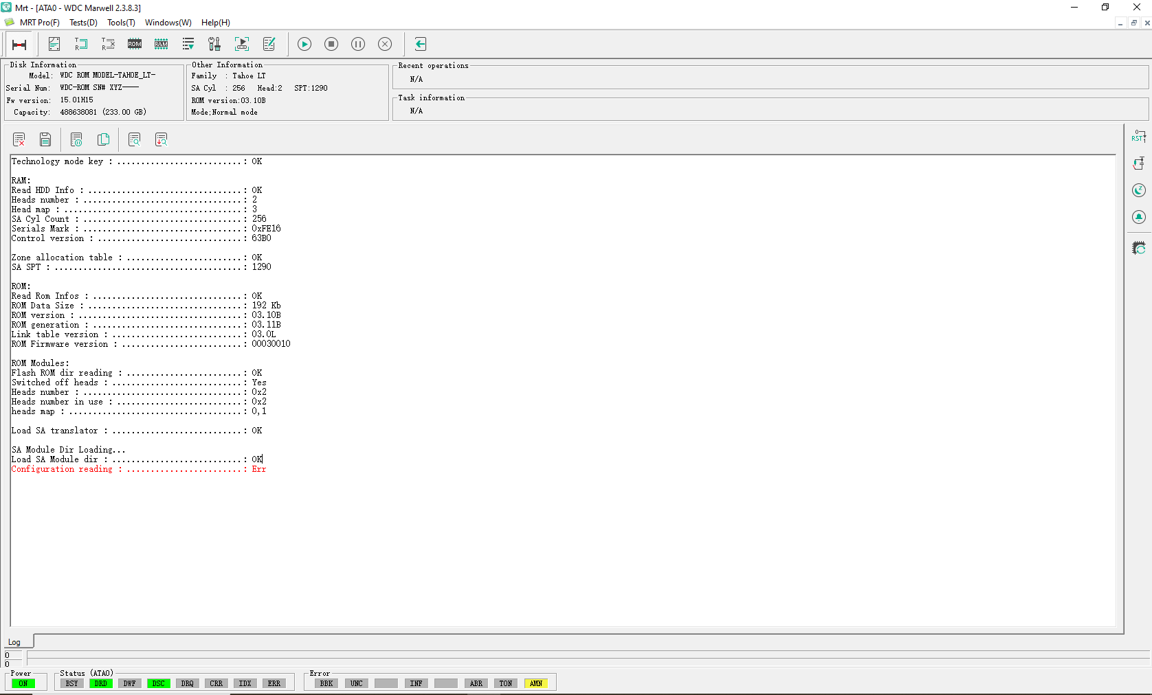

Model : WD5000AKS-08WWPAO
SATA 500 GB
PCB: 2060:771640-003 REV A
Technology mode key : ..........................: OK
RAM:
Read HDD Info : ................................: OK
Heads number : .................................: 2
Head map : .....................................: 3
SA Cyl Count : .................................: 256
Serials Mark : .................................: 0xFE16
Control version : ..............................: 63B0
Zone allocation table : ........................: OK
SA SPT : .......................................: 1290
ROM:
Read Rom Infos : ...............................: OK
ROM Data Size : ................................: 192 Kb
ROM version : ..................................: 03.10B
ROM generation : ...............................: 03.11B
Link table version : ...........................: 03.0L
ROM Firmware version : .........................: 00030010
ROM Modules:
Flash ROM dir reading : ........................: OK
Switched off heads : ...........................: Yes
Heads number : .................................: 0x2
Heads number in use : ..........................: 0x2
heads map : ....................................: 0,1
Load SA translator : ...........................: OK
SA Module Dir Loading...
Load SA Module dir : ...........................: OK
Configuration reading : ........................: Err (it takes time longer here and next it shows HDD Ready, till that time shows BSY)
See the attach Screen.
Thanks in advance for the help.

The drive is unable to read SA module 0x02.

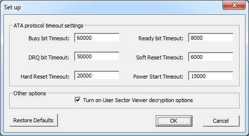

I'm using the card with only 2 ports (MRT Express), your MRT card is different version (MRT Ultra).
If you get same error also with other tools then the problem is with your drive. You can try with Sediv or WDMarvel demo version, it can help you to figure if you're dealing with hdd issue or with mrt bug. Sediv and WDMarvel demo permit to read and save SA.
If with Sediv or WDMarvel you don't see that problem then you should contact MRT staff.
Occasionally it worked for me increasing timings on "parameter settings" in the utility, then exit and open again wd utility.
