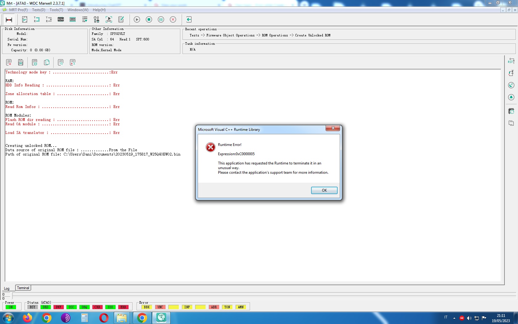

I have this 810035 WD 4TB Drive, Tried unlock it with my MRT , but it Always throws Runtime error and closes. Tried Multiple Attempts, No Success.
Can Anyone help me here , Unlock the given ROM below with permanent Unlock Patch.

 Post subject: Re: Need WD Unlocked Rom
PostPosted: May 14th, 2023, 3:05
Posts: 1318
Unlocks fine in pc3K - if that's any use to you.
ROM-unlock.zip [327.48 KiB]
Downloaded 492 times
:please:
The attachment ROM.7z is no longer available

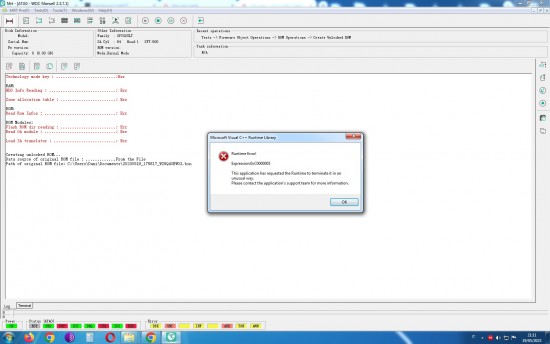

i've now the same your issue
https://forum.hddguru.com/viewtopic.php ... 36#p303936
What OS are you using?
I'm using Win7 Pro x64
i think some recent windows update made few changes on Visual C++ library that kills WD rom unlocking function in mrt.

It is Because MRT 2.1.7.1 doesn't Support Unlocking SPYGLASS Drives .
This Version Only Support Charger and Palmer .
You are Unlocking Spyglass in Older Unsupported Version .
