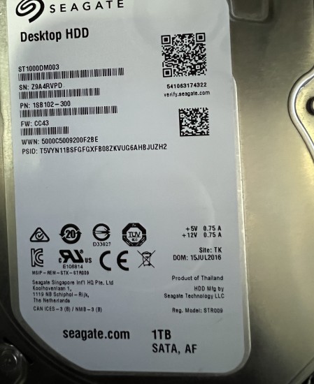

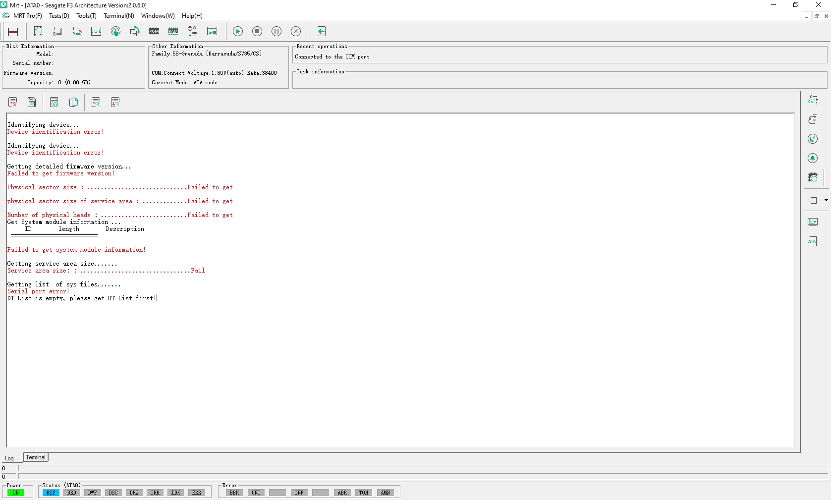

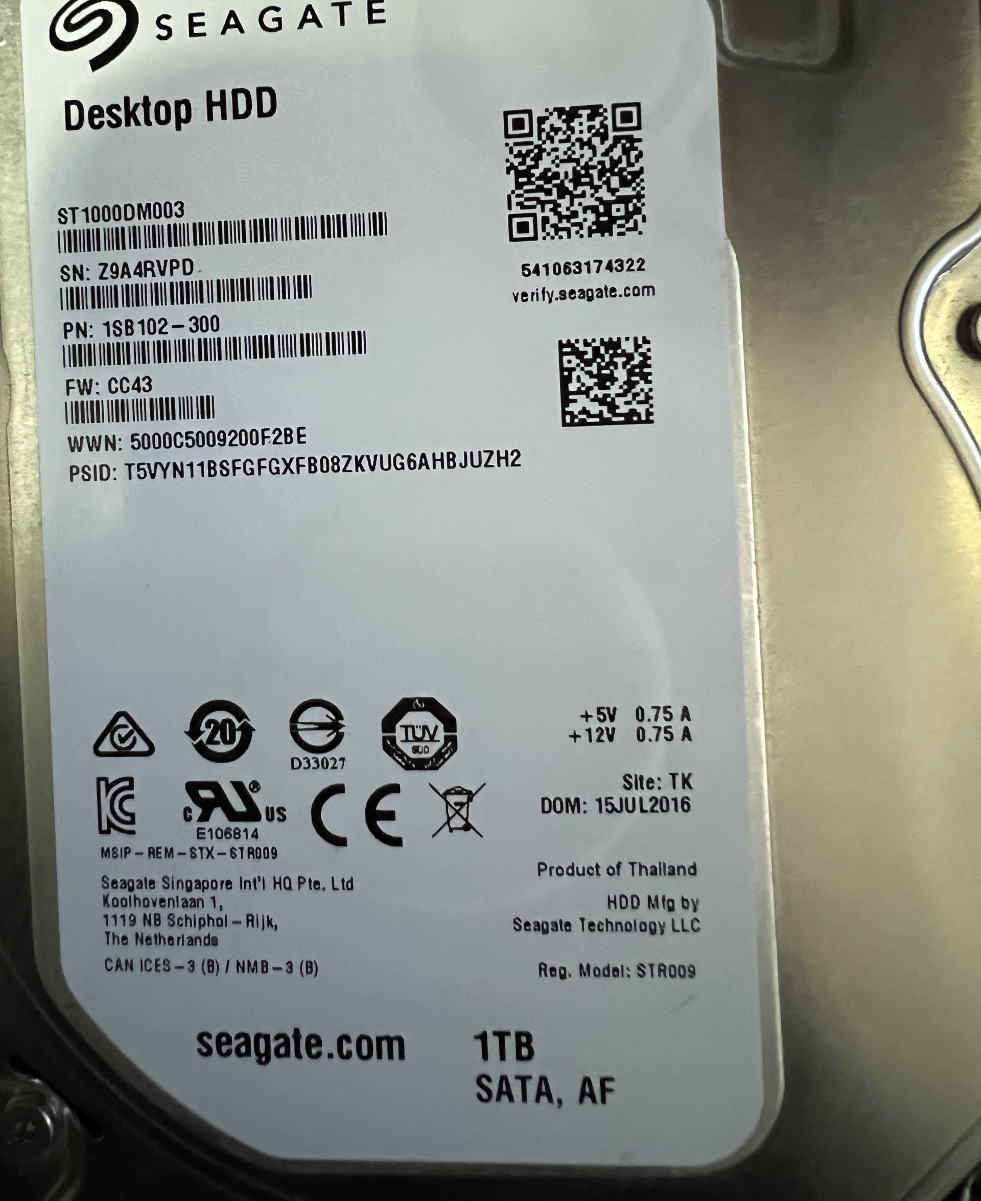

I have a seagate ST1000DM003 Grenada it spins. no clicking or scratching noises but it shows no disk information when connected to MRT and it's always busy. anyone knows how to deal with it.
Terminal Log:
Boot 0x40M
SpinUp
Trans
Rst 0x40M Thermistor Temp 001E
PreampFaultStatus = 00C0
SIM Error 1002 LBA 0000000000045D8C FD FCFFF3FF
RW Error 44440080
2Sync:01 0E
2Sync:01 0E
2Sync:01 0E
(P) SATA Reset
SIM Error 1002 LBA 000000000003E179 FD FC38B30A
RW Error 44440080
SimErrorCode = 00001002, RWErrorCode = 44440080
The Registry is corrupt.
LED:0x000000BD FAddr:0x00006454

Head wear weak, problem solved after head swap.
