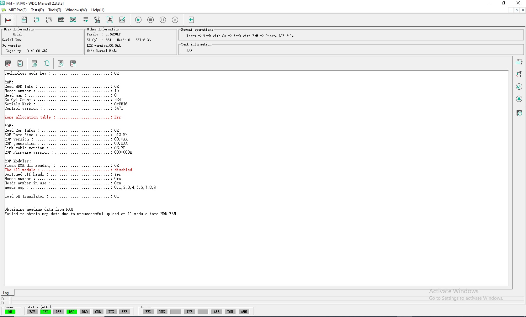

WD40NDZW always busy, tried to unlock the firmware and it came out of busy mode but no disk information. any suggestions?

Problem solved by swapping heads and loading LDR.
If anyone had a problem after unlocking firmware still can't read ROM and RAM and came up with error then you need to go to MRT main screen then Tools >> Standby/Reset/Speed >> Transmission and reset for SATA Controller then Change SATA 3 to SATA 2 and it will fix the problem.
