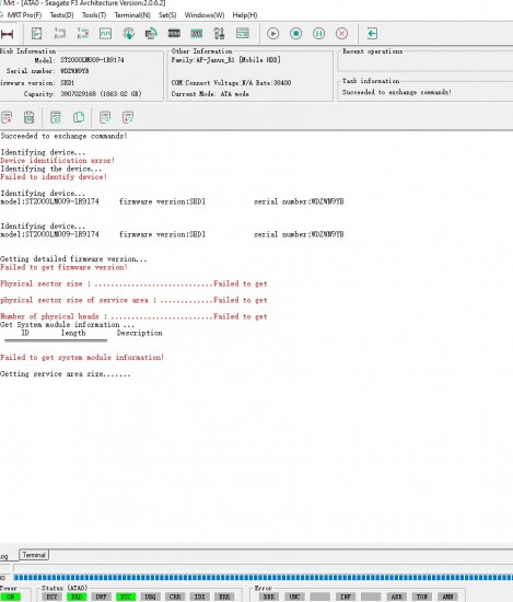

I got ST2000LM009-1R9174, Hdd is ready with error on terminal :
QB
Rst 0x80M
T:0x0002 0x002244C7
FTU
TCC:001D:002A EMCDataErr:00000011
SIM FileFD=FC38314E ErrorCode=43160080 DiscLBA=000000000000B447 Duration=0000049A ms
SIM FileFD=FC39B1D2 ErrorCode=43160080 DiscLBA=00000000000091DD Duration=0000049F ms
SIM FileFD=FC3981D1 ErrorCode=43160080 DiscLBA=000000000000920F Duration=0000049A ms
DSC PASS
PrgF
SIM FileFD=FC366301 ErrorCode=43160080 DiscLBA=000000000000B43C Duration=0000049A ms
SIM FileFD=FC379132 ErrorCode=43160080 DiscLBA=000000000000A04E Duration=0000049A ms
SIM FileFD=FC379132 ErrorCode=43160080 DiscLBA=000000000000A0A8 Duration=000004A0 ms
PrgF
SIM FileFD=FC3B4071 ErrorCode=43160080 DiscLBA=0000000000005EA5 Duration=0000049D ms
SIM FileFD=FC376115 ErrorCode=43160080 DiscLBA=000000000000B438 Duration=0000049F ms
(P) SATA Reset
RAW OFF
SIM FileFD=FC3A217A ErrorCode=43160080 DiscLBA=000000000000BBB3 Duration=0000049F ms
SIM FileFD=FC3B217B ErrorCode=43160080 DiscLBA=000000000000BBD4 Duration=0000049A ms PASS
SIM FileFD=FC37D134 ErrorCode=43160080 DiscLBA=000000000000BBD6 Duration=0000049A ms
SIM FileFD=FC3B3348 ErrorCode=43160080 DiscLBA=0000000000006498 Duration=0000049D ms
SIM FileFD=FC3A6068 ErrorCode=43160080 DiscLBA=000000000000C35C Duration=0000049B ms
SIM FileFD=FC3A5069 ErrorCode=43160080 DiscLBA=000000000000C34C Duration=000004A0 ms
SIM FileFD=FC39013A ErrorCode=43160080 DiscLBA=000000000000BBB9 Duration=0000049A ms
SIM FileFD=FC37E135 ErrorCode=43160080 DiscLBA=000000000000BBB5 Duration=0000049A ms
SIM FileFD=FC3B51EB ErrorCode=43160080 DiscLBA=000000000000C755 Duration=0000049F ms
SIM FileFD=FC30121E ErrorCode=43160080 DiscLBA=0000000000036800 Duration=0000049A ms
SIM FileFD=FC3B7181 ErrorCode=43160080 DiscLBA=000000000000CE58 Duration=0000049F ms
[MCMT] Primary is corruptted
SIM FileFD=FC3B3348 ErrorCode=43160080 DiscLBA=0000000000007383 Duration=0000049A ms
1st MCMT sim err
1st MCMT verify fail
WriteMCMTPrimary: EXCEPTION: MCTP Write Fail
Starting LBA of RW Request=001B73F1F7 Length=000009DE
ProcessRWError -Read- at LBA 001B73F543 Sense Code=43160080
AttemptErrorRecovery-0
ERC TO exceeded, orig value in us:FFFFFFFF
PrgF LPCDisc=00 1B73F543 012C
MS Read Fails: DB9F8FB8,00004EF0
PrgF
6Gb Max Speed lowered to 3Gb for Intel bug
Send Status: COMRESET seen
CSpd= 1.5Gbps
FIS34
SIM FileFD=FC38314E ErrorCode=43160080 DiscLBA=000000000000B447 Duration=0000048F ms
Starting LBA of RW Request=001B73FD7A Length=000009DE
ProcessRWError -Read- at LBA 001B73FD81 Sense Code=43160080
ITA 0: 1.000
ITA 1: 1.000
ITA 2: 1.000
Hd 0 Err Blk 1B73FD81 BER pre -1.000000
Power C8 Duration 64 attempt 0
ITA 0: 1.000
ITA 1: 1.000
ITA 2: 1.000
BER after -1.000000
I never face this problem before. Hdd is able to unlock. No clicking, spindle spin up as normal.
What is the problem? Your help is appreciated.

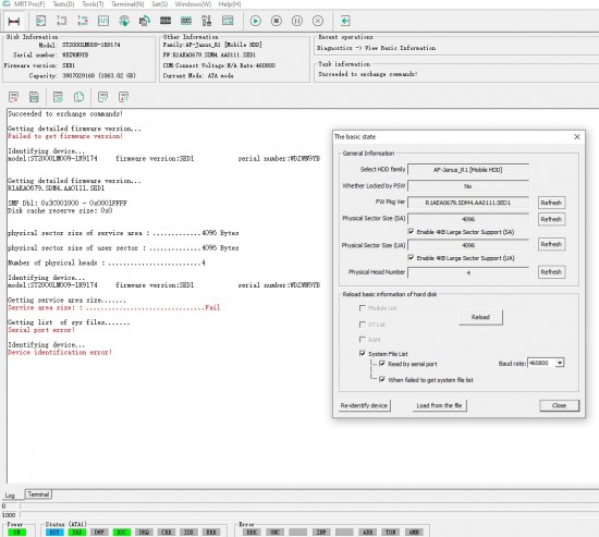

 Post subject: Re: ST2000LM009-1R9174 , SIM FileFD=FC38314E ErrorCode=43160
PostPosted: August 12th, 2023, 3:57
Joined: January 20th, 2021, 0:27
Posts: 109
Location: Indonesia

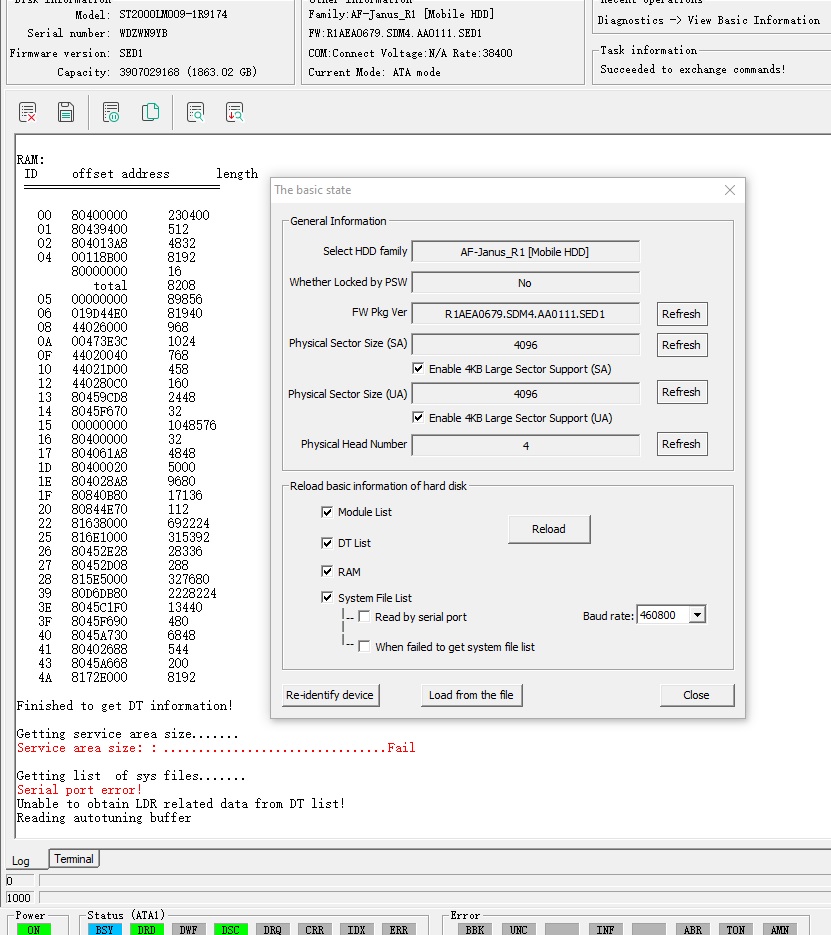

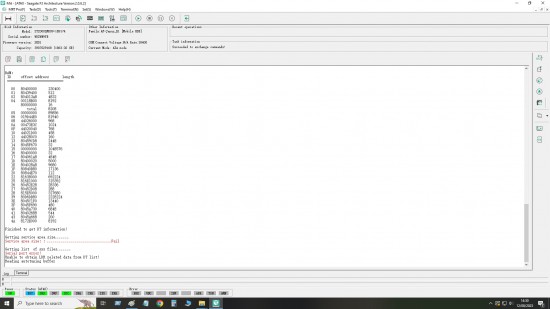

Unlocked is succeed.
But during initialize having error:
Service area size:Fail (find the attachment)
Also no access to user area.
Anybody have this problem before?

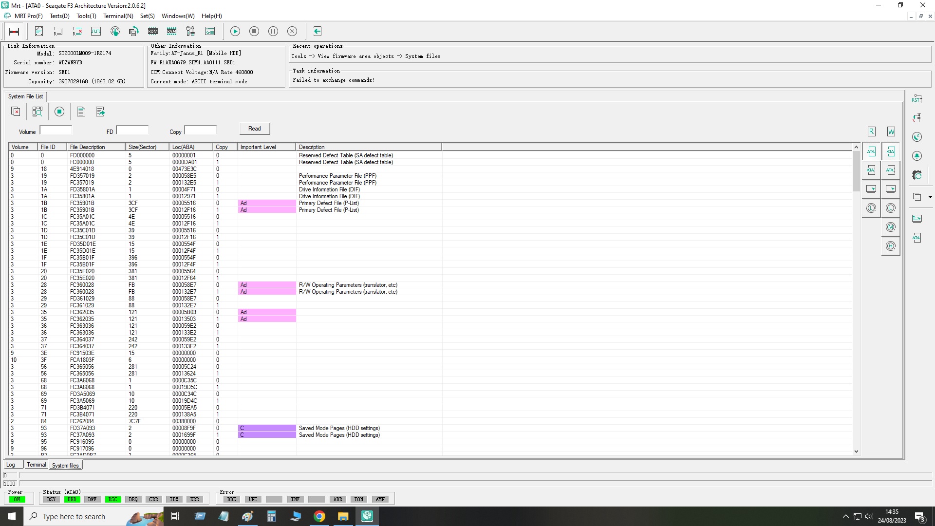

PostPosted: August 12th, 2023, 18:43
Posts: 1768
Location: Verona, Italy
That is mrt bug that i had identified some time ago, but which the mrt staff never considered because i was not believed.
Issue is that utility is not able to access correctly to SYS files after rom unlock.
There is a trick...

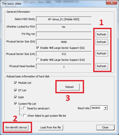

1) Once you see the serial port error as you've posted, start "F3 SYS file backup"(you will get a lot of errors so sys will not be backed-up).
2) Wait few seconds (about 4/5 seconds) that log scrolls with all those sys files error as red scripts (don't need to wait it finish), now stop sys backup manually.
3) Press on all "Refresh" buttons.
4) Press "Re-Identify device".
5) Press "Reload".
Now it will access SA correctly and you'll be able to backup SYS and modules.

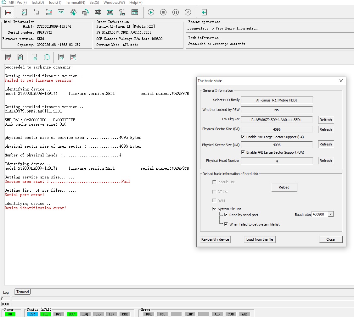

PostPosted: August 22nd, 2023, 6:22
Posts: 109
Location: Indonesia

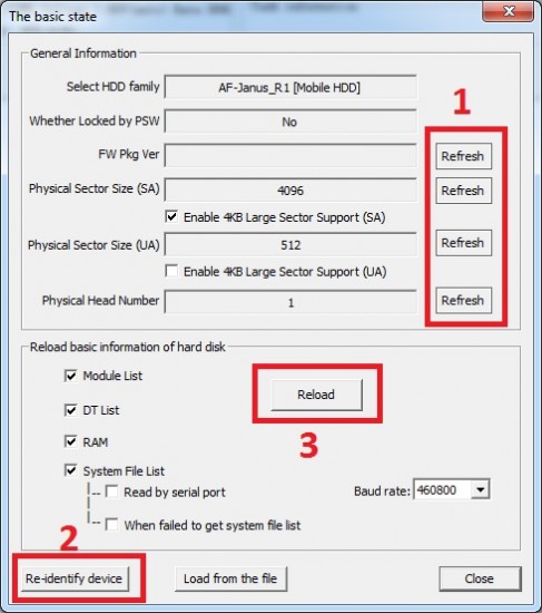

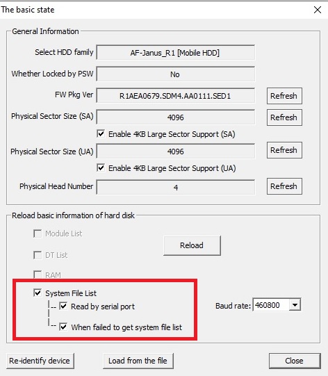

Hi michael chiklis,
I following your suggestion, all is works till I press RELOAD... hdd become BUSY.
In this point Re-ID or RELOAD will gave error and terminal also become no access.
NORMAL mode, terminal mode same error.
Any step that I miss ?
PostPosted: August 22nd, 2023, 13:30
Posts: 1768
Untick last 2 options:
"Read by serial port"
"When failed to get system file list"
if this doesn't help, you should use "busy patch" when uploading 3D loader
My firmware database:

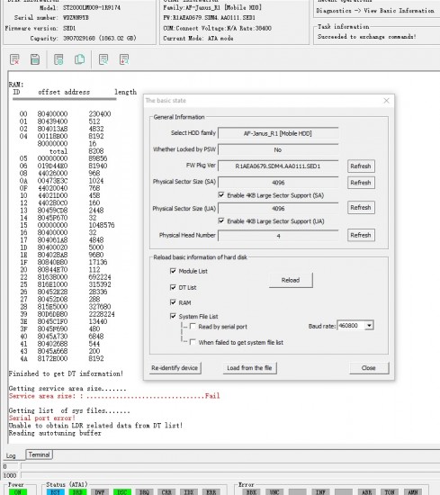

Hi michael chiklis
Everything's is smooth till this point :
Getting service area size.......
Service area size: : ................................Fail
Hdd become busy, last chance I will run virtual boot, but ST2000LM009-1R9174, f/w SED1 , I don't have 3D mod. Looking for entire Google nobody have it.
If anybody have it I am appreciated for share.

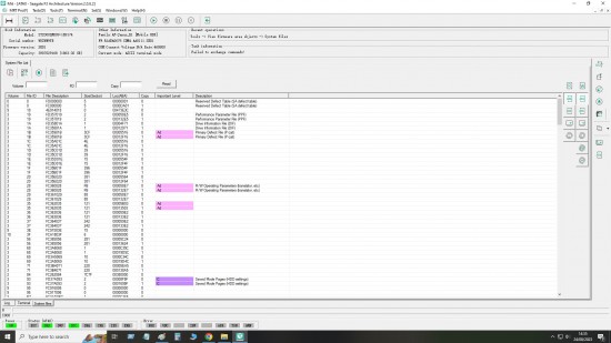

PostPosted: August 23rd, 2023, 11:58
Posts: 1768
if you can access to sys files in serial mode, you will get 3D mod from this:
FC01020D
FC01120E
try by ticking one of the two option on bottom or both
3D loader sys file always ends with 20D or 20E
if you can't get them, ask in the forum for virtual ldr file of this drive.

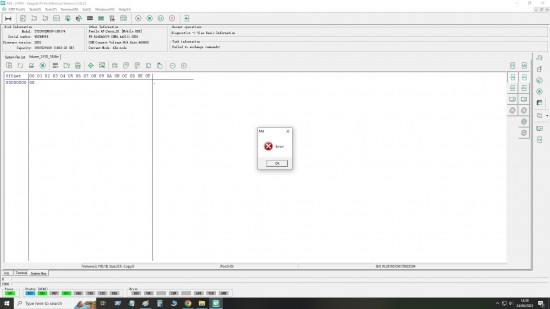

PostPosted: August 24th, 2023, 3:54
Posts: 109
Location: Indonesia

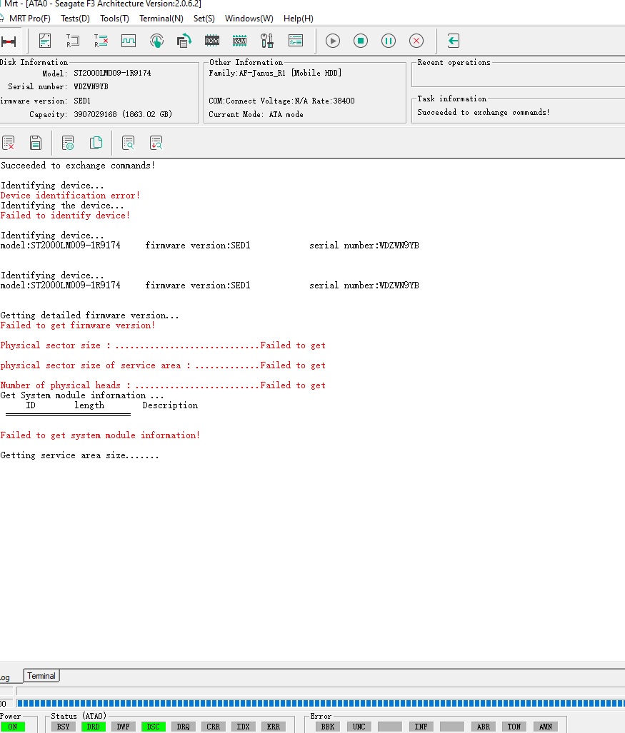

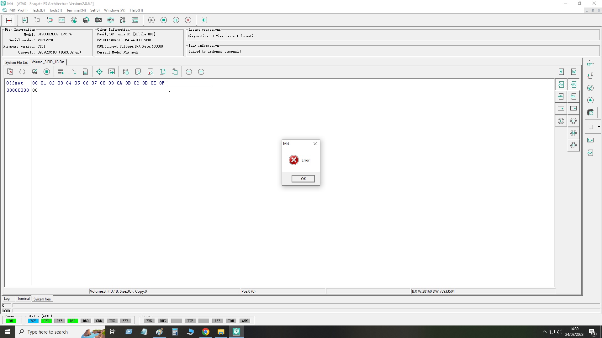

Hi michael chiklis,
Finally can go to system file list, used 3D loader from donor.
But no any sys module file can be opened, it is error. Read by ATA, ABA or terminal port is same error and BSY.
Any time , any function on MRT selected, SIM error on terminal will occurred.
This SIM error repeat and only can be terminate by select Terminal Mode button
I need to save 1B, 28, and 35 before clear G-List and format/recalculate translator.
Any other way?

Sorry, if all this didn't work for you then i don't know how to help you.
Try to press first "reload" and then "Re-identify device".
Also, problem it could be that your 3D ldr donor version doesn't match with patient rom date version.
Last year i made a video on youtube about BSY error after 3D loader on a Rosewood ST2000LM007 and how to solve it by using proper donor 3D ldr with matched date.
https://youtu.be/P2Fcr71LUqs?si=_xubWEYtUB6oIs1Y
if this doesn't help you, ask help to MRT staff on skype
