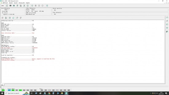

I got WD10SPZX-75Z10T2, 1Tb. Busy, ready, spin down, this kind of problem usually head issue.
But after head replacement from good working donor ( follow all those donor criteria), problem is remain. Lock or unlock, problem remain same :
- Spindle up then down
- No access to SA
Any body knows, what is the problem?

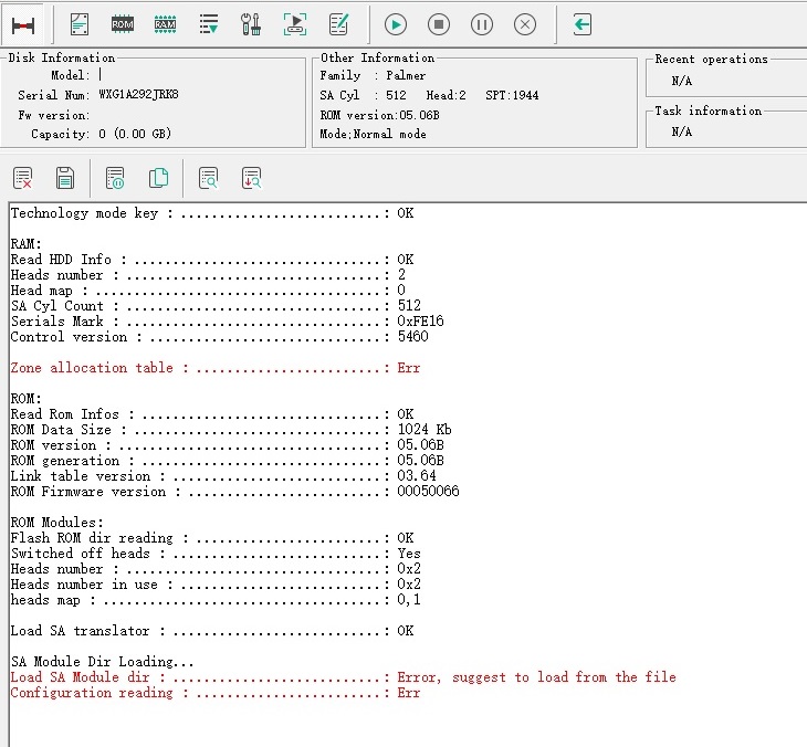

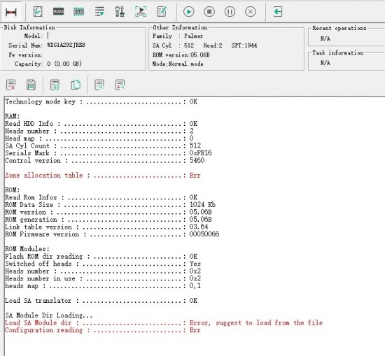

In Kernel mode ; disable mod 411.
Repower, spin down occurred. unable to carry on.
 Post subject: Re: WD10SPZX-75Z10T2, 1Tb. Busy, ready, spin down, no SA.
PostPosted: August 9th, 2023, 5:09
Joined: January 20th, 2021, 0:27
Posts: 109
Location: Indonesia
411 disable, keep spin down

really don't know then, sorry.
Maybe original heads got bad?
Does something change if disable mod 183 ?
