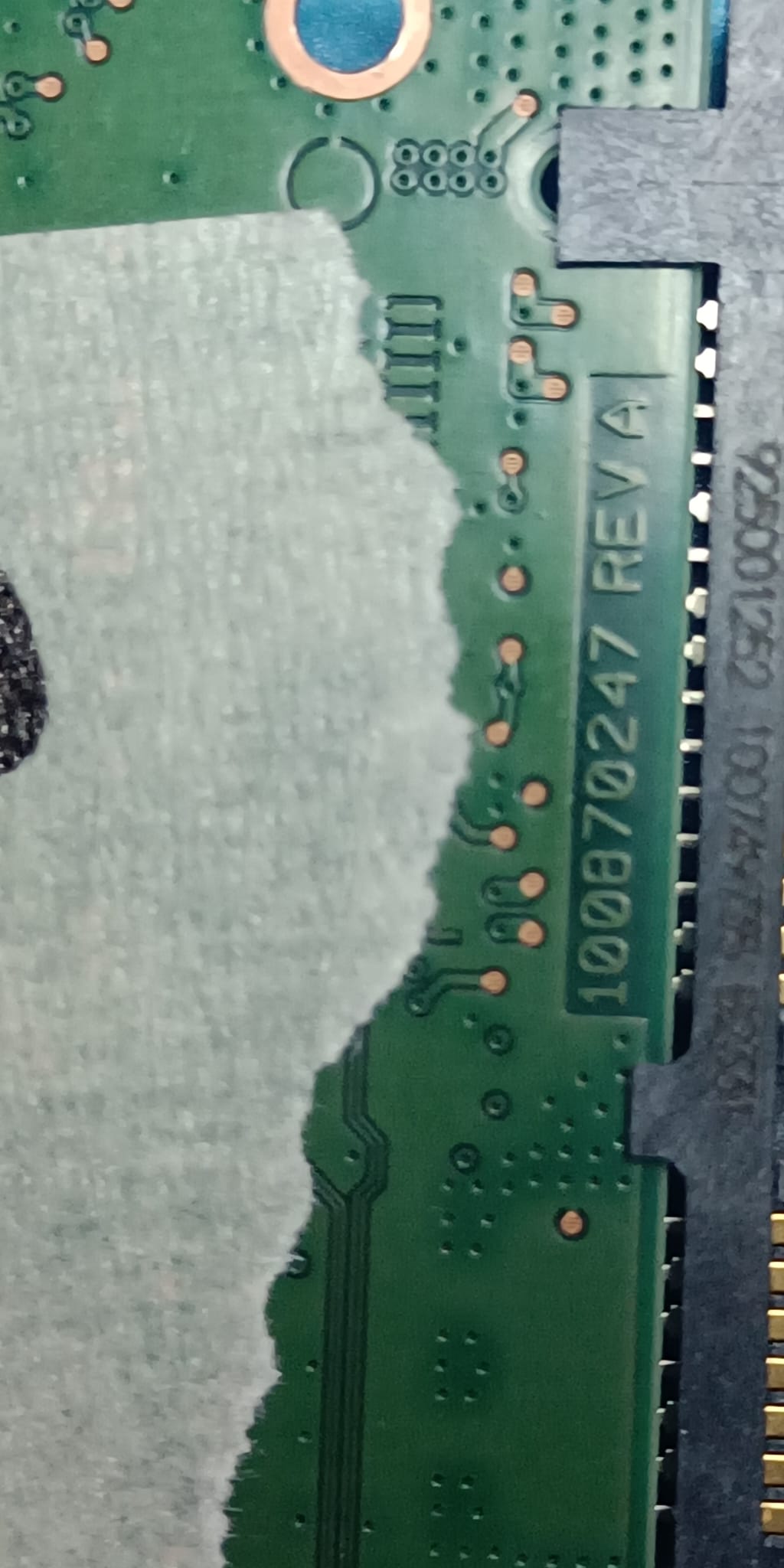

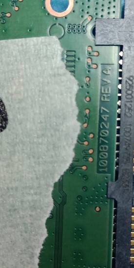

Hi, I have a Seagate ST6000DM003 with PCB 100870247, the PCB is faulty and the disk doesn't start.

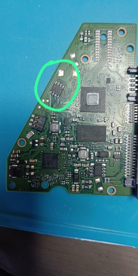

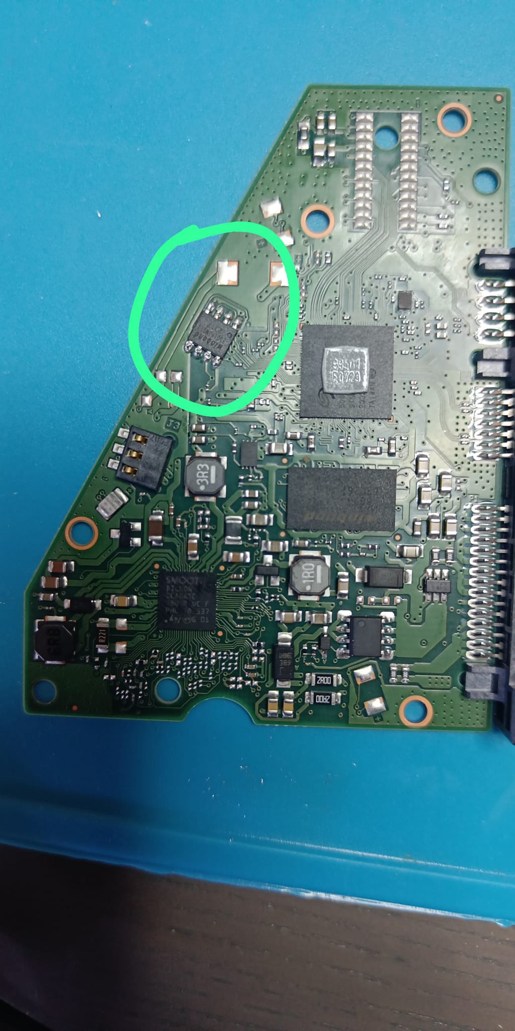

After various tests I came to the conclusion that Roma is corrupt. Do you know if there is a way to rebuild it?
I attach the file saved after desoldering it.

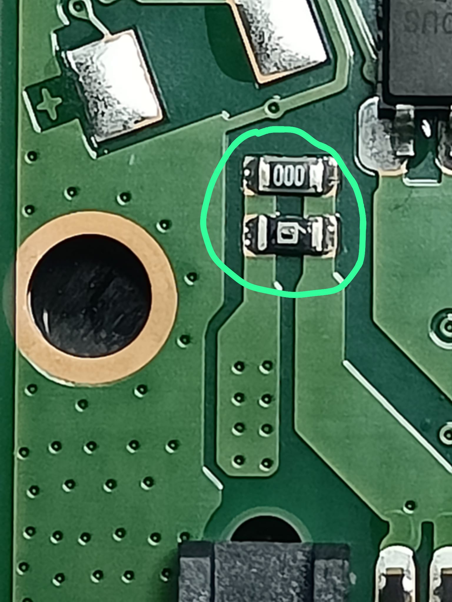

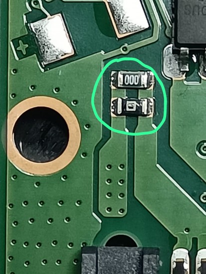

The disk would not turn on, I found some faulty components, which I replaced without success.
I attach the photos to you
If you have the opportunity to try to rebuild the rom, then I write it with the programmer.
File comment: bad components
