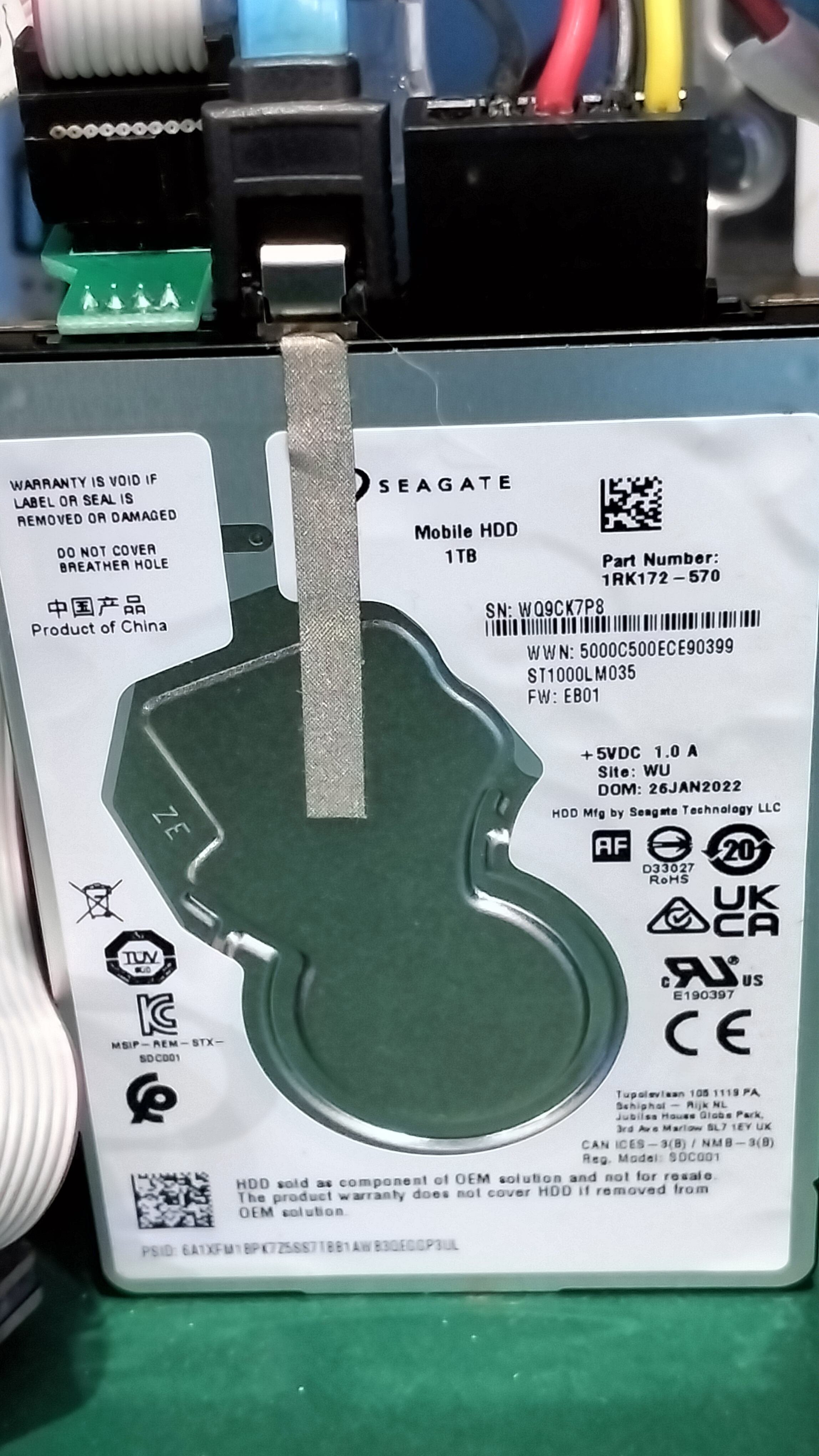

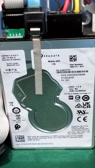

Here is HDD label in attachment

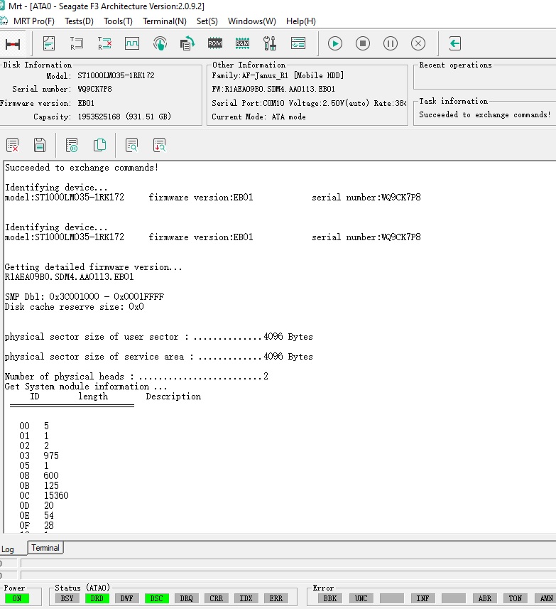

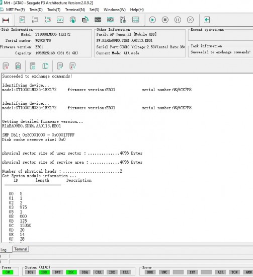

Format and recalculate translator ( m0,6,2,,,,,22 ) , not Rebuild.
