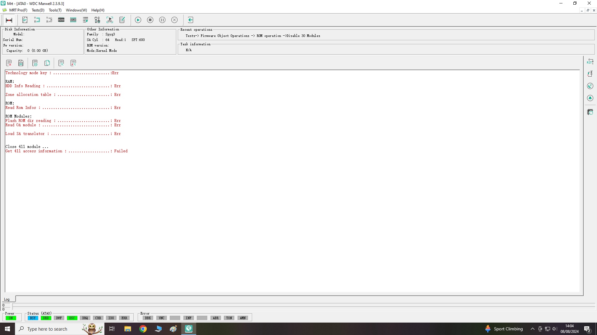

digisupport ; I am still looking for donor.
Amarbir[CDR-Labs], as I told that drive spinning and spin down, so I unable to block 411.

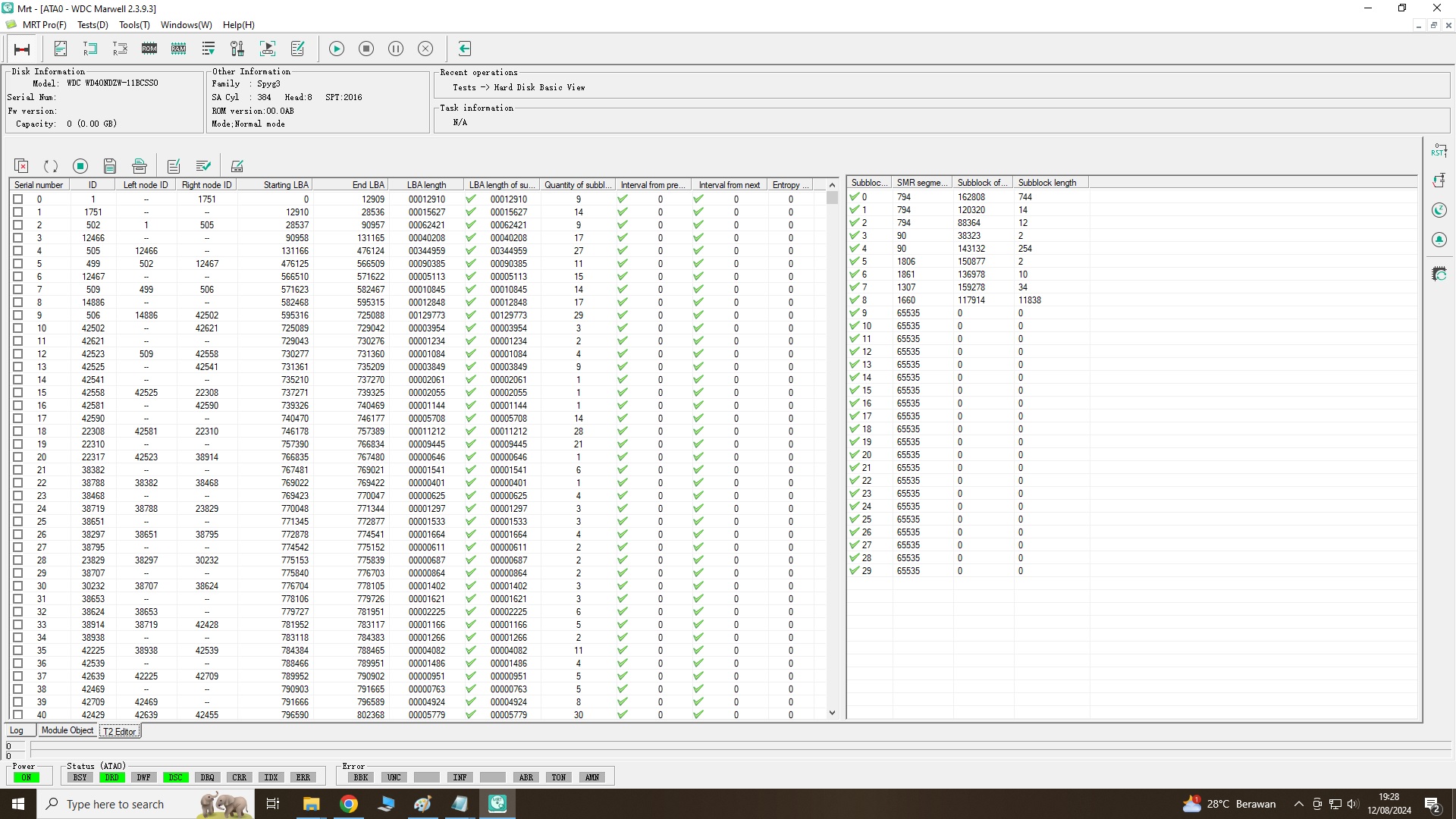

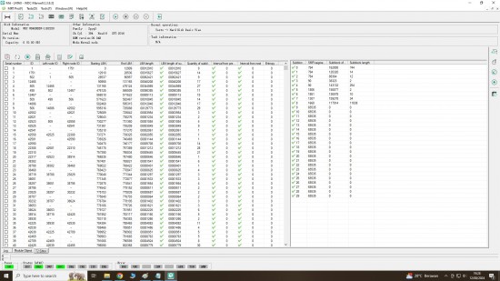

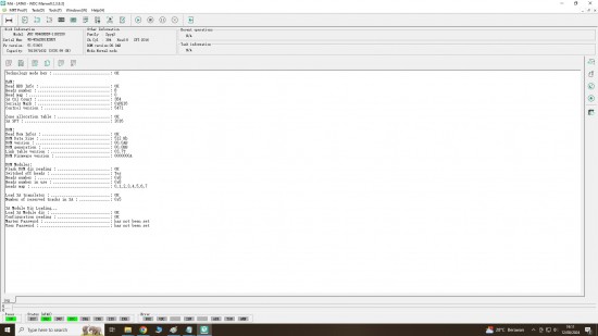

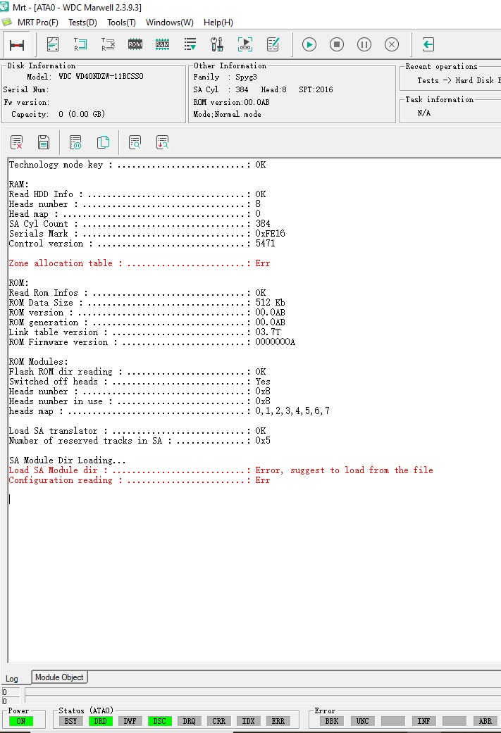

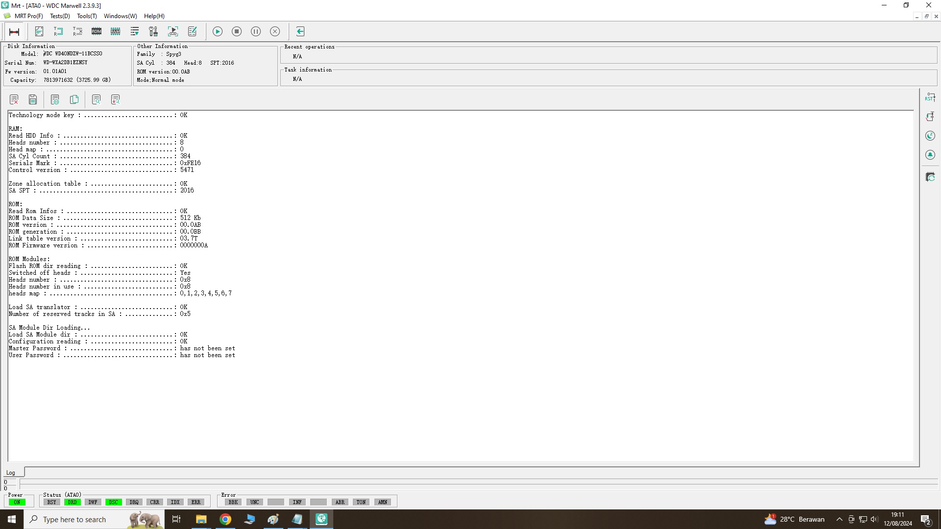

Applied Equalizer 810035 ;
Disable 411
Load mod 01 from donor file into RAM
This time SA can be saved(just lucky?).
A little confusing, occasionally access to SA and load SA dir smootly.
But sometimes error to load SA dir and SA.
T2 is no issue as pics?
I guest heads really having problem and need to replace.
