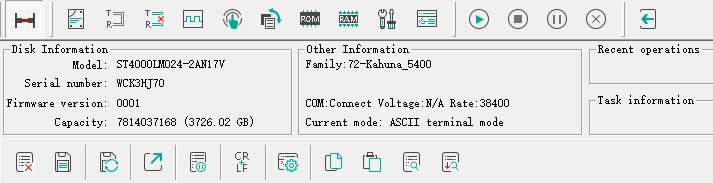

I got ST4000LM024-2AN17V Seagate 4Tb F/W 0001, problem is HDD ready with spin down.
ROM unlock succeeded in boot code mode, but no access into terminal as drive already spin down
Any idea how to do with MRT?

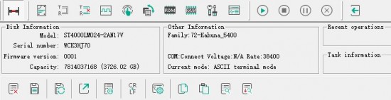

On terminal have messages :

You're going to need a new set of heads on that.

Hi Lardman,
Just edit and made Max Heads 0 in the ROM, and write the ROM, having below on terminal while head no more spin down.
Yes, I am also consider for replace the heads, I am still looking for the correct donor.
Boot 0x80MMD00440001
RECOV Servo Op=0100 Resp=0005
SpinUp
TCC:001F
RECOV Servo Op=0195 Resp=0005[LBA=0x00017DC3]N02020C20o0o0o0o0o0o0o0o0[LBA=0x00017DC3]NO1111102020C20o0o0o0o0o0o0o0o01111102020C20o0o0o0o0o0o0o0o01111102010C20o0o0o0o0o0o0o0o01111102020C20o0o0o0o0o0o0o0o01111102020C20o0o0o0o0o0o0o0o01111101020C20o0o0o0o0o0o0o0o01111102020C20o0o0o0o0o0o0o0o01
SIM FileFD=FC000000 ErrorCode=43160080 DiscLBA=0000000000017DC3 Duration=000006BA ms

you are likely going to kill SA on H0 and some of the disabled surfaces doing this...
