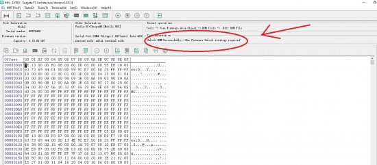

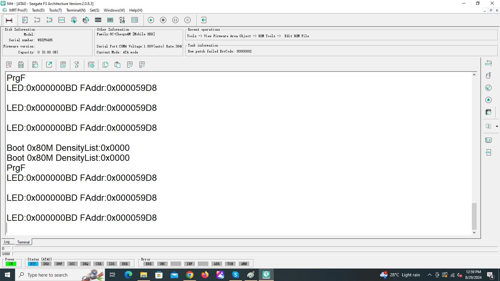

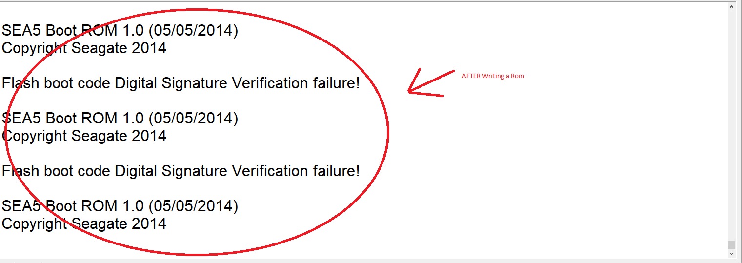

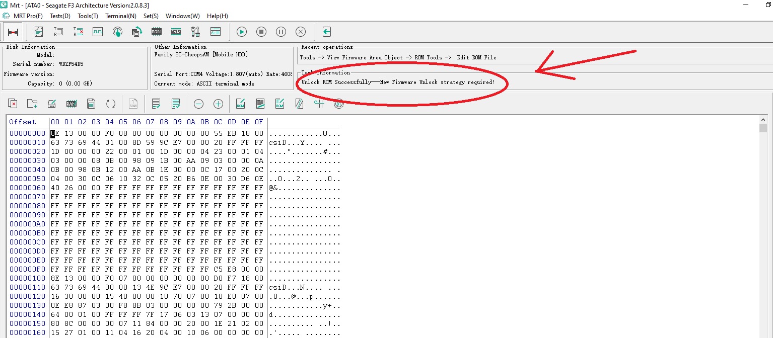

 Post subject: can possible to solve this problem VIA MRT
PostPosted: August 29th, 2024, 4:38
Joined: May 6th, 2013, 2:48
Posts: 84

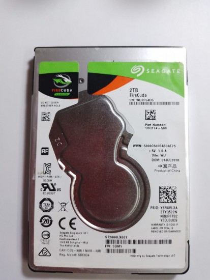

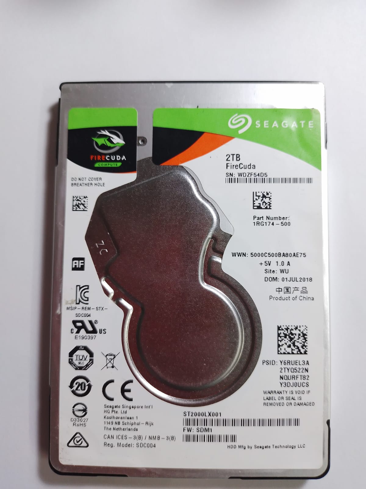

Hi, Friends!
2 TB
Fire Cuda
ST2000LX001
FW; SDM1

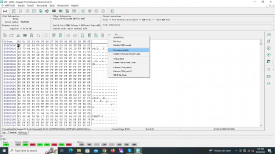

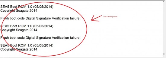

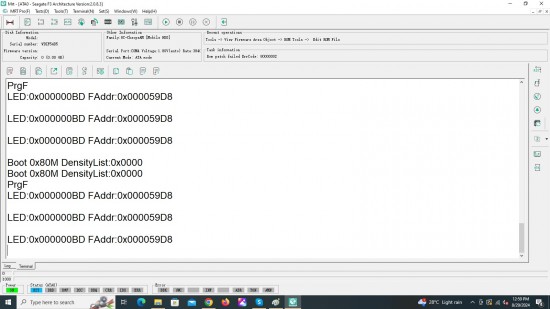

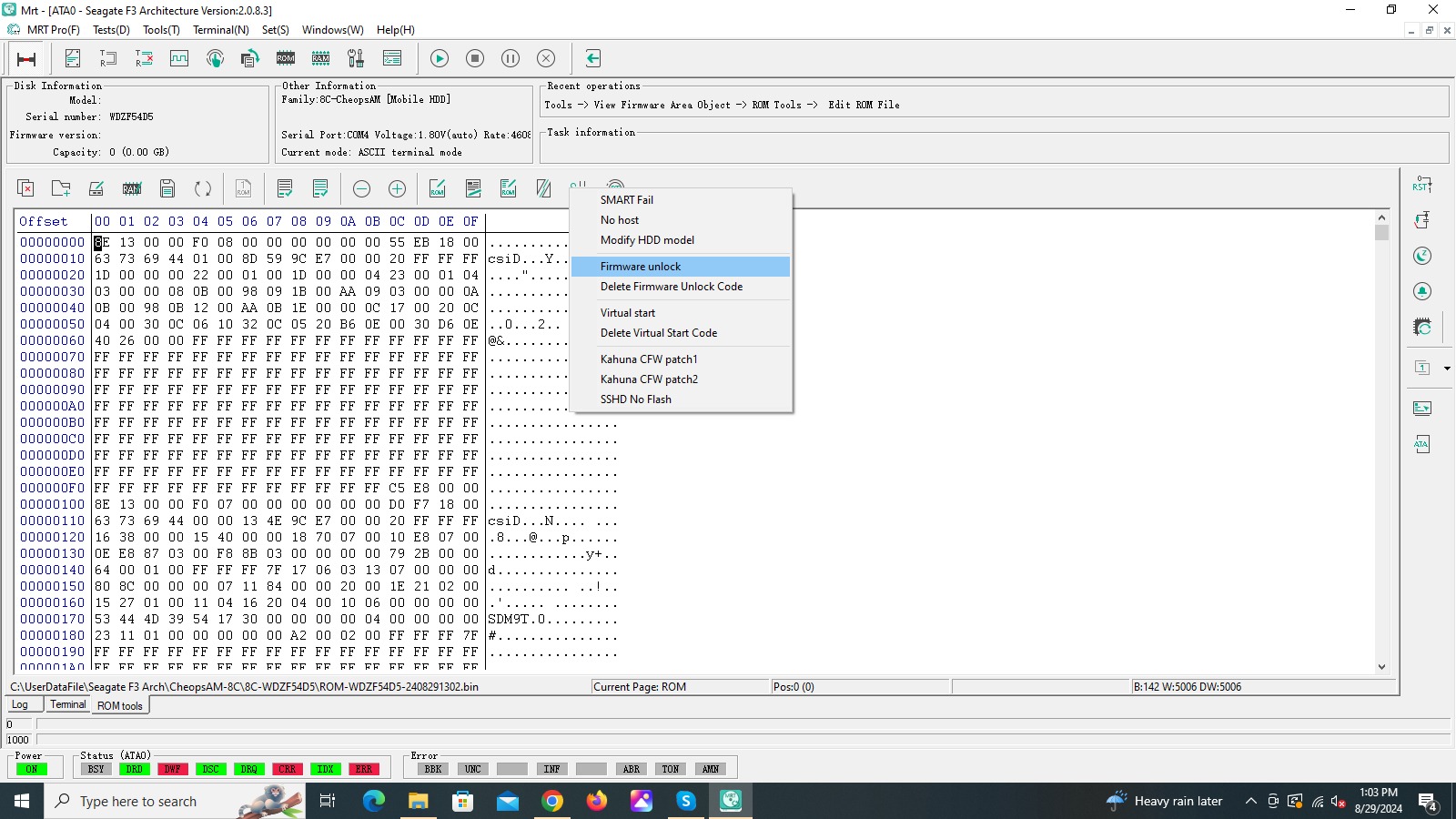

PCB is locked
If you changed the PCB, you must take the CPU with it
some blockage on these newer pcb
try use the PCB original and ROM original
Exactly.
