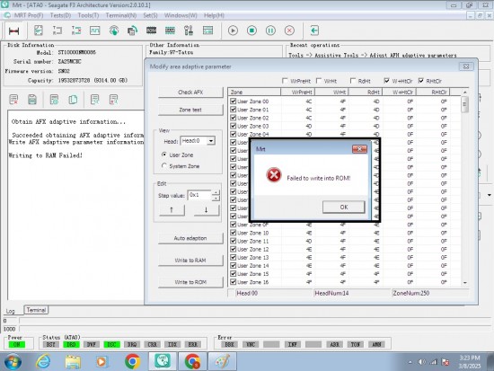

 Post subject: HOW TO WRITE AFX 10TB SEAGTAE
PostPosted: March 6th, 2025, 13:32
Posts: 153
Location: Karachi

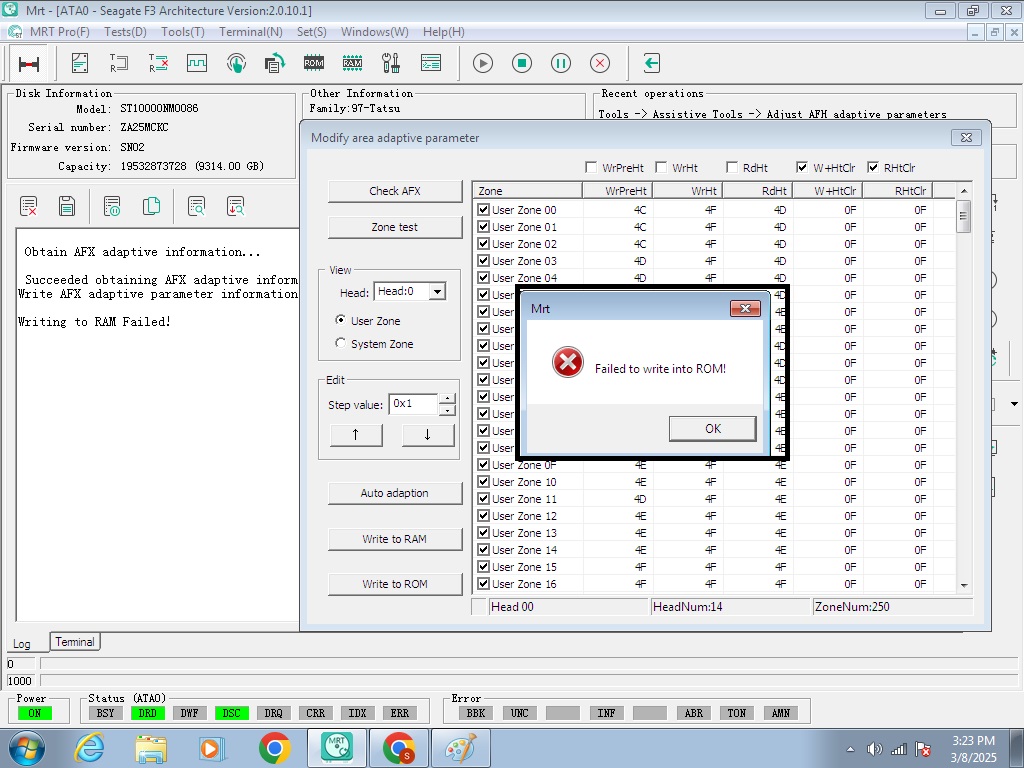

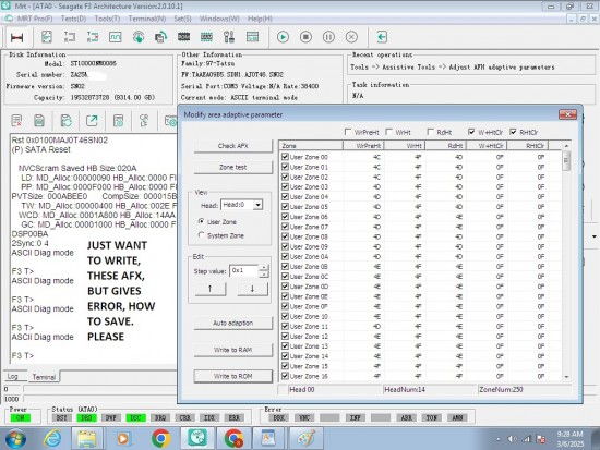

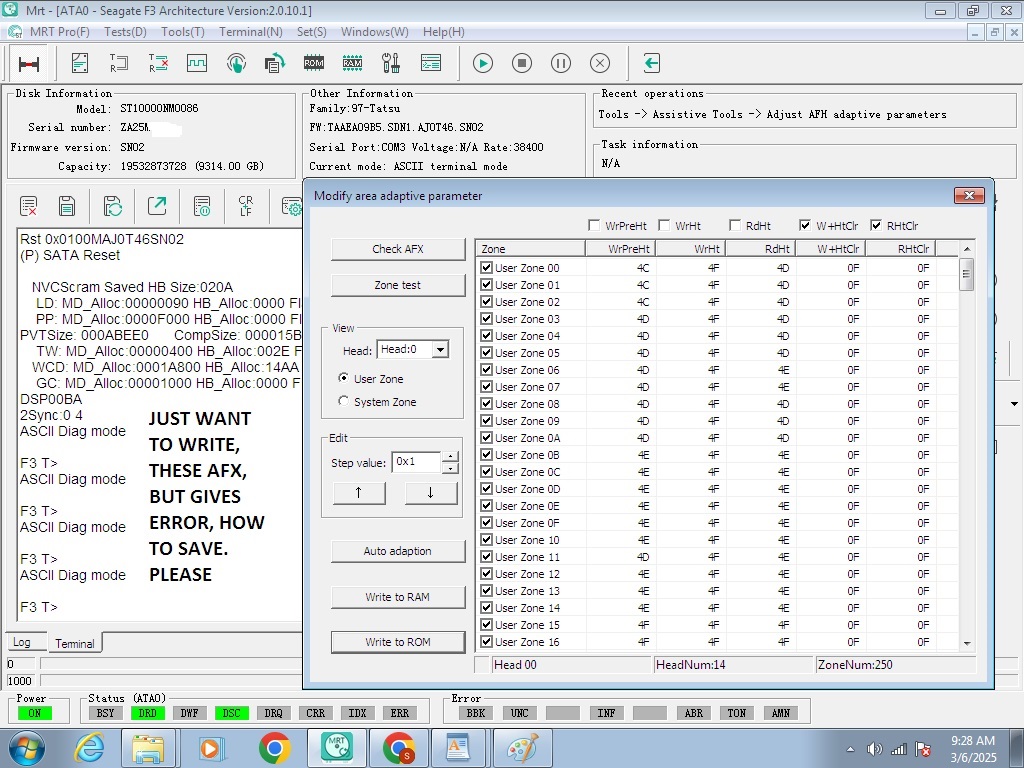

just want to write AFX
but gives error, not saving,
ANY HELP,. please
 Post subject: Re: HOW TO WRITE AFX 10TB SEAGTAE
PostPosted: March 7th, 2025, 10:44
Posts: 153
Location: Karachi
Write to ROM gives error

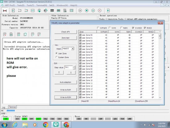

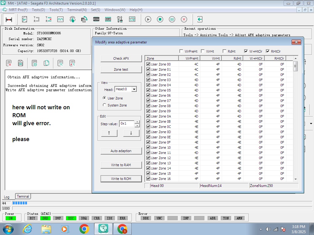

really i need help

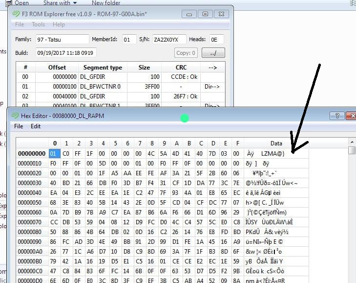

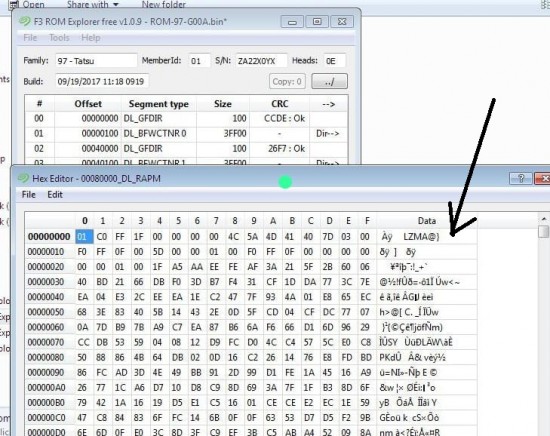

i think in that ROM RAP is compressed with LZMA. So that may be the issue.
You can decompress with F3Explorer. but can't compress back after modification.
but if u have F3Explorer paid version u can do it after modification manually

please any advice now,
how to decrypt this
PostPosted: March 31st, 2025, 19:39
Posts: 17311
r-click then open segment then d-click
