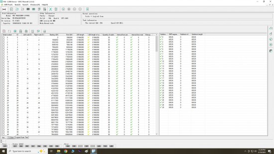

Hi Everyone...
WDC WD20SDRW-11VUUS1, Charger 2Tb, any suggestion for
solve YELLOW tick on T2? Only last LBA is green.
Unlock succeed, SA read and saved ABA/track OK.
User area viewer shows noting, zero. No access to user area on DE.
Access using WD USB mode.
Thank you

T2 is empty, probably formatted, trimmed ...

Hi Pepe,
This HDD no any action taken yet unless ROM unlock to get SA. It happen since PC power failure during normal operation.
It is possible to get data back?

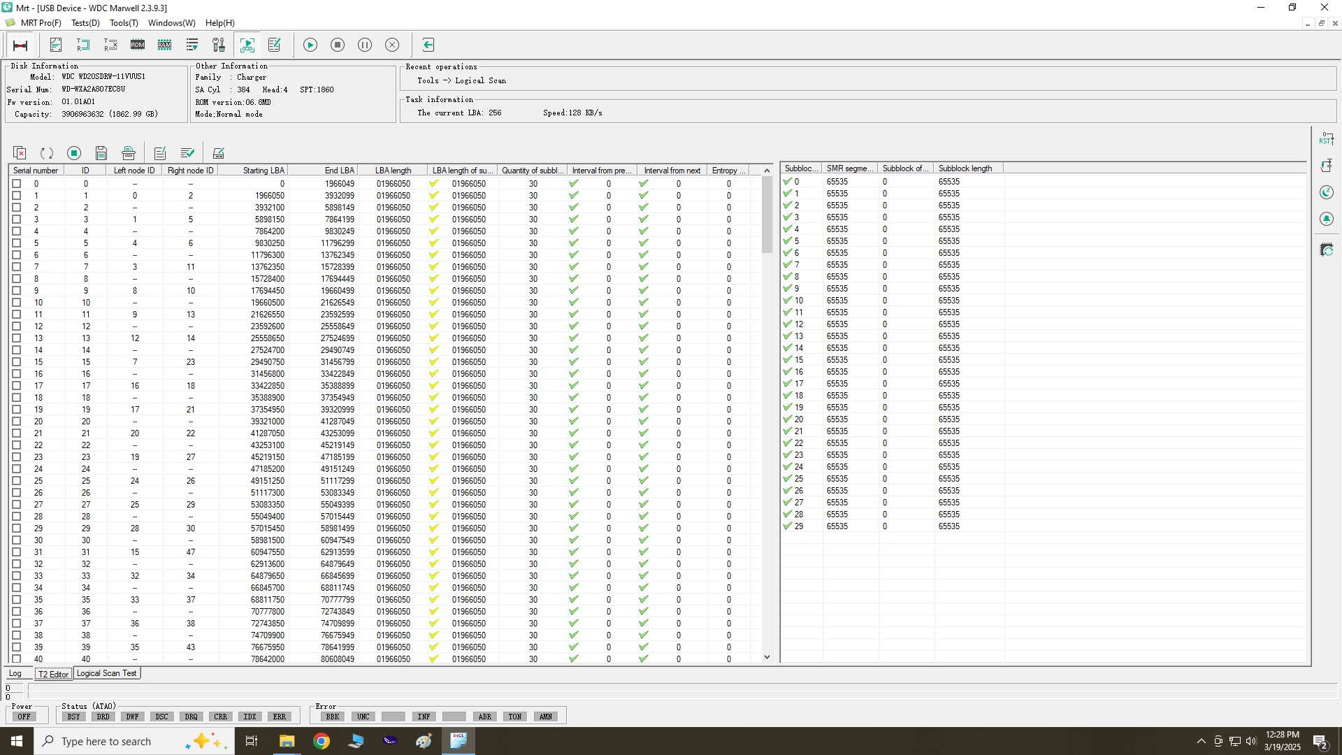

It [SOLVED],
Even though not 100% data recovered, in my case, I learn a lot from below MRT video link.
MRT WD 2.1.9.x T2 Editor with Formatting: System Explanation A
https://www.youtube.com/watch?v=3vHSXUTCvzA
MRT WD 2.1.9.x T2 Editor with Formatting Case Study B
https://www.youtube.com/watch?v=Bf-nbrkzvqw
