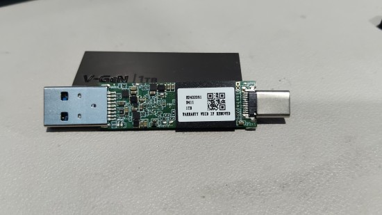

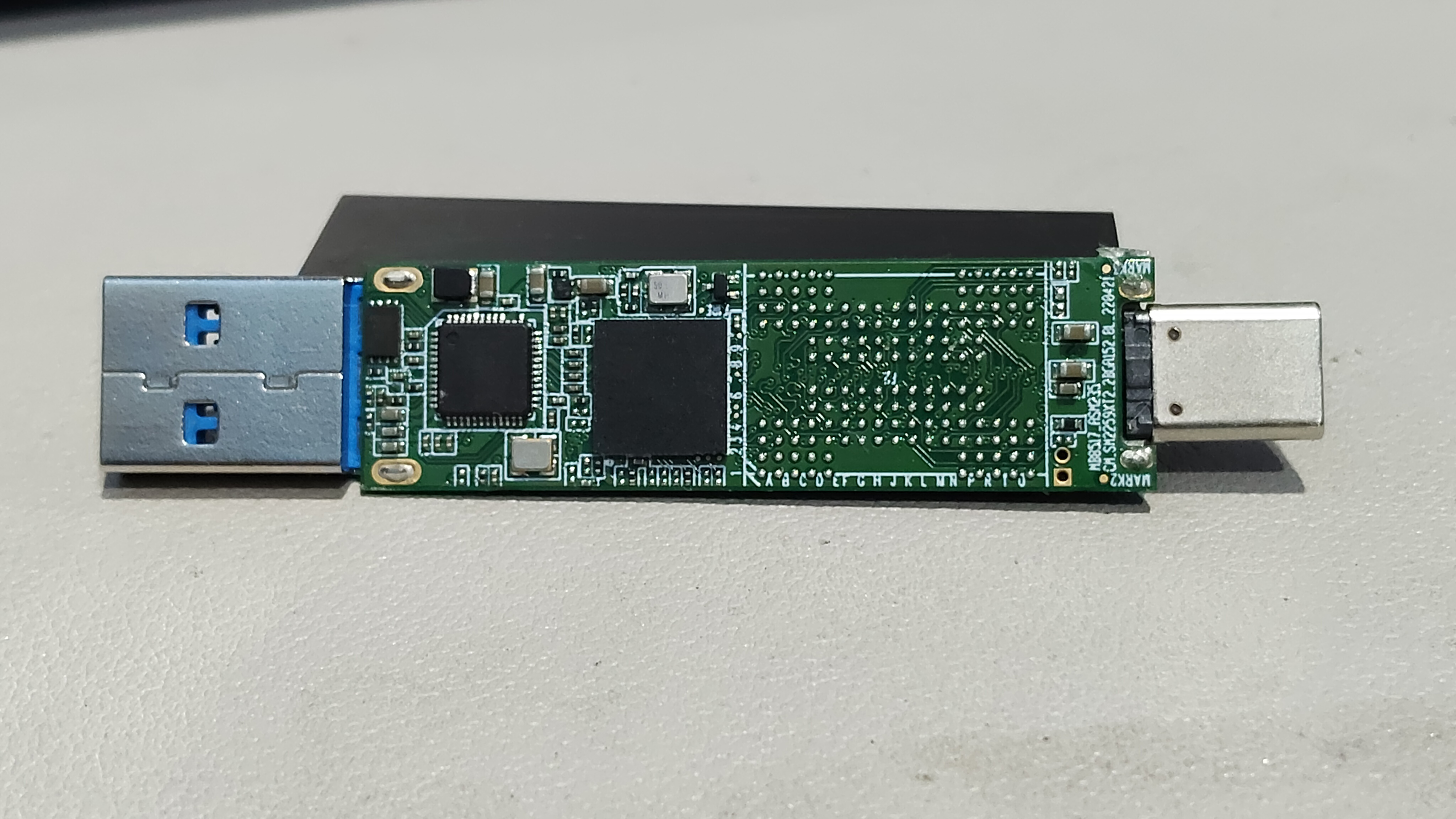

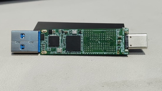

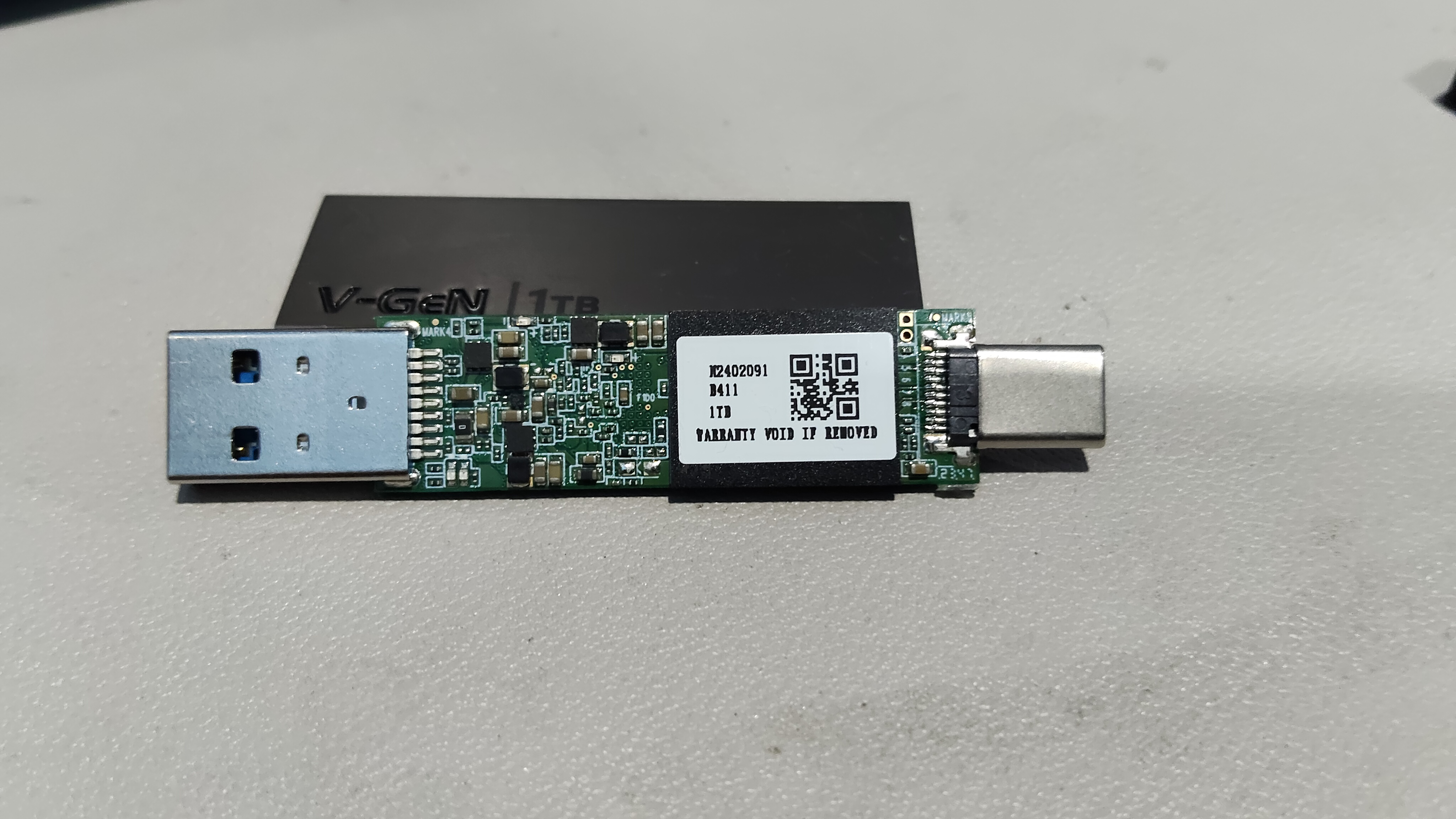

I wonder if MRT SSD support SM2259XT2G AA on VGEN SSD 1TB PSSD SATA III USB, USB C-type. Anybody succeed to recover data on it?
The problem :
1. PC not detected.
2. Red and blue light are lit.
3. Under thermal camera, ASM235SM (USB controller) show up 56 deg Cel (normal?).
4. Stand by current consumption is 140mA.
What possibilities issue of this SSD?
Thanks for your knowledge sharing.

No anybody answer yet while I am struggling to get more information.
NAND CHIP ID :
AD 7E 2A 53 02 B0 00 00 it is Hynix 3dv6-128L TLC 16k 2048Gb/CE 512Gb/die.
Model: SM59XT2A-80-10000001
F/W : 20210308
Should can load F/W FWV0609B0 (somebody succeed) , But it may kill the data while SSD will be back to work as normal.
