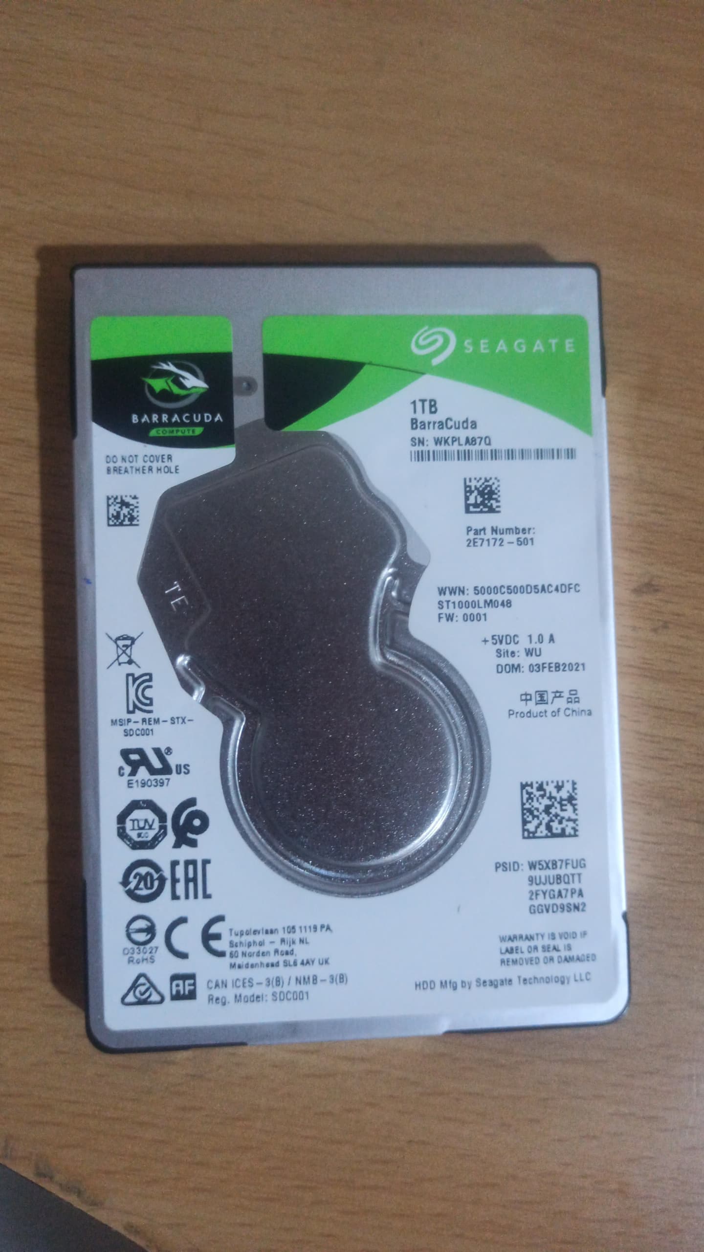

 Post subject: ST1000LM048 couldn't find files after formatting
PostPosted: July 1st, 2025, 9:05
Joined: April 9th, 2021, 3:47
Posts: 143
Location: Yemen
i received an HDD "ST1000LM048" as shown in the attached the client formatted it by mistake and when i tried to recover the files i did not find the formatted files and folders
any one knows how to recover them ?
 Post subject: Re: ST1000LM048 couldn't find files after formatting
PostPosted: July 1st, 2025, 11:45
Posts: 548
Location: brisbane
Hello I am working on same model. Though I have been successful to recover handful of files , Even though files /folders are visible in recovery tree these files are all zeroed out. Recovery may not be possible. I have read recovery is possible from WD SMR drives as presented by ACELAB by T2 module but I don't know as I don't have any experience or knowledge.
PostPosted: July 2nd, 2025, 9:10
Joined: May 13th, 2019, 7:50
Posts: 1196
Location: Nederland
It supports TRIM.
