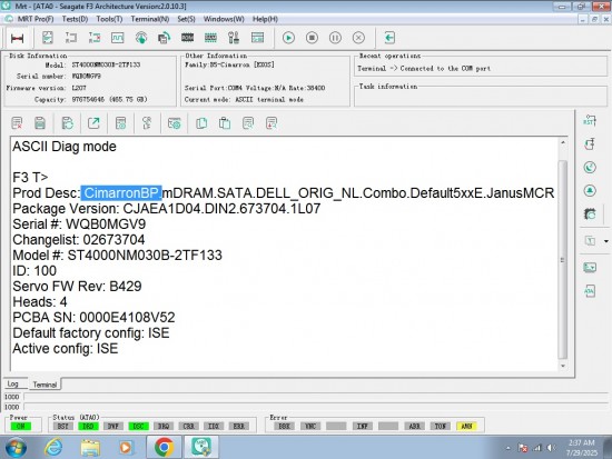

hi
does MRT support this hdd

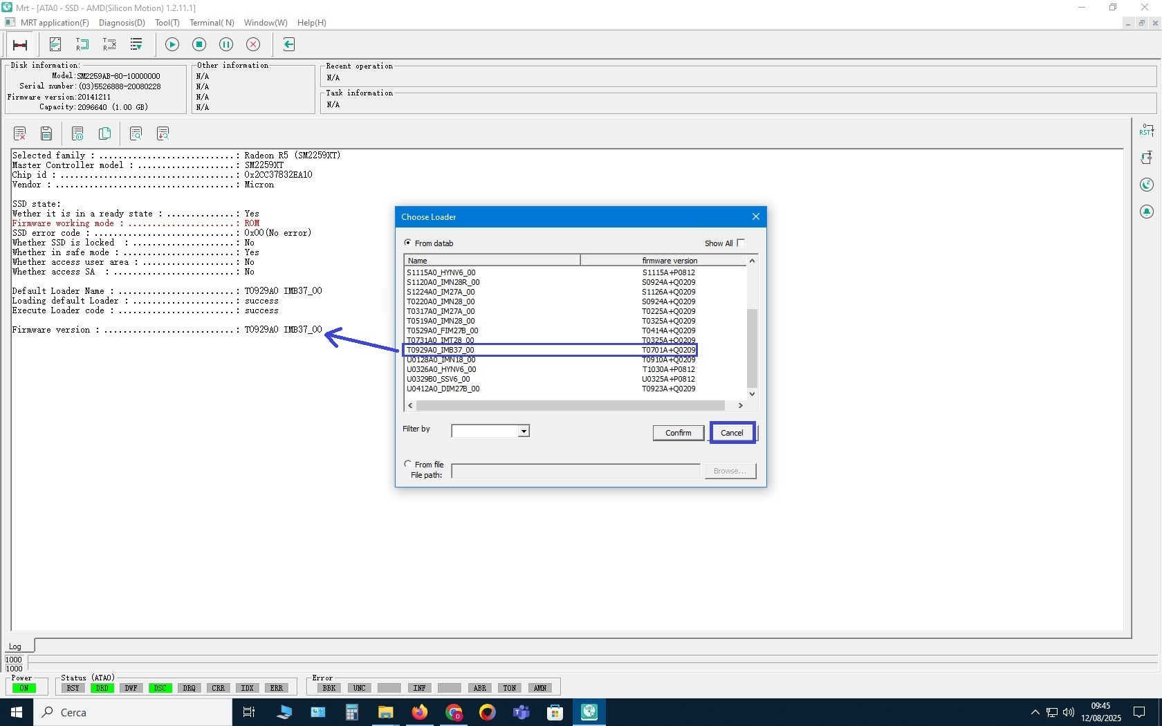

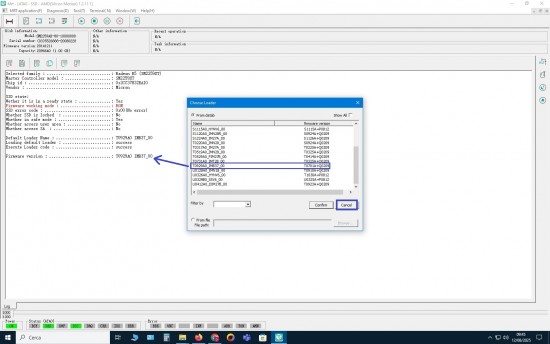

This is another bug about SSD virtual translator that fails!
I have contact mrt support, they say that is not a bug.
:x

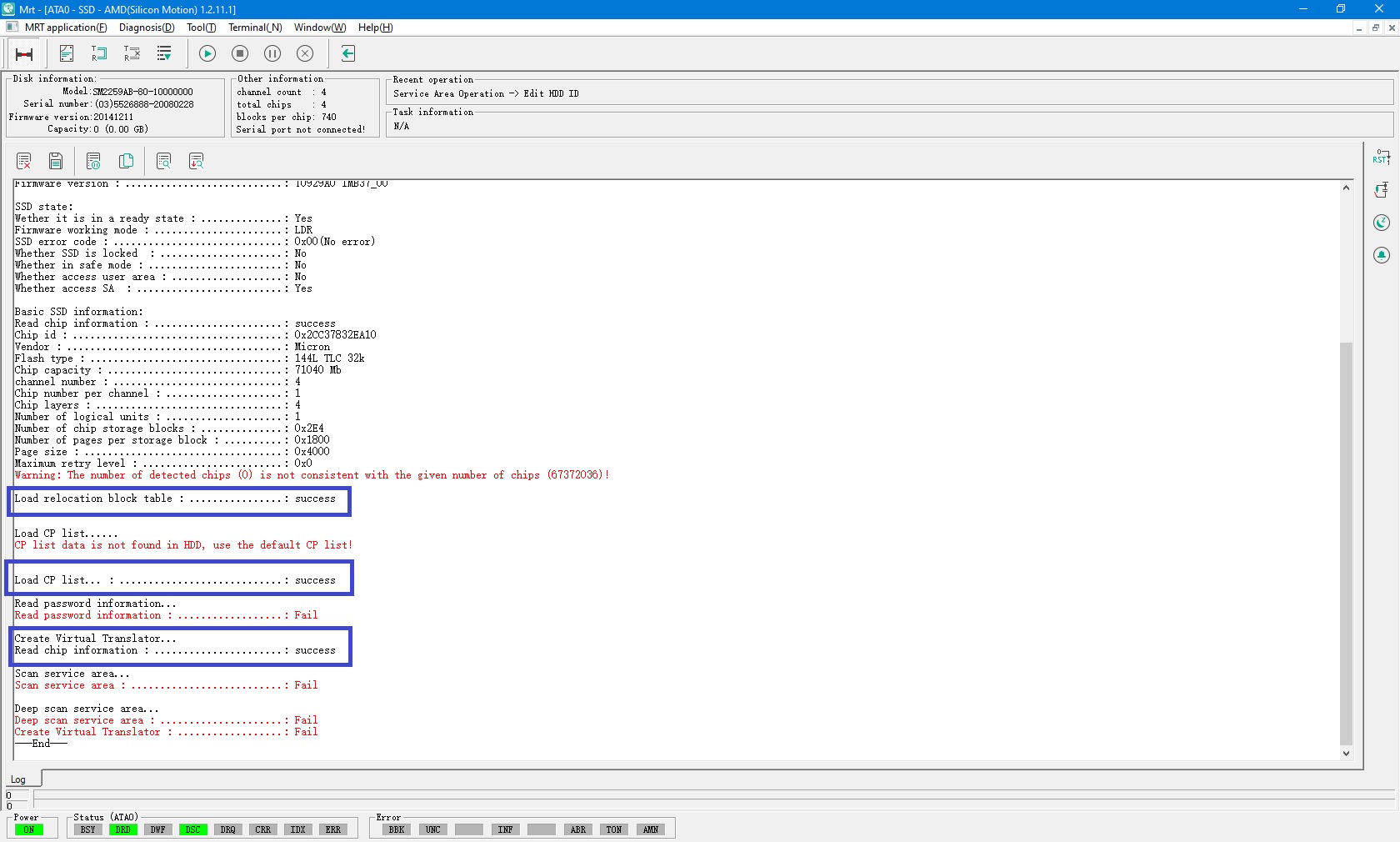

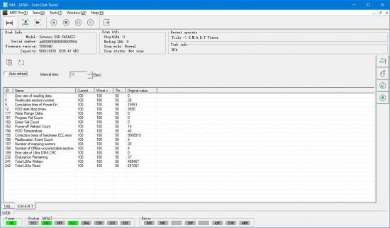

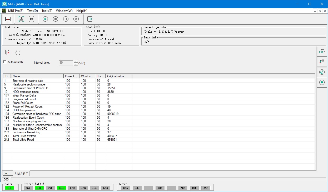

P.S.
This is how it is detect in normal mode (without safe mode)
My firmware database:
 Post subject: Re: HOW TO TO WORK
PostPosted: August 15th, 2025, 5:19
Posts: 1768
Location: Verona, Italy
as you can see on top left, T0929A0 is the firmware version of this drive detected by utility when ssd is not in safe mode.
The drive in normal mode is correctly detected, it goes busy as i try to enter to any sector, but smart status is accessible.
This means that the ssd is not in such bad shape as was told me by mrt tech support, so virtual translator should work.
Buggy!
PostPosted: August 15th, 2025, 8:35
Joined: November 5th, 2015, 18:00
Posts: 82
Location: in the lab
Try loading another B37R firmware
https://files.hddguru.com/download/MRT/ ... T0929A.rar
