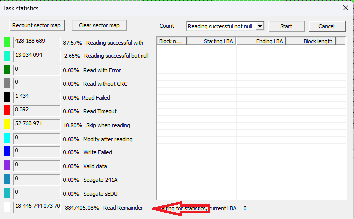

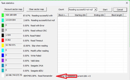

i have old disk from apple computer with bad sectors
im trying to read data from him
I would like to know if my behavior is appropriate
1. im read data using fast copy like this
+/- 87% data read, but what happend with "Read Reminder" ?

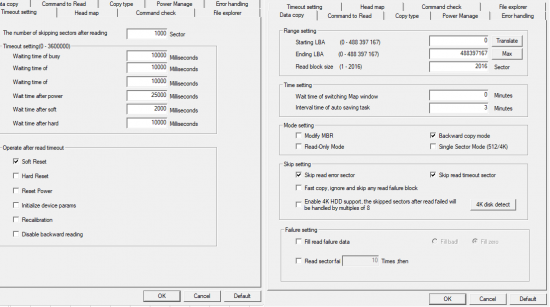

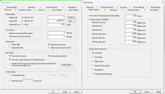

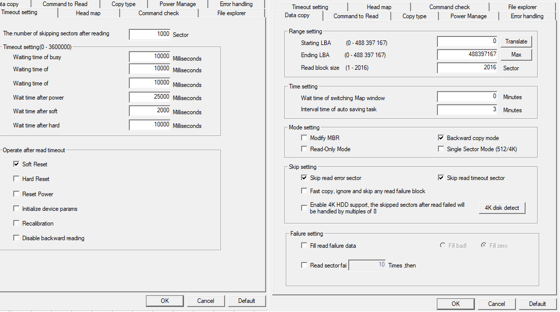

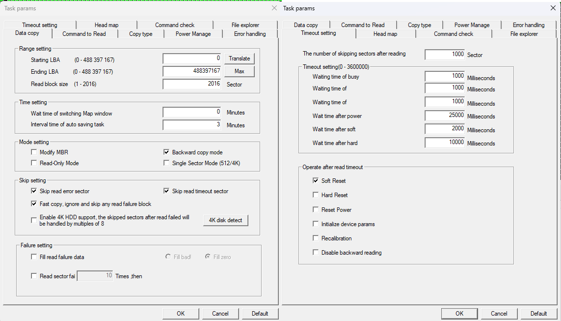

2. secend round with this settings
However, the data is being read very slowly (if I understand correctly, it is understandable due to the high timeout)
3. In future readings, I plan to increase the timeout and reduce the number of skipped segments after an error is detected.
And here's my question: is this approach correct?
