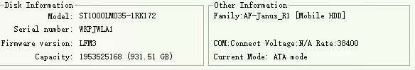

i have a formatted ST1000LM035-1RK172, LFM3 when i try to search for deleted files or search for deleted partition it gives me nothing except the ones which already there
does this one support TRIM or there is another way to recover

This is SMR disk , logical recovery may not yield anything. Try raw mode .
