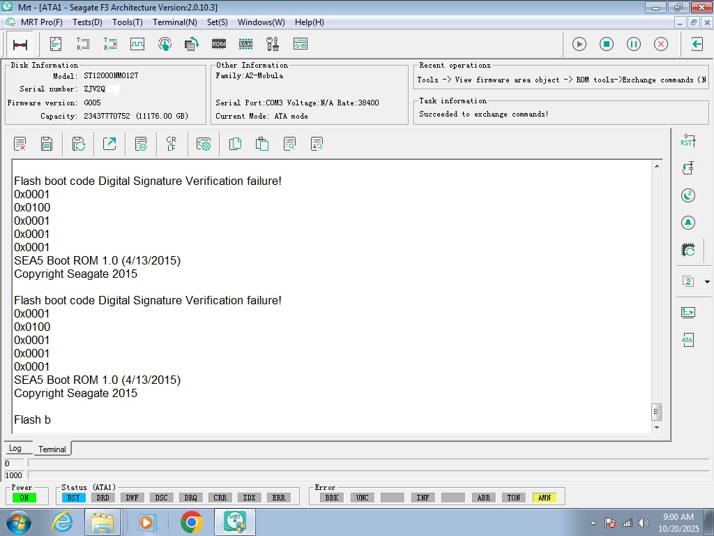

hi
does MRT latest verion support this seagate family
thank
 Post subject: Re: Mobula-A2 12TB SEAGATE
PostPosted: October 20th, 2025, 12:11
Posts: 17311
The MCU and ROM appear to be mismatched. Does the serial number match the label? Can you upload a ROM dump?

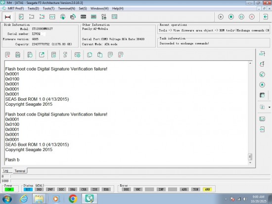

The latest version indicates support for this family, but I don't know if it supports this specific model.

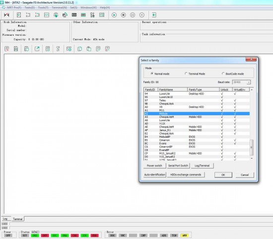

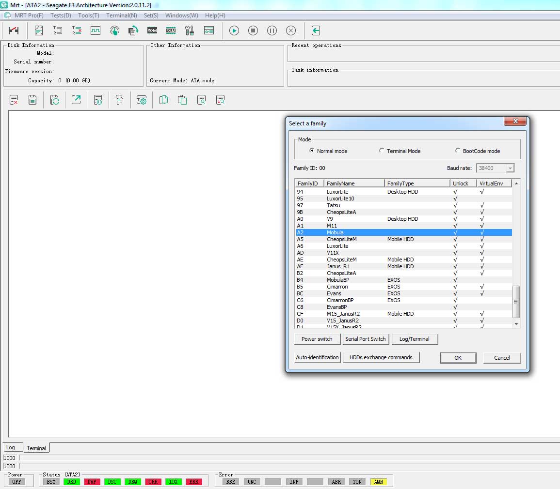

Check if this works
and use handshake mode 2 (command exchange 2)
ROMUnlocked.zip [267.39 KiB]
Downloaded 249 times
