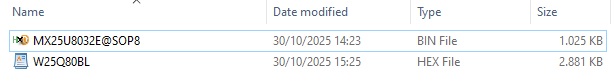

Lukas, file size in attachment. It my capacity issue ?
Alhalal555 , I am using MRT 2193.

1025KiB is too big. It should be 1024KiB. This IC has an additional 4Kbit OTP area for serial number and special data.
https://www.macronix.com/Lists/Datasheet/Attachments/8639/MX25U8032E,%201.8V,%208Mb,%20v1.4.pdf
Upload your ROM dump so we can see what is happening.
