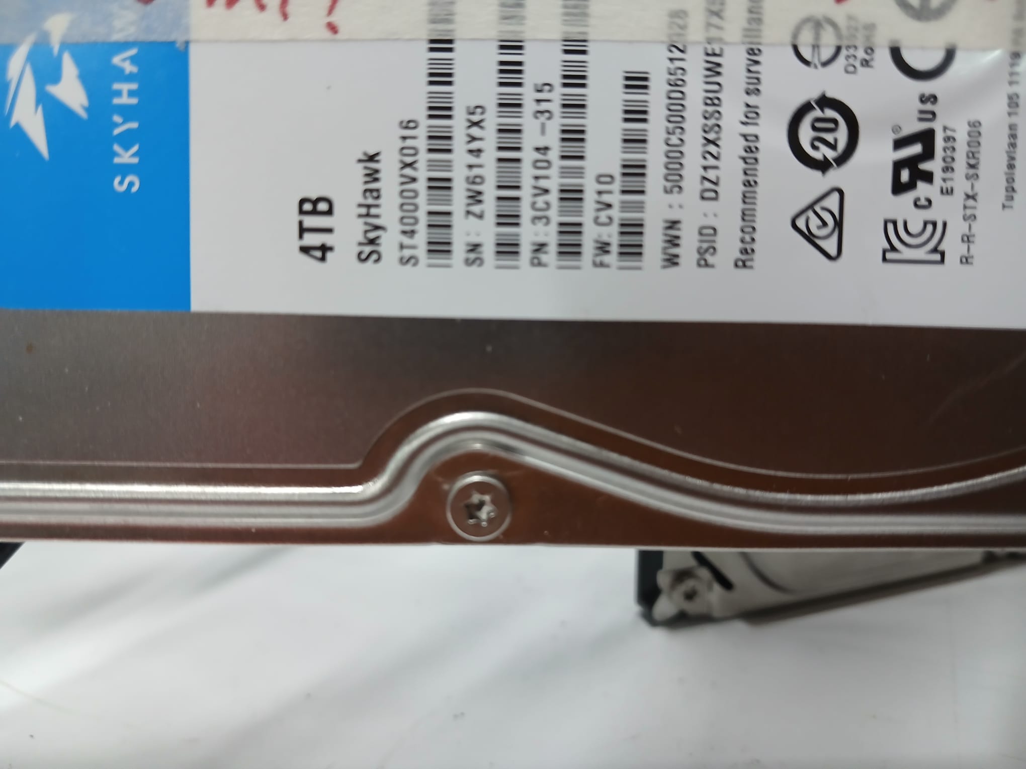

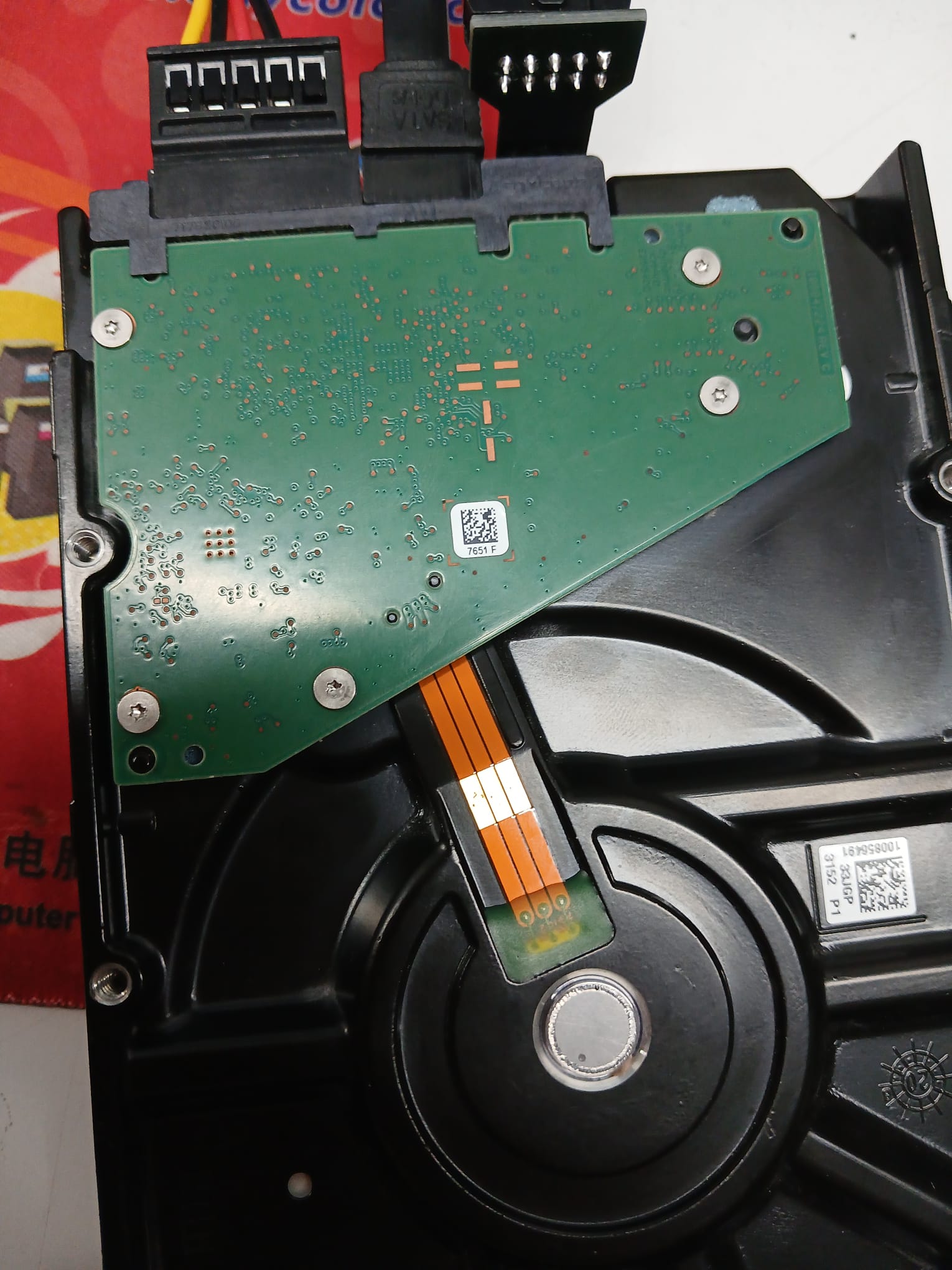

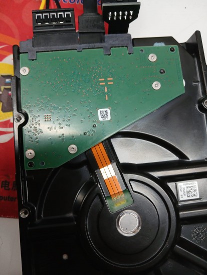

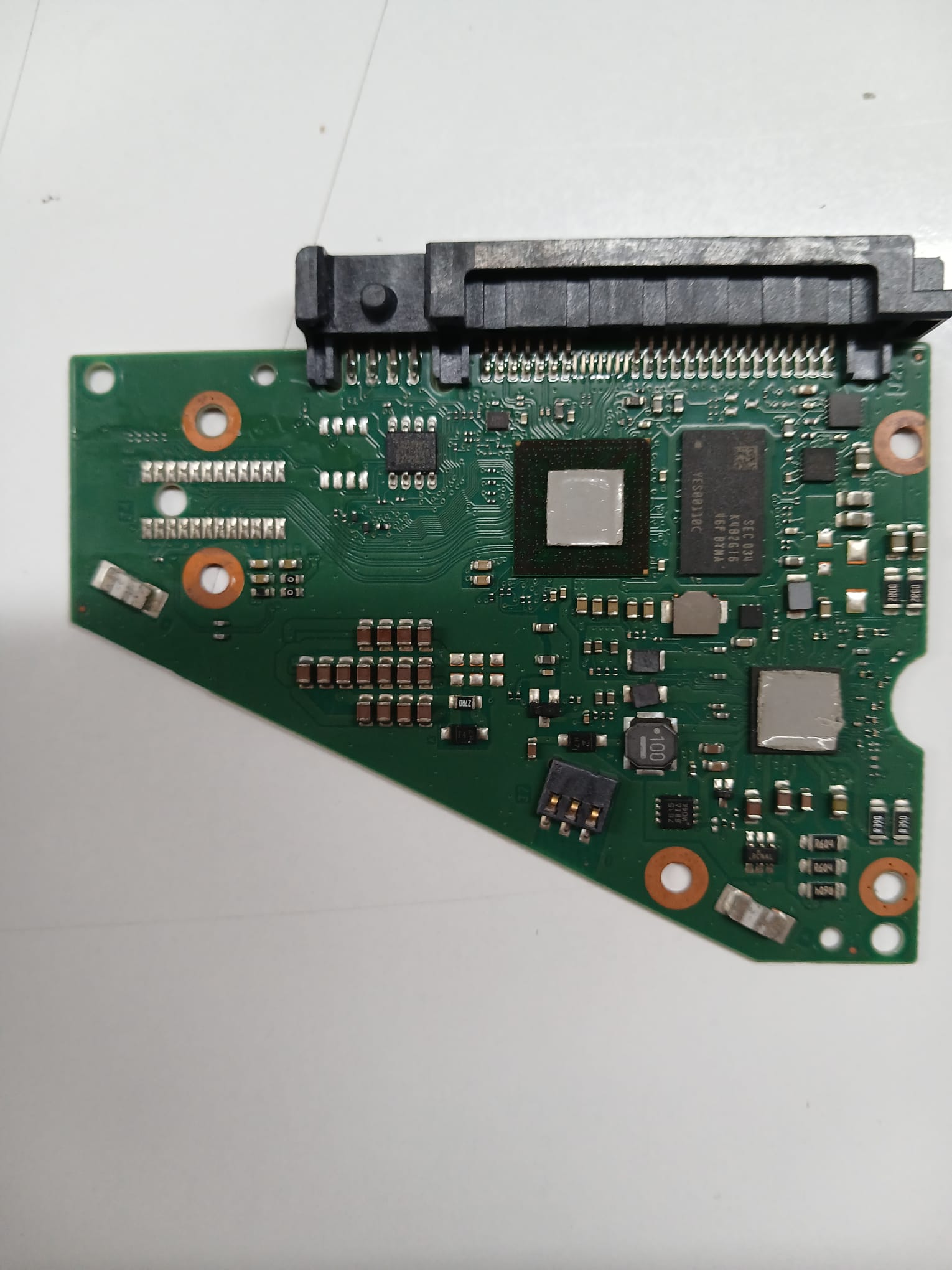

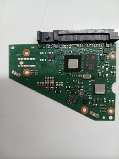

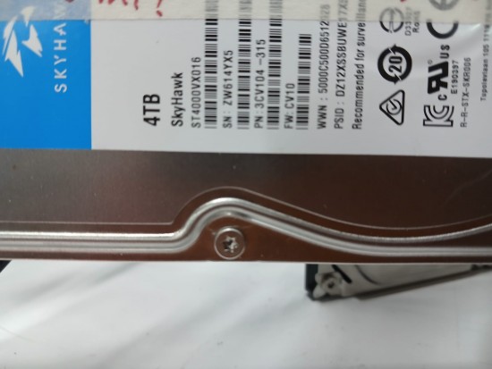

Can you show us the label and both sides of the PCB?

HddSurgery identifies ST4000VX016-3CV104 with CV10 firmware as Hepburn_Oasis.

The date code on the SDRAM is "034". That's week 34 of 2020.
The date code in the CAP appears to be "11192021", which is Nov 19, 2021. That's more than a year later.
There are no solder marks on the ROM, so that would suggest that the ROM has been hacked with a chip clip or via the terminal.
