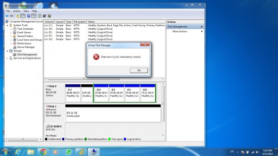

Hello everyone
I have a laptop hard disk not used for a long time,
I tried to use it through USB hard disk enclosure. the two blue lights are on but
in Management
It says unllocated
It doesn’t even show on my computer

Take out of enclosure > connect through SATA > clone it using HDDSuperClone. Your poll makes zero sense.
+1.
Then, analyze with DMDE.

Your drive has disk surface damage/degradation, which is triggering cyclic redundancy check errors (aka bad sectors).
In order to recover the files, the data has be cloned to another healthy drive.
For Do-It-Yourself methods, hddusperclone or ddrescue are ideal. Otherwise, reach out to a data recovery specialist (not a computer shop).
