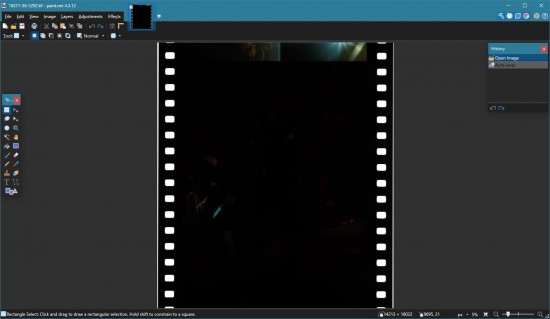

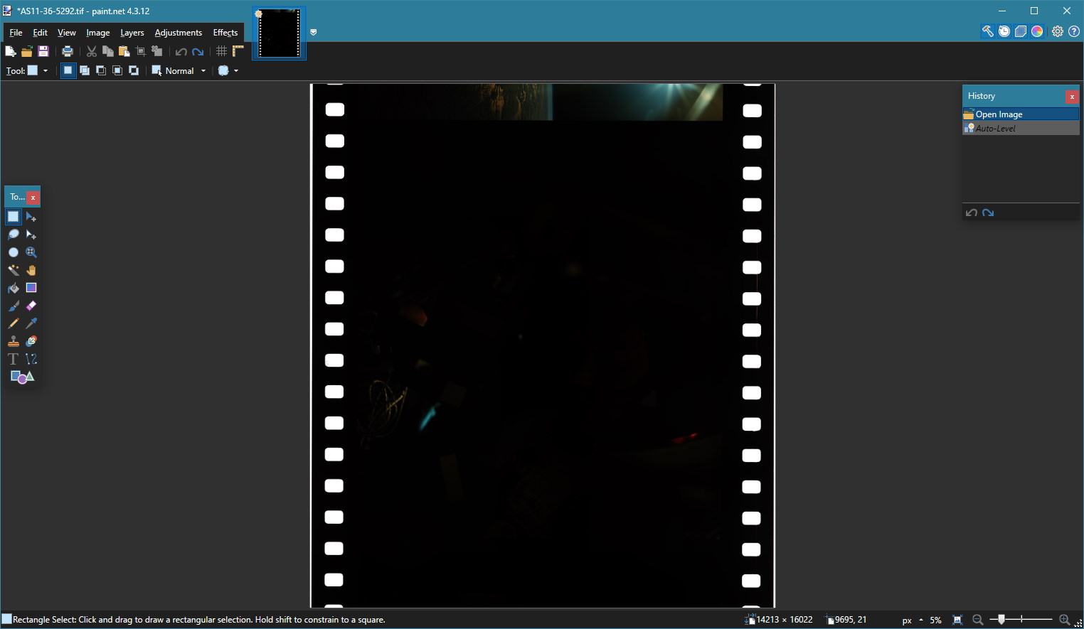

Well, I'd say the info is actually inside the file. It has nothing to do with adding data or say 'fabricating' things. These kind of misunderstandings are the seed of all kinds of conspiracy theories.
These are scans that are publicly available. So I just took one sort of randomly that looks underexposed, and downloaded the TIFF file just like the author of the book did,
http://tothemoon.ser.asu.edu/gallery/Ap ... 11-36-5292

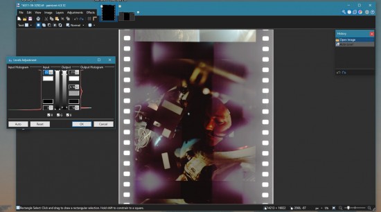

By just slightly adjusting levels of the huge TIFF file we bring out details that were initially invisible. Purely image processing. I did not 'add' anything, I simply exposed what was invisible in original scan. This is one of the techniques used by the author of the book, he's just better at it and put more time into it than me. This enhancement took me 3 seconds of my time and a free photo editor.

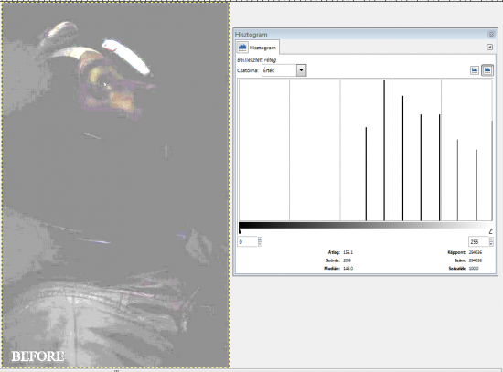

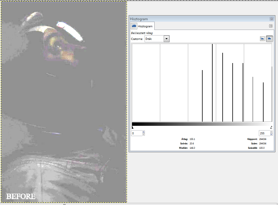

the 'just isn't there' was not about what you or anybody can reveal by adjusting the levels. I meant that there is no detail in between those levels. I never meant to say there is no data at all if we can't see it because of being underexposed, just that a lot of the details are lost because the very low number of levels actually showing up in the image.
btw, the before-after pic is also a cheat because the image downloaded from your first link already shows something while his 'before' pic shows full black except the window. So we are definitely talking about different things, i took his 'before' pic as a basis of my comments.
I, as anybody else, was able to make the pic you linked a lot more enjoyable in 5 minutes of adjusting but i'm afraid his 'before' pic was darkened intentionally
this is what you get if you start adjusting the levels of his 'before', with its histogram. Fairly obvious that pic contains very few levels, a lot fewer than what you linked as originals...
So where is the big deal? presenting a manually degraded image as original while using another one as a basis of our transformation????

Start of discussion is photo enhancement "Hollywood style". All I am saying this enhancement in Apollo photos isn't Hollywood style. Hollywood style assumes we can pull data from thin air and enhance a 3 pixel number plate into something readable. It is about information that is actually there, Apollo edits illustrate that.
I am using 2 images, the originals, the TIFF scans and play with levels. I claimed nothing else than that and that's what I did.
This is original used in video, not an artificially degraded image: http://tothemoon.ser.asu.edu/gallery/Ap ... 09-24-3665
What's you're using is an already processed image, probably some lower res JPEG for web use = missing the point spectacularly. How would the page load when he'd use the almost 1.3 GB original scan?
You can take levels of this but it will not tell you anything that can be 'recovered' from original because it's edited for web use. Just like the before - after examples. I fail to see what your histogram is supposed to illustrate, it's a darned tiny pic for website use. Anyway, this is a JPEG made with information I took from the underexposed TIFF scan, it has nothing to do with art, the information is there.
