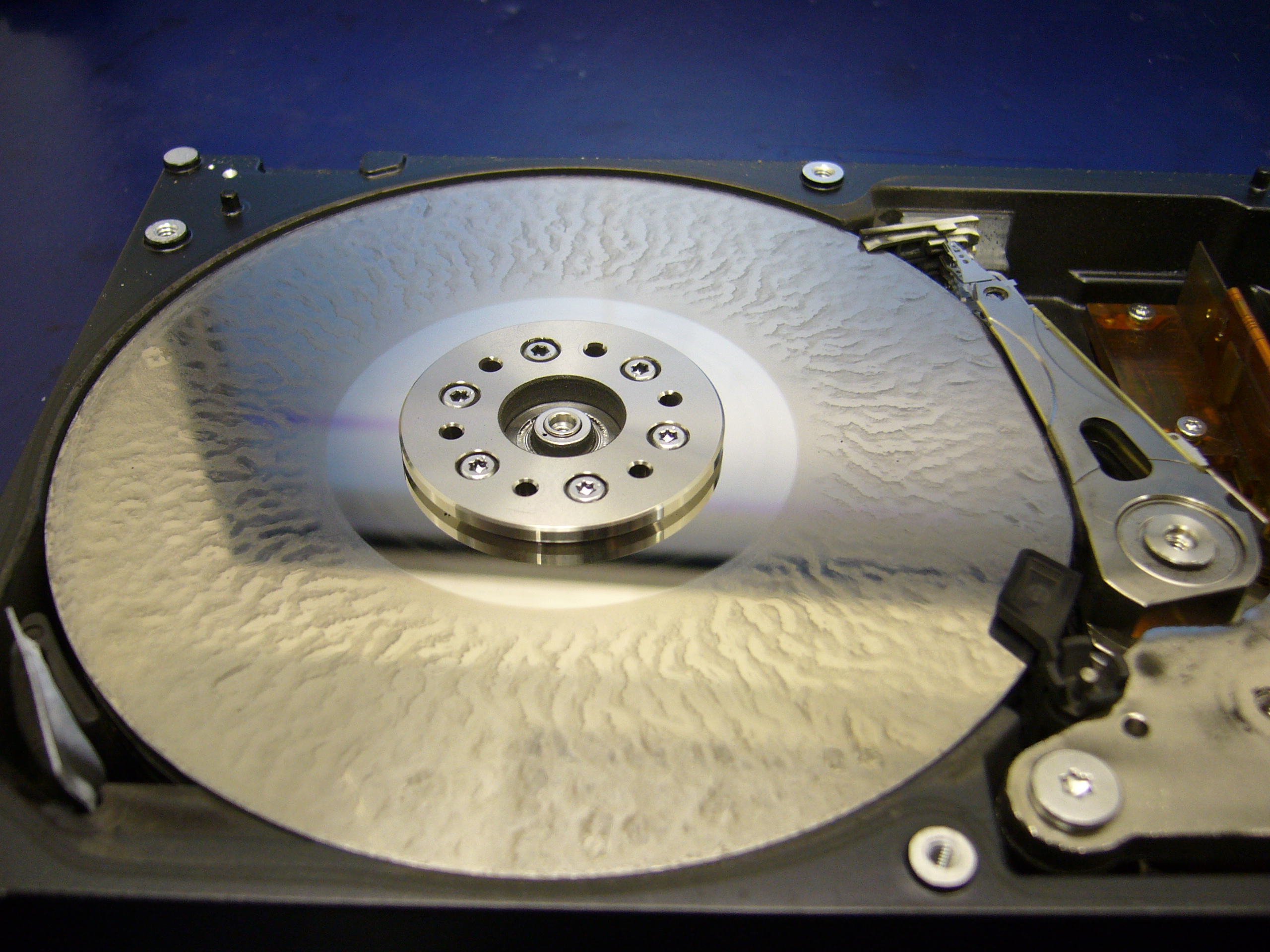

Just received a drive from a customer that said the Geek Squad at Best Buy put his hard drive in the freezer. Before it was just "flaky", now it doesn't boot.
To be continued after diagnosis...

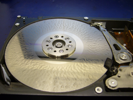

The result.
- Attachments
October 27th, 2011, 17:03
Thats freezer burn!
October 27th, 2011, 18:02
But even seeing this, people will STILL freeze their hdds hoping to save a few $$$
October 27th, 2011, 22:09
Seagate's HDD product manuals specify a non-operating temperature range that goes down to -40C. I'd like to see their test setup.
October 27th, 2011, 23:35
Nice media damage. Typical for Hitachi
I don't think freezer has anything to do with it

I tend to agree with Doomer.... this type of damage is typical of these drives. I have seen this many times, and they've never been near a freezer. Having said that, I would NEVER condone placing a drive in the freezer to "Magic" away it's troubles. You may as well leave it on your workbench overnight and hope that the Hard drive fairies come in and do their thing for you.....
October 28th, 2011, 8:21
I believe in this case freezing the drive did result in the damage. Condensation alone can cause the heads to come in contact with the platter. Also when the condensation freezes, ice crystals form on the platter.
According to the customer the PC was able to boot but would eventually crash. After having the PC worked on, which included freezing the drive, the PC would not boot and the hard drive made scratching noise. Now obviously it is possible that something else went wrong that they did not disclose to the customer, like dropping the drive on accident. It is also possible the hard drive had damage to it and attempts to boot over and over caused more damage.

Nice design made on the platter . hahahaha
