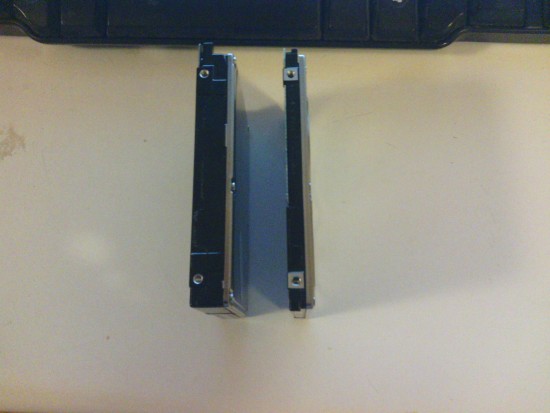

First of all, please forgive me if this question is newbish. I tried to do a search but couldn't quite find the answer.
I just inherited a 1T hard drive. Look at the picture. On the right is a standard 750gb 2.5 hard drive. On the left is a twice as thick hard drive that is 1T.
I can't seem to find any case online that fits the one on the left because it's too thick. What should I be searching for? It's not quite a 2.5 and it's not quite a 3.5 either.

That drive on the left is a 2.5" drive (it would be nice if you gave us the specific model number :) ), but it seems to be one of the early 1TB models, which were thicker than the "typical" 9.5mm (which looks like the thickness of the one on the right).
If you want a case, then you'll need to measure that drive's thickness, and check that parameter for any 2.5" case you consider. Or consider a "docking station", as those often have fewer limitations about drive thickness (although some still have a limitation). Or use adapters to convert to 3.5" drive size and then mount the drive+adapter into a 3.5" drive case. Those are the options that I can suggest - other people may suggest more.

Apologies for the picture. Here is an attachment
Re: Hard drive weird size?
December 17th, 2011, 15:17
It is 15mm in measurement. Are you telling me there are 9.5mm 1t out there?

I was referring to 9.5mm as the typical height (thickness) of 2.5" drives in general, and this is often the height limit for 2.5" drive cases - exactly as you have found! But to answer your question...
cannibal wrote:Are you telling me there are 9.5mm 1t out there?
Yes. Google is your friend, if you want to check :)
