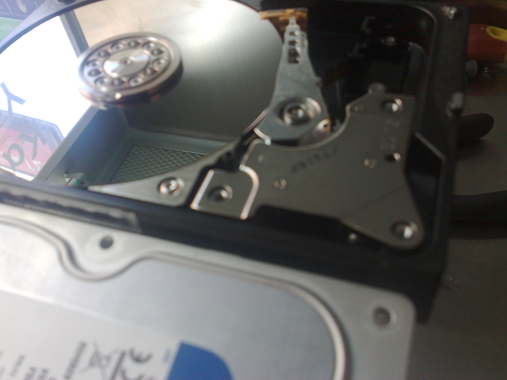

OK, I remembered I bought some seagates and hitachis from same place. But they still work. Gonna check them too.
I opened the drive. This is a good job :)

Looks like they just stuck a fake label on an old Tornado

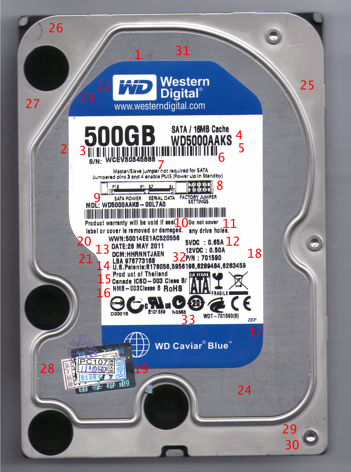

This is what I noted right away, and it's a tedious thing to point everything out. The fake label is wrong and full of tiny mistakes. Basically we're looking at spelling and spacing mistakes.
1- label edge and cut is wrong, curve not smooth either..
2- left label position off, covering indented mark if there is a mark there, should have more marks too
3- serial number, vertical spacing, ":" position
4- spacing error, vertical, and 16MB spacing
5- spacing error, mostly vertical
6- spacing error
7- spacing error and poor quality connector graphic
8- oversaturated sata/jumper graphic
9- more spacing errors, positioning of ":" and "M" in relation to barcode and sata graphic
10- seal = sesl ? spelling error, vertical spacing between 2 lines
11- vertical spacing
12- LBA, most likely should be here and not by 14, due to printer limitation see 10, 11
13- DATE, WWN justification, vertical cspacing consistency
14- more spacing errors, again with ":" and font proportionality, U.S. LBA vertical error
15- "Prod uct" vs "Product", also vertical space problem
16- Canada ICES & NMB position all wrong, ROHS appears almost subscript
17- ZEP vs A and justification
18- missing code array (I call them dotboxes)
19- what is this series of labels? Is it covering up something?
20- position of label against indented mark
21- note the sharper curve in the label here
22- the white arrow in WD is too thin, spacing between the stylized WD is too narrow
23- edge is not perfectly straight, note the waviness
24- stamped marking, not deep enough, grain of metal wrong.
25- edge too sharp and wrong cut size (for this model)
26- what's this circular mark?
27- off center screw cover
28- 2 "cut off areas" were ripped by stress and not a clean cut, too many of these
29- screwdriver markings
30- wrong screw (for this model drive)
31- label thickness appears wrong
32- P/N vs R/N
33- poor quality graphic

My advice to consumers, looking at labels like this, is to note the vertical spacing. It should be consistent. And the quality of the graphic symbols and diagrams.
At first quick look, this seems to be a decent forgery. The other red flag was the screw markings telling me it was previously opened up.
