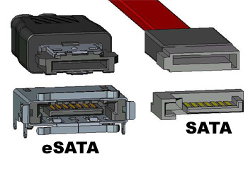

If you buy this drive with the advanced format and you are using XP then you should put the jumper 7-8 closed to align the sectors properly.
Once you have done this-never remove the pin unless you are going to reformat to windows 7 in your new pc some day.
Any hard drive upto 2tb will be ok with your computer.Just make sure you have sata connector on your motherboard. not sure but i think it should have 2.
If it does not you can always buy an addon pci sata card- cheapest.
Install windows on your newe hdd and enjoy the 1tb of space-- wont make your computer faster though.
