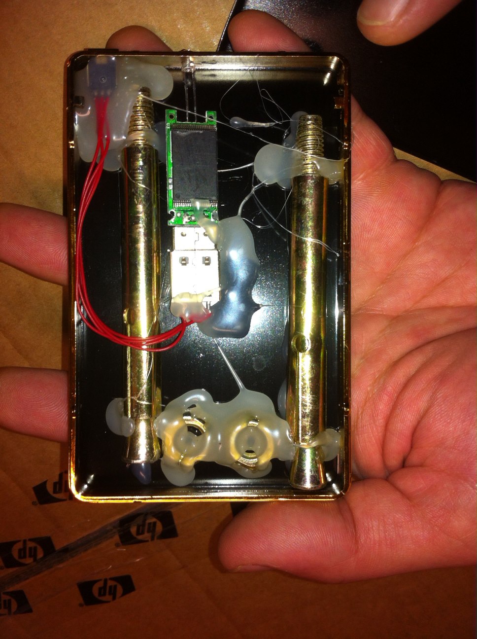

so someone sent us this photo of a hard drive they bought in china
they just return back from a tour there
and bought a hard drive from one of these black markets
this is what they got in return for there money
the unit picks up correct 500gb with a hacked firmware windows confirm its 500gb and the make and model of the drive
but when you format the unit it comes up 128mb
they thought it was weird when they tried to load up some movies on the drive
and it stopped half way.
it just kept deleting the file as if it was still transfer it over again and again
this shows not to trust anyone in china

Hey, they bought a pair of great nuts and bolts eheheehe

its a Samsung cover like the one above but his was gold colour but had 500gb
you can see the mistake right away in the writing
here another one that someone else has bought
this time no screws just bolts and memory card
watch out for this scam could end up in ebay next
company's have been scammed with this before but in bulk lot
a person nearly lost $20,000 buying a pallet of drives from a company in china
which could had resold on ebay for $30,000
they became suspicious when the person tried to rush the sale quick
and the buyer decided they would check them out
they loaded them up in windows saw the correct information then as soon as they formatted them
they came up 128mb
opened up the cases and every single one was fake.
this shows how we all need to be careful buying anything like this from china
