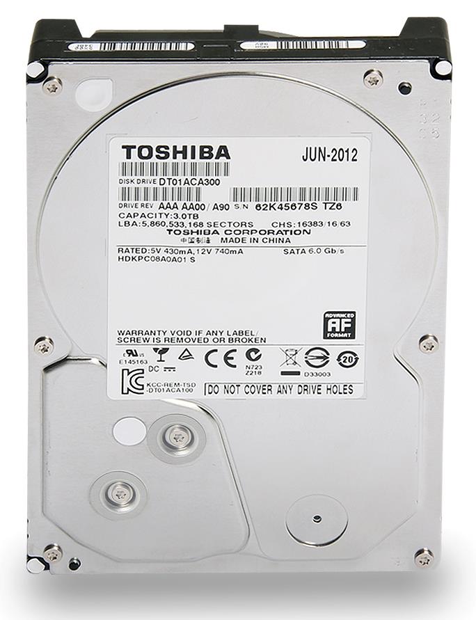

dobrevjetser wrote:
Toshiba is only 2.5"
Not anymore!
