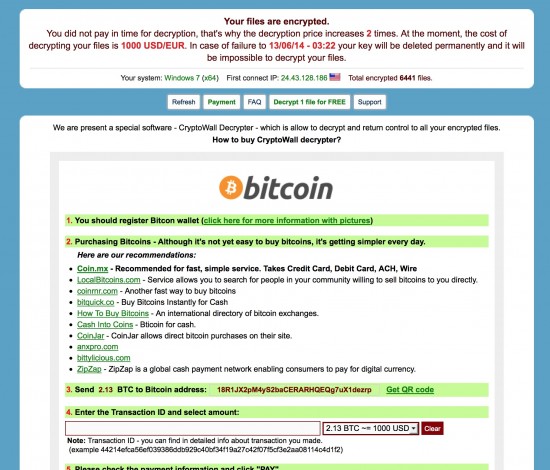

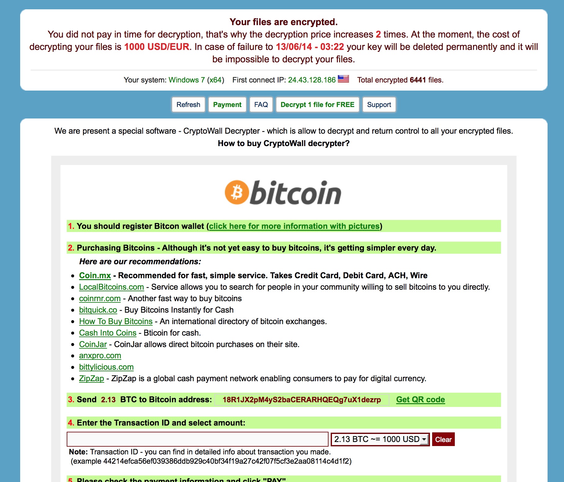

Finally got our first cryptolockered drive in today. The price is now $1000USD because customer didn't pay in time!

Maybe the customer thought $300 was better than $1000.

Why would it not be possible for the authorities or ISPs to lock down the Command and Control Server(s) and retrieve the stored public keys?
I notice that the crooks are demanding either EUR1000 or USD1000 as payment. I wonder if any of their victims have paid the ransom in Euros?

I notice that bcometa's victim is being sent to 24.43.128.186.
That IP address appears to belong to Time Warner Cable Internet. Would that be where the encryption keys are stored? Or is that just an intermediate address that handles the processing of the ransom payment?

Franc, that address is the victims IP address. The victim appears to be a customer of TWCI, it is their modems dynamically assigned IP.
as for where the keys are stored - think of every possible scenario, keys are gone, keys are on victim PC, Keys are on C&C server, Keys are on external db from C&C etc.. and the answer will be yes for a subset of the cryptolocker family of malware.
Craig aluded that there was an old version and now a new version. This is incorrect. here are many different types of old versions, many new versions and copycat malware that implement their crap wrong. No garauntee that after payment files will be decrypted.
BTW, this malware is cryptowall not cryptolocker. It is a new variant of CryptoDefense.
http://www.bleepingcomputer.com/forums/t/532879/cryptowall-new-variant-of-cryptodefense/

I believe that is the ip where the virus was initiated, i.e., the victims ip address at the time.
