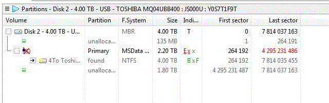

 Post subject: 4 hidden sectors in MQ04UBB400
PostPosted: July 10th, 2024, 14:15
Posts: 17137

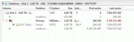

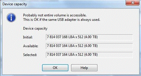

There is a difference of 4 sectors in the capacity reported by Identify Device and the USB mass storage device for a Toshiba MQ04UBB400 HDD. Has anyone examined those last 4 LBAs after converting these drives to SATA?

Not only yours disk behave like that. This thread contains similar difference in numbers https://forums.freebsd.org/threads/usb- ... tem.76477/

I have this exact drive, it does the same in DMDE.
