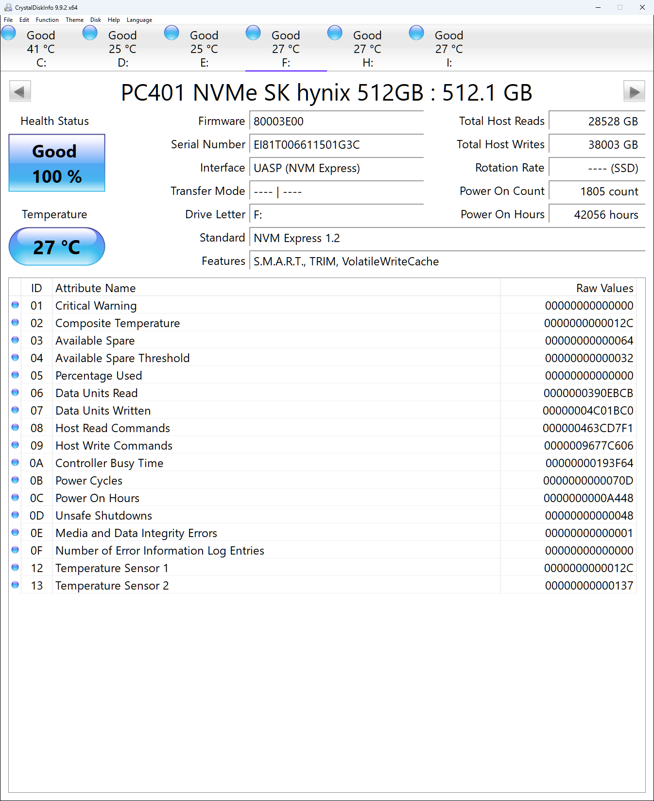

Post new topic Reply to topic  [ 27 posts ]  Go to page Previous  1, 2
 Post subject: Re: Lenovo P15
PostPosted: September 14th, 2026, 0:02
Posts: 3970
Hardcore Games wrote:
I use a large table for my gear, so top loaded disk enclosures are convenient
I have several laptops besides the P15 I have been using. Machine has a 4K OLED LCD so the machine is good for movies etc.
I have installed two M.2 SSDs in the machine but I might get larger capacity ones for more convenient entertainment
What brand of table do you use?
 Post subject: Re: Lenovo P15
PostPosted: September 14th, 2026, 10:42
Posts: 218
Location: Canada
My table is a standard office table I got from an auction some years ago. The table is 60 inches wide so there is lots of room for several enclosures along with room for my laptop. The table has no branding on it.
I use excel extensively for data processing. Most of my storage is for games which I get lots of for free.
Excel has a lot of advanced functions for statistics. I use these a lot and my CPU with 12 threads does feel the load.
 Post subject: Re: Lenovo P15
PostPosted: Yesterday, 9:16
Posts: 3970
I honestly don't know who is trolling who
 Post subject: Re: Lenovo P15
PostPosted: Yesterday, 10:09
Joined: May 13th, 2019, 7:50
Posts: 1199
Location: Nederland
The table has no branding on it
I never trust those.
 Post subject: Re: Lenovo P15
PostPosted: Yesterday, 10:10
Joined: May 13th, 2019, 7:50
Posts: 1199
Location: Nederland
Sliding drawers are convenient, as I can pull them out and store things conveniently
I must try those some day
 Post subject: Re: Lenovo P15
PostPosted: Yesterday, 13:42
Posts: 218
Location: Canada
Finally got a screenie for the SK Hynix SSD I have
PC401.png [ 235.47 KiB | Viewed 101 times ]
 Post subject: Re: Lenovo P15
PostPosted: Today, 0:22
Posts: 3970
While the general health status reads Good 100%, there is a critical hardware alert hidden in the S.M.A.R.T. values down below: ID 0E (Media and Data Integrity Errors) has a raw value ending in 1. This means the drive has encountered a physical uncorrectable data block error. It is a sign of early physical degradation, not a firmware bug.
However, the 80003E00 firmware itself has documented issues, primarily concerning inefficient power distribution and thermal stability management under specific Windows power states.
The Known Firmware Vulnerability:
The older 8000x-series firmware releases for the SK Hynix PC401 are prone to:
Power-state mismatch: The SSD can fail to wake up properly or drop off the system bus during deep sleep transitions.
Thermal throttling lag: Slow power-state shifting can cause the controller to stay hotter than intended during intensive tasks.
Recommended Solution: You need to patch the storage microcode to resolve the software bugs and prevent further data correlation issues.
You should run Seatools asap on this one as well. Multiple times a day. on every drive you own. do it now.
1) Back Up Everything: Before modifying storage firmware, back up your critical documents immediately. The 0E error indicates data corruption may happen next.
2) Download the Fix: Update your drive to the final recommended version, 80007E00. If you are using a branded machine, you can source this utility through the Dell PC401 Storage Firmware Update page or your specific laptop manufacturer's driver portal.
3) Execute the Update: Close all running applications, launch the update tool as an administrator, choose the target drive, and allow the system to reboot to flash the new microcode.
Please let me know: Is this SSD your main boot drive? Are you currently encountering any Blue Screen errors (BSODs) or system freezes? Knowing this will help narrow down if the single media error requires a complete drive replacement.
Post new topic Reply to topic  [ 27 posts ]  Go to page Previous  1, 2
