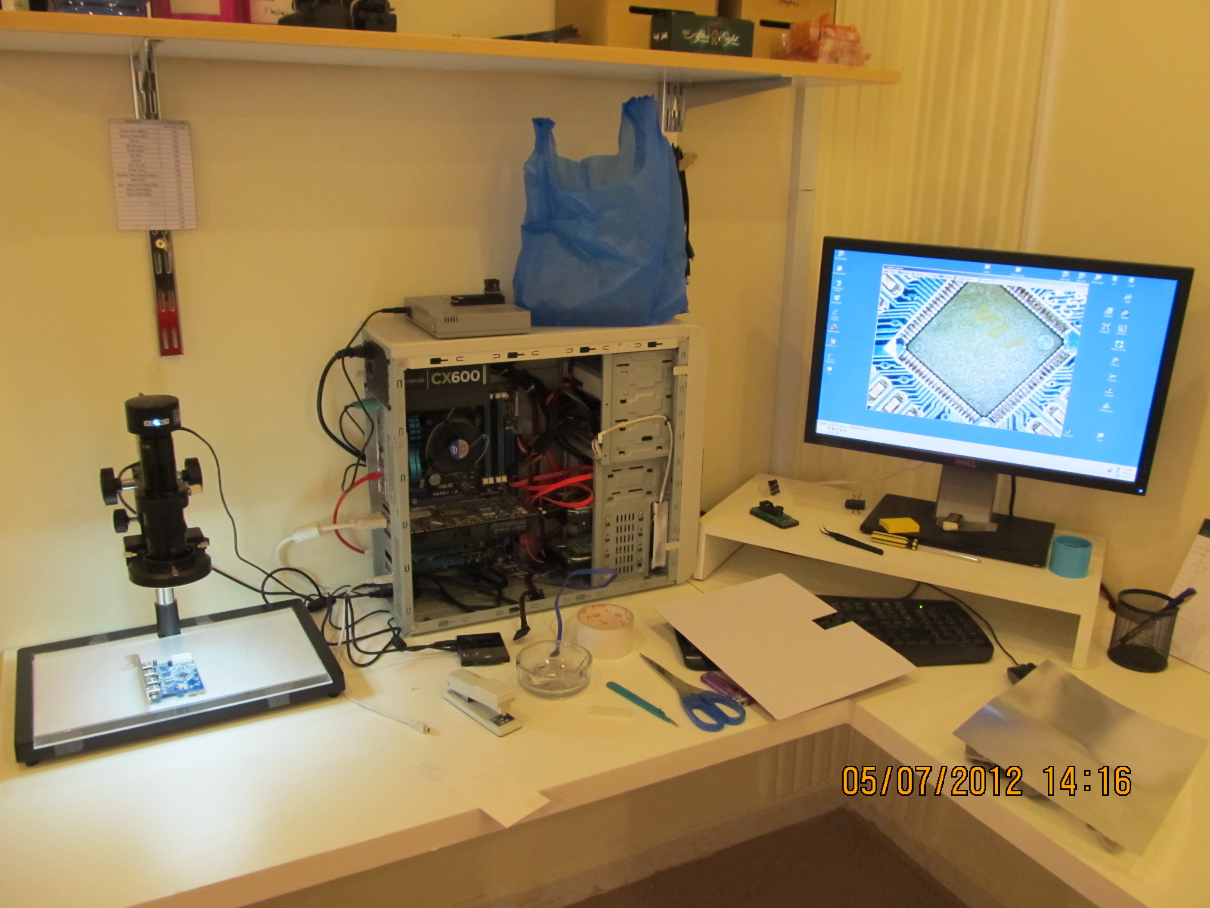

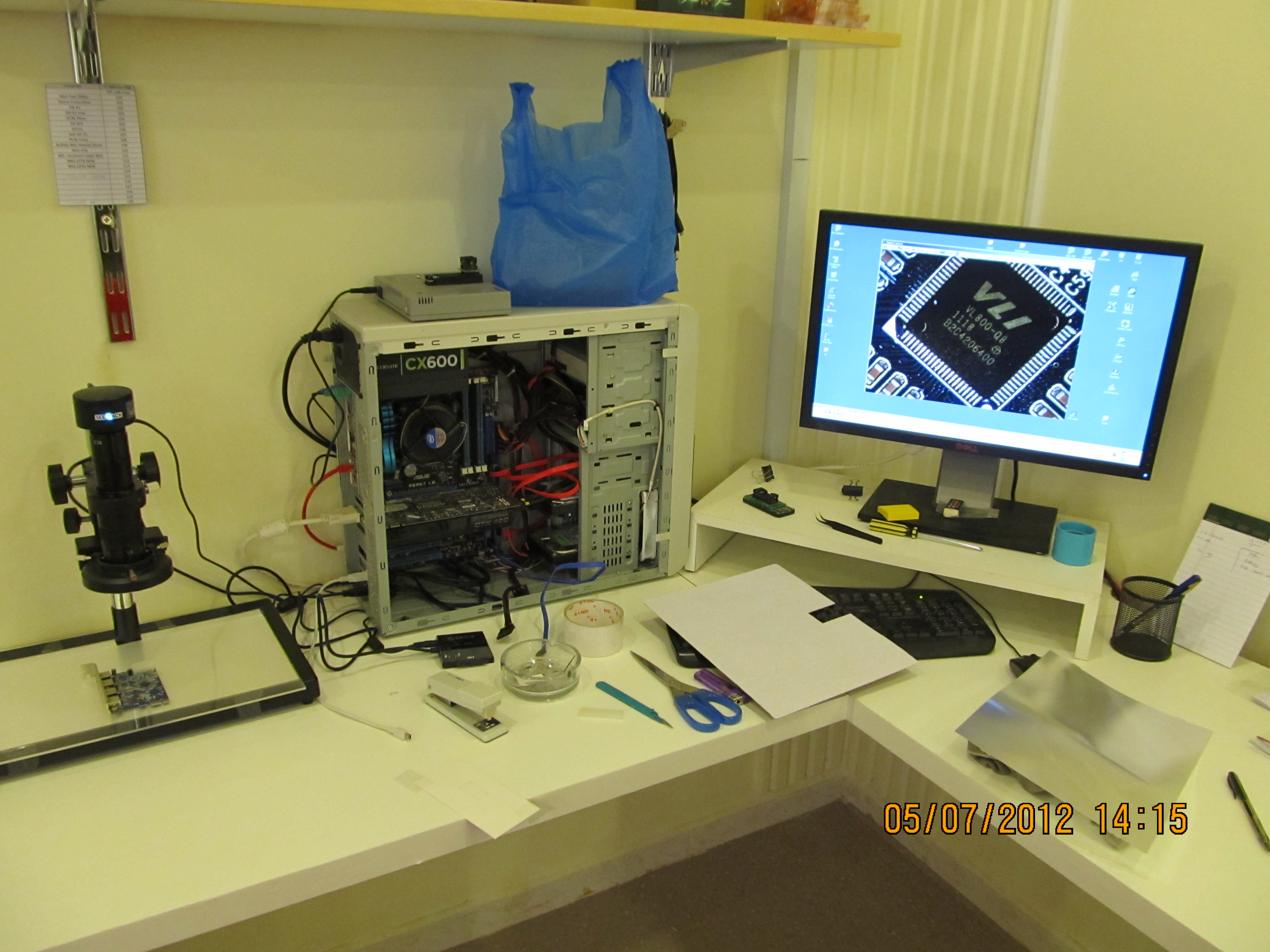

Loki, this is for you quick Tip if the LAMP is driving you crazy sometimes reading
i used one of the DEAD LCD`s reflector from inside instead of the Black BG.
you can see, without the LAMP is PERFECT.
i just added small Circle on this to put my things Quick instead of moving every time looking for the Place i wanted to focus ON.
One of my friends which i told him: I ALWAYS RECYCLE THINGS FOR OTHER USEFUL THINGS.
heheh
Good Luck
BTW, i forgot to mention Loki, Am ordering another one: HD High Definition VIDEO Digital Microscope
in order to record my TINY Soldering chips. just for FUN
Eric said, it is expensive little, but still waiting for my Brain to cook the subject more for ordering hehehe
