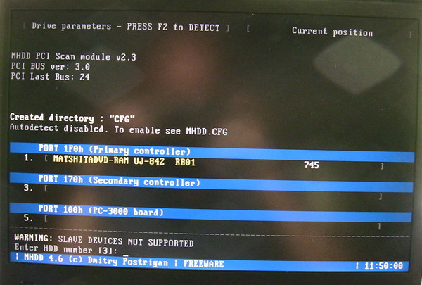

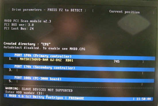

I can't get MHDD to even find the drive using just this method (latest version 4.6, ISO CD version). This is on a ThinkPad T60. It sees the CD drive just fine, but that doesn't help me. (I did try the /enableprimary command-line option too, for what it's worth). I'm attaching an image (or will attempt to, anyway) of the screen that I see if anyone would care to diagnose...
tinkerdude

Probably need to put it in ATA/IDE/Legacy mode instead of AHCI (or use a different computer).

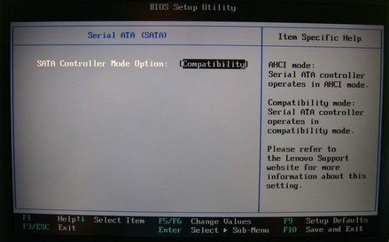

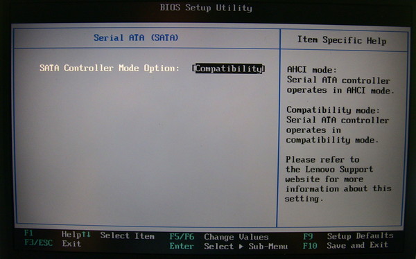

Well, that helped. I changed the "SATA Controller Mode Option" from "AHCI" to "Compatibility" (see photo) and MHDD could then recognize the drive.
Problem is, it turns out that MHDD cannot change the ATA Master Password. The manual even says the "PWD command sets USER password". See http://hddguru.com/software/2005.10.02-MHDD/mhdd_manual.en.html#chapter2
There apparently is no support for changing the ATA Master Password in MHDD.

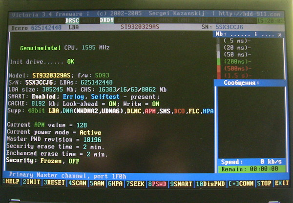

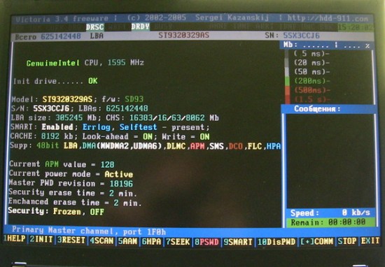

Now, Victoria for DOS does have an option for that and I was able to get that going. But the hitch is, as I suspected, you can't change passwords once the BIOS freezes the security with the ATA SECURITY FREEZE LOCK command. You can see in the photo below where Victoria shows "Security: FROZEN".
I tried popping the drive out and back in, but with this system (ThinkPad T60) when you pop in a drive that has the unfortunate side effect of cutting all video. The system doesn't crash, but I can no longer see what it's doing (not even via the external video port). So that's apparently a dead end as well.
Any other ideas?

File comment: Victoria for DOS shows frozen ATA security
In that case I would recommend using a different machine

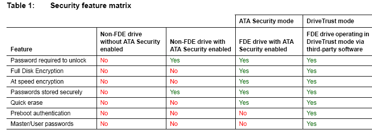

 Post subject: Re: Security theater (backdoor ATA Master Password)
PostPosted: June 2nd, 2010, 10:18
Joined: October 15th, 2009, 8:11
Posts: 51
Location: Islands

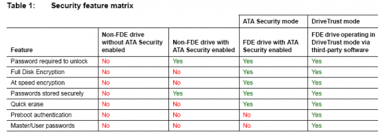

Seagate does confuse issues with this Security feature matrix.

Doomer wrote:
FDE has nothing to do with ATA password. FDE drive can have two passwords: one for FDE and one ATA password (just in case you may need it).
Hmmmmm.
From a Seagate FDE FAQ at:
http://seagate.custkb.com/seagate/crm/selfservice/search.jsp?DocId=206011&NewLang=en
"Momentus FDE drives can be described having three password modes: OFF, standard ATA security, and Seagate Secure security. When passwords are OFF, the drive family can run on any OS, system and BIOS. When passwords are managed using standard ATA security, any notebook BIOS with password controls is compatible. In this case, the password challenge looks exactly the save as a non-FDE drive. These two password modes are also valid for non-Windows applications."
Also:
"Between the two security modes on the drive, traditional ATA security and the Seagate Secure mode, there are significant differences regarding passwords. Seagate Secure and traditional ATA password modes are mutually exclusive. One cannot activate both types of passwords at the same time."
Finally, for my FDE drive, there is no other way to manage security other than with ATA passwords. The ST9320329AS comes with no Seagate Secure (AKA Drive Trust) features, which I didn't want. See:
http://www.seagate.com/docs/pdf/datasheet/disc/ds_momentus_5400_fde_3.pdf
So for my FDE drive, security has everything to do with ATA passwords.
Wow! So my diagnosis is right. It is "I know it all" type
1. I have personally seen FDE drives with ATA password and FDE user password enabled at the same time
2. FDE drive is ALWAYS encrypted even if you don't have any "passwords" enabled. Don't you think that enabling ATA password will be already not the first step in security of such drive?
3. There is a way to enable Drive Trust mode on your drive and if you don't know how that doesn't mean it's impossible
4. So for your drive or any other FDE drive ATA password has nothing to do with FDE password
5. About manuals - user manuals for any drive of any vendor will stand that it is impossible to access user data if you set and lost ATA password, apparently some users beleive in this and some even "know it for sure"
I have a perfect solution for you - buy a latop with true FDE support if you want real protection and at the same time open a savings account and start putting money on it - you will need them to recover you data one day
