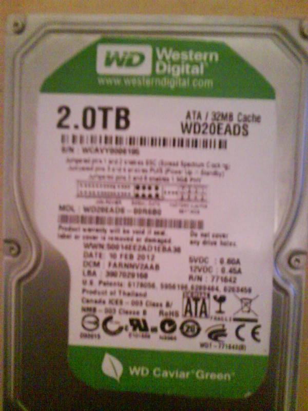

New unpacked WD bought in Austria !!!
And guess what... hdd clicks

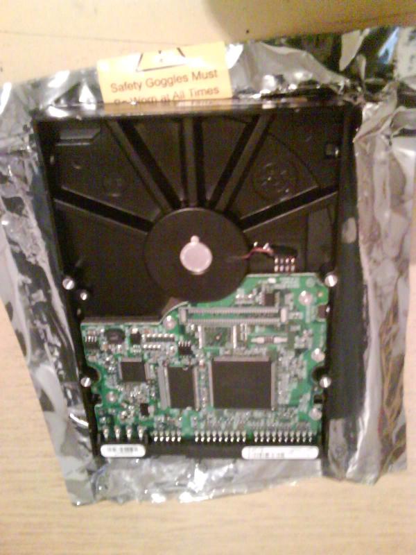

Is that an IDE PCB or my eyes are twilighting? It looks like old Seagate IDE PCBs :lol:
Now that I look closer, the chassis ain't WD!! :lol: :mrgreen:

Maxtor. Doesn't look like they even pulled the barcode sticker off of the top edge.

Looks like an old Maxtor Calypso, pretty sure they didnt go bigger than around 300GB!

From what I see it IS a Calypso or similar chassis with a PCB. The PCB can be from a 60GB or another ATA with ext. rom fitted. Whatever is, the drive is broken and the top label is fake. Look at "2TB ATA" and then there is SERIAL ATA logo down after. A "LEMON DELUXE". :lol:

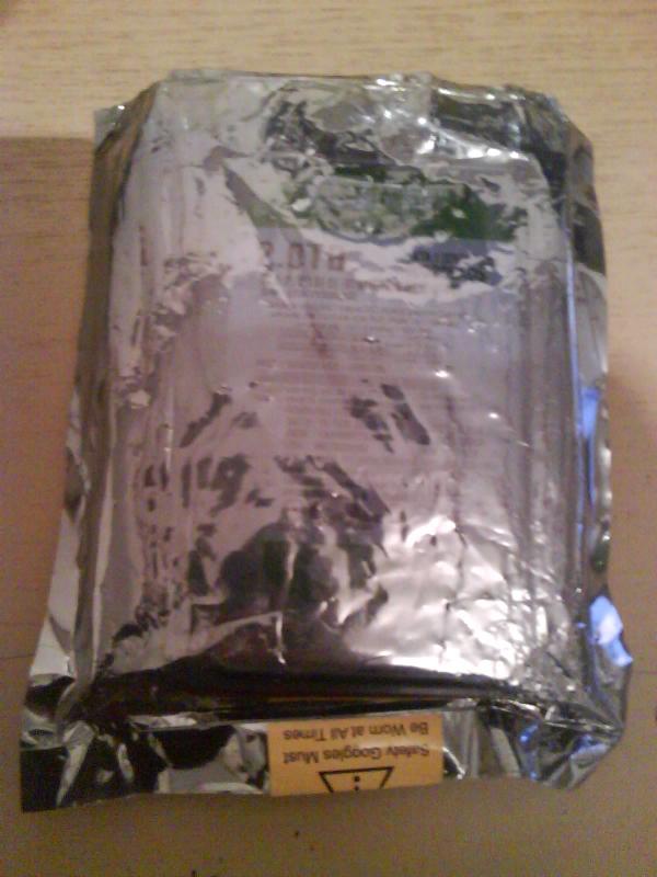

I am more concerned about the closing sticker on the antistatic bag : SAFETY GOGGLES MUST BE WORN AT ALL TIMES !! What did the bag contain BEFORE being used to ship the drive ?!? :buhahahaha:

In any case I would say it deserve a prize for the clever attempt : remove label, print out a "trustable" ( :lol: ) label , clean the top lid and attach it...
