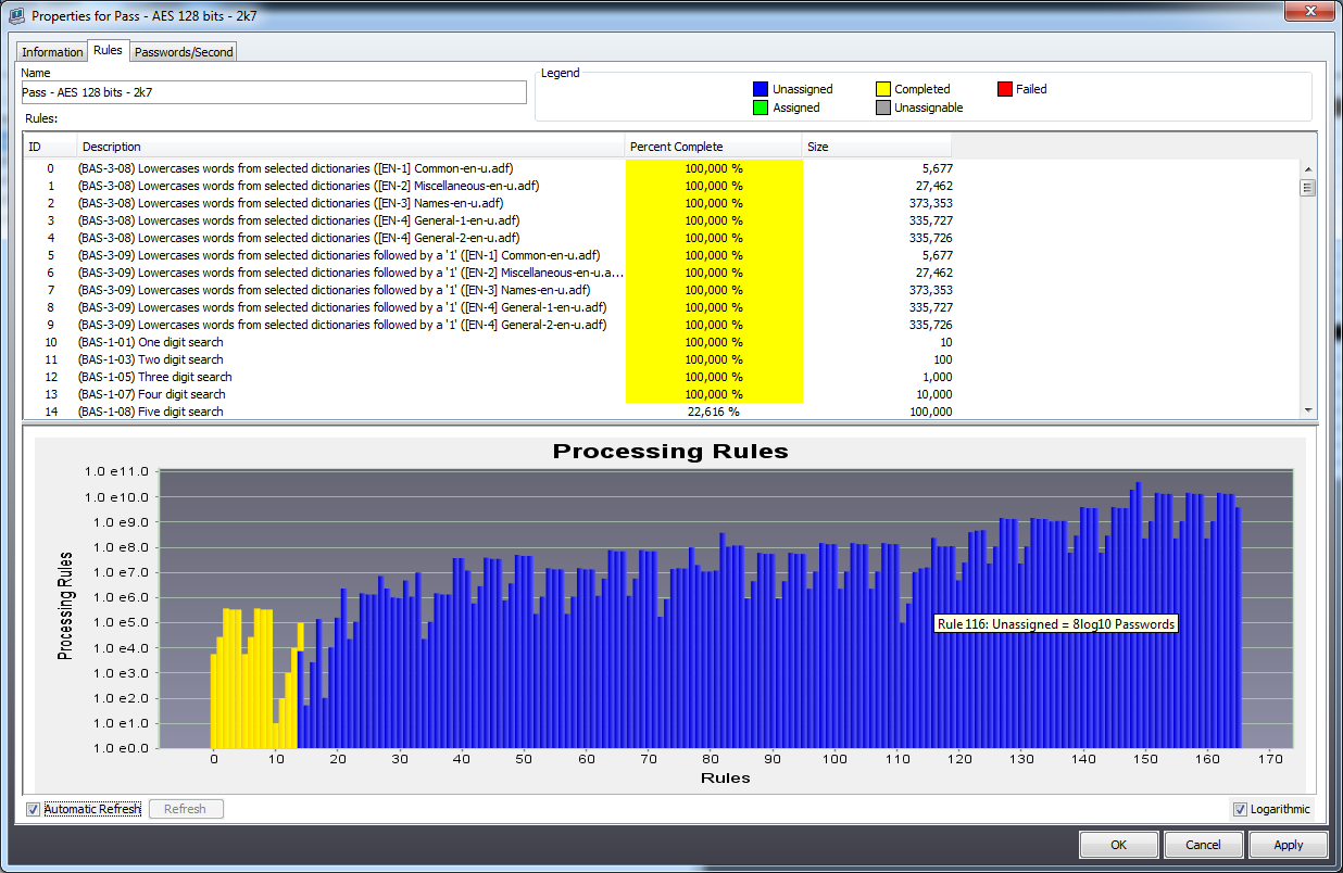

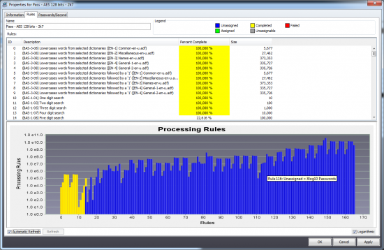

half an hour with my (old) bi xeon E5430 using PRTK default profile
i cannot tell you how many digits since i did set the cracking parameters to UNKNOWN
4 digits...

Oups...
I forgot my picture for thoose who don't know how PRTK works...
It's a mix between dictionnary and bruteforce

Took me 10 sec to find it using an old dual core 2 GHz.
Used Parallel Password Recovery Manager. Version 1.6
Used GPU support - ATI RADEON HD 3600 Series ....
Even if GPU can seriously help, actually it really depends on how the software try to bruteforce the password... Doest it begins with letters or digits and how are they are ordered... I think that's why me picture does matter...
If I seted up PRTK to only try 4 digits, it would have taken approximately only 1min
