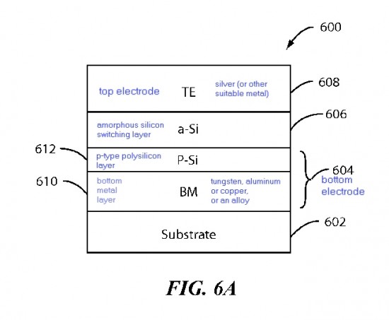

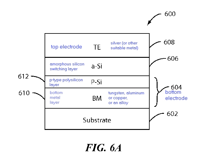

isnt tungsten a metal? And if the bottom layer is not metal, how can it be an electrode, or even conduct.
The patent documents clarify things a little.
http://patentimages.storage.googleapis. ... 134379.pdf
http://www.google.com/patents/US20130134379
"In the present embodiment, p-type polysilicon layer 612 is a boron-doped polysilicon, and bottom metal layer 610 is made of metal, e.g., tungsten, aluminum or copper, or an alloy thereof. In an implementation, the bottom metal is replaced with non-metal material that has a higher conductivity than the p-type polysilicon layer."

they don't say what that non-metal is though. pretty vague (silver(or other suitable metal)). It all sounds very too good, It will be interesting to see how it plays out. It looks like it could almost be a drop in replacement for NAND, unless a 32-bit bus is needed, but even then, trivial.. new controllers I'd guess.
 Post subject: Re: Crossbar RRAM
PostPosted: August 8th, 2013, 1:44
Posts: 17328
The vagueness is mostly my own. The patent actually lists several alternative metals, although it tries not to restrict itself to this list. I presume it is phrased this way in order to encompass a wider range of possibilities.
