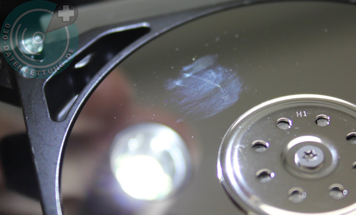

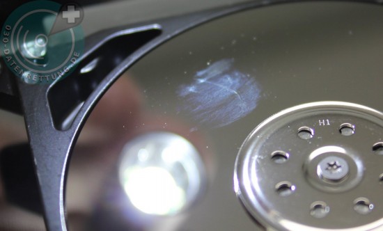

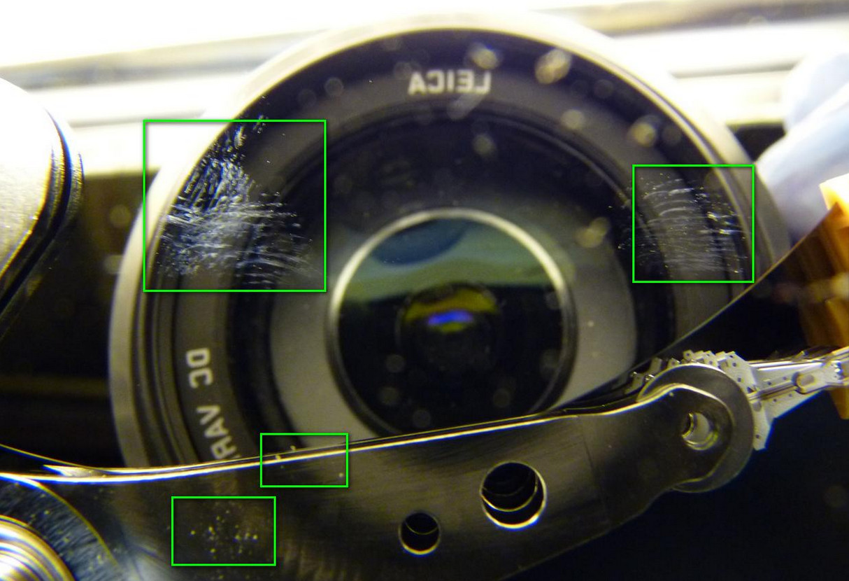

We just got in a new case of DIY, client first denied that the drive was opened but after I had a look ... I really dislike those friends of a friend that know something about IT and hard drives. This drive would have had a good chance for recovery, no scratches but now we had to reject the case.
Might be a good idea to open a thread with real world pictures to show what happens when you open a drive or let a friend open it.
File comment: Scratches ... abrasion from top cover was found on the magnets ...

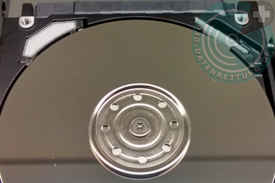

File comment: Platters are loose, so what? Alignment doesn't matter either. Might be clients friend changed platter order :-)

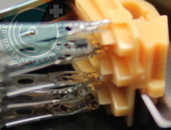

File comment: Even more particles ...
File comment: Dust, no there is not dust on the platter ... But find the fingerprints ...

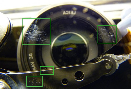

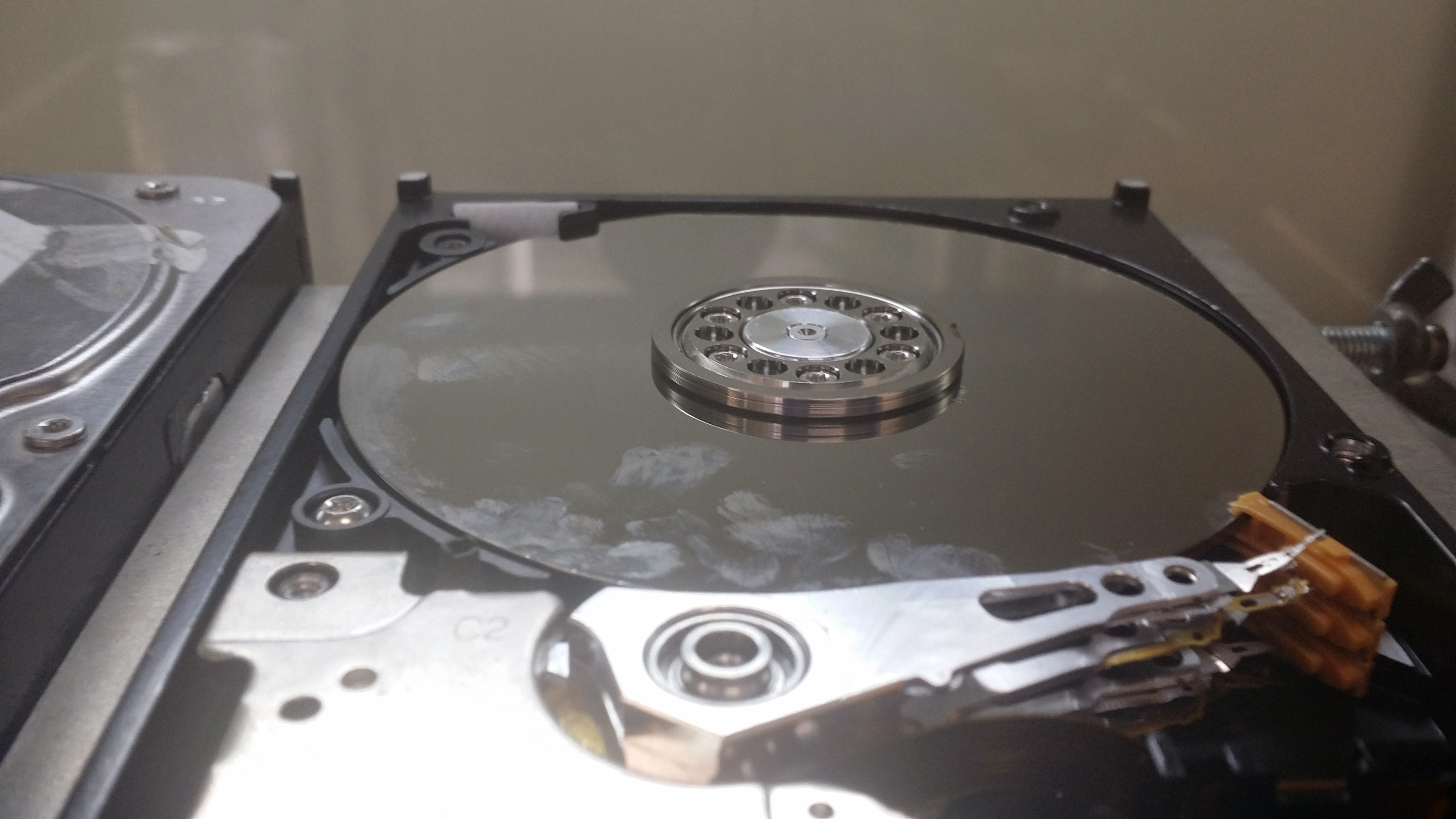

Here's an ST2000DM001 that was "opened by a friend in government who does forensics and data recovery," according to my customer. Hopefully, forensics and data recovery have nothing to do with his job in government, i.e., are a hobby.
Opened by a friend in government who does forensics and data recovery.JPG [ 209.17 KiB | Viewed 35531 times ]

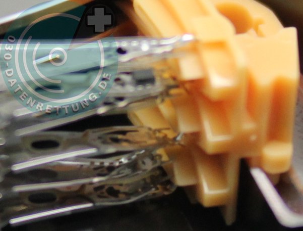

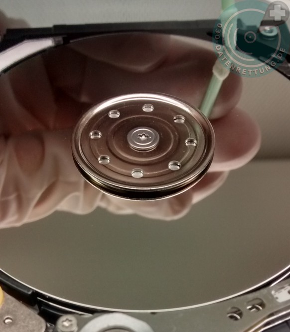

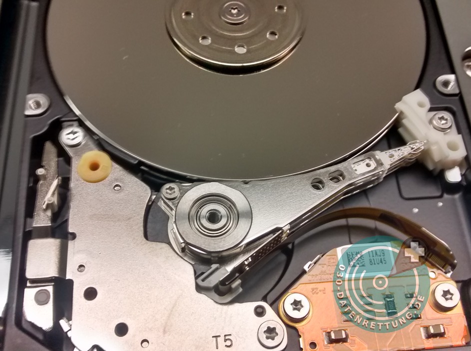

Why do they trust in youtube, it's so sad when the so called admin tries to help a young lady :evil:.
Two heads ripped from HSA, fingerprints everywhere, dust & platter damage. R.I.P.
File comment: Badly damaged HSA after drive was repowered
File comment: Stuck heads released by finger

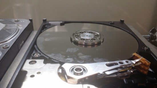

This is how the 'friend' IT guy 'fixed' this drive.
