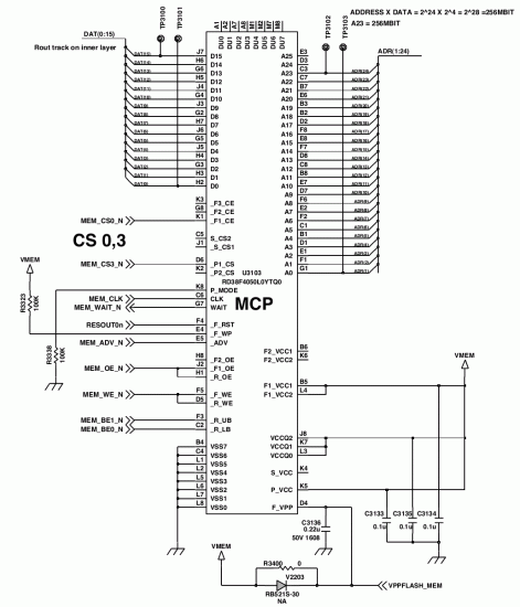

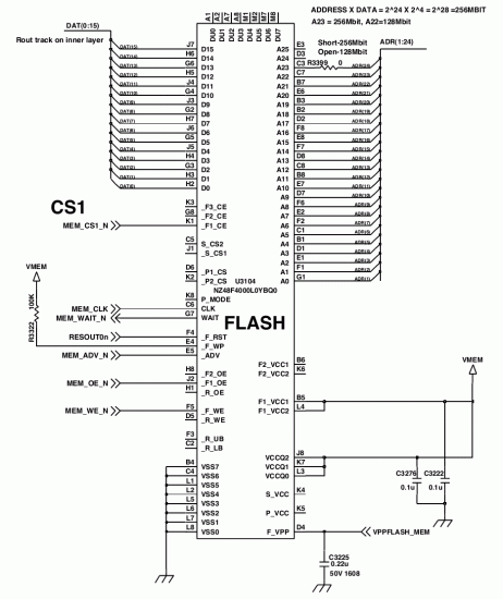

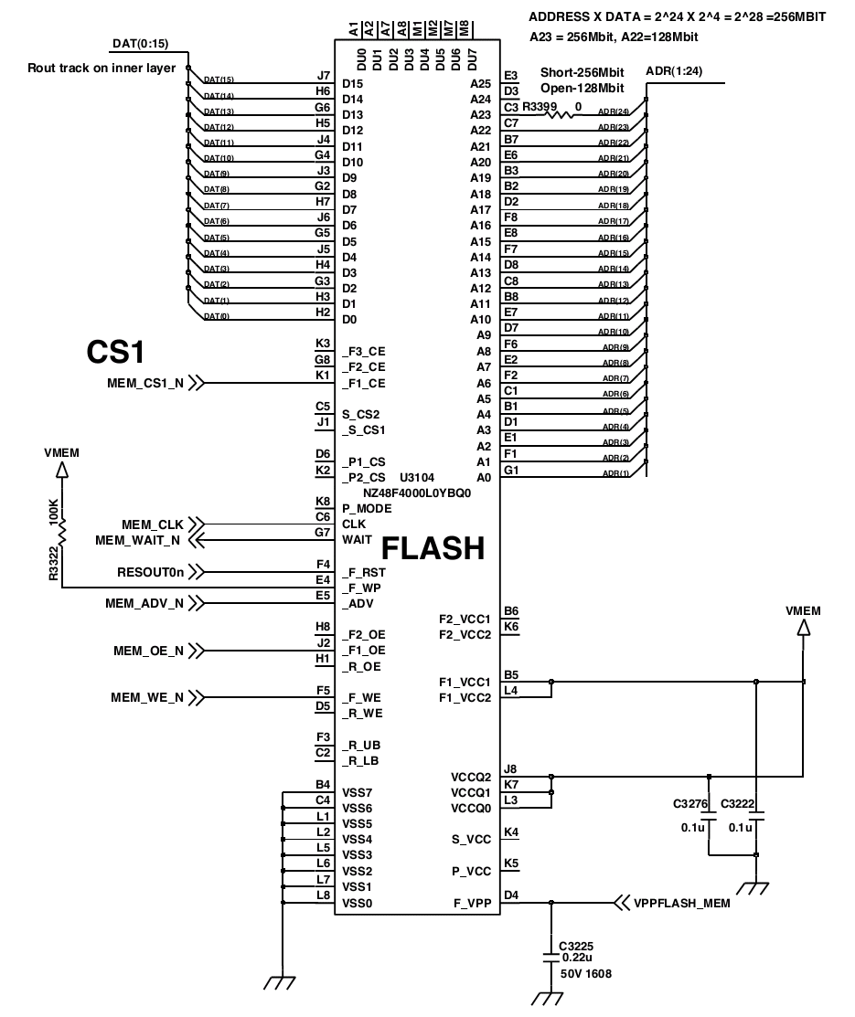

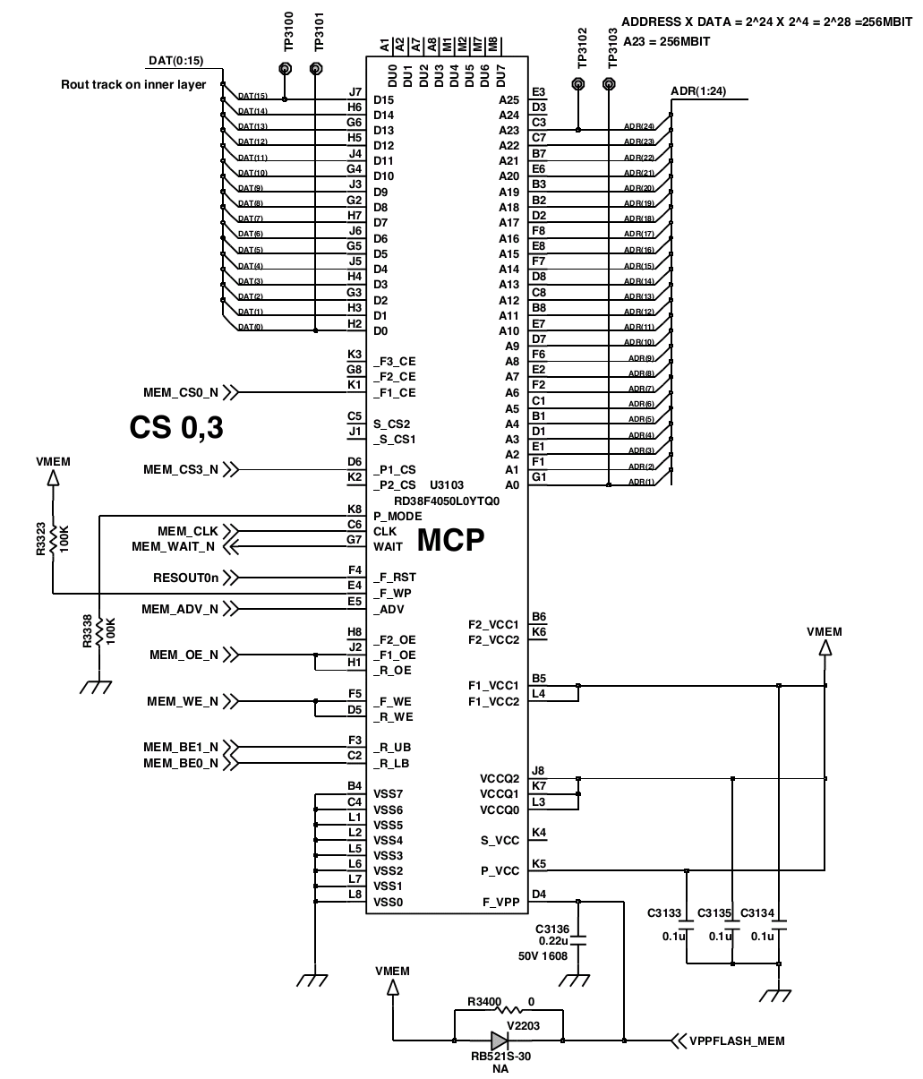

Here are the memory chips:
NZ48F4000L0YBQ0, 1.8 Volt Intel StrataFlash Wireless Memory (L18):
http://www.ece.umd.edu/courses/enee759h ... 190203.pdf
http://pccomponents.com/datasheets/RD38.PDF
Intel Flash Memory Programmer for RD38F4050L0YTQ0 and NZ48F4000L0YBQ0:
http://pdf.datasheetarchive.com/indexer ... 458169.pdf

Edit: Sorry, the Intel tool will read the memory chips. Accessing the phone is another story. I think you'll need to read the service manual for yourself.
