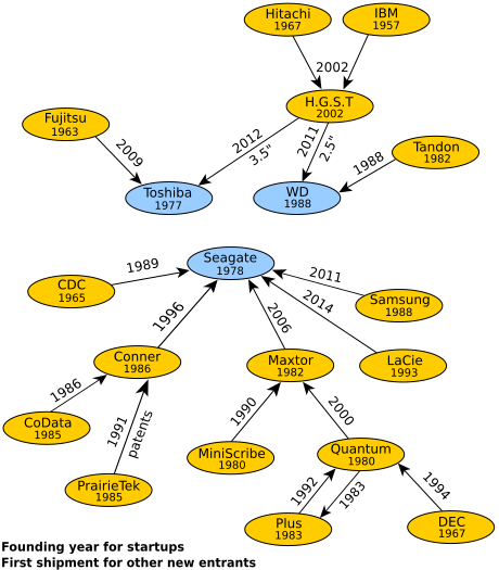

Not sure you can dismiss anything at all branded Seagate. There is a lot of tech in that company, and the crappy hard disks getting most attention should cop the heat, but with the following picture, there must be some good in there somewhere

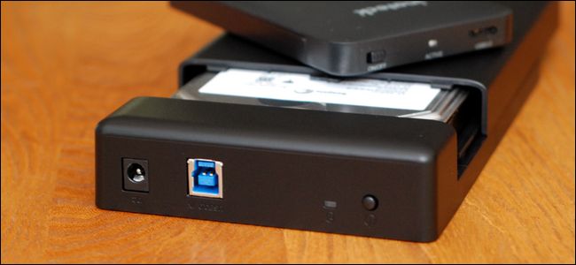

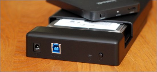

Ummm....I'm out of my depth, this is probably ridiculously simple for all on this forum but I can't find an answer in other places. I have a Barracuda 7200.12 drive from an old failed Mac, I've put it in an enclosure to recover the data. I don't know what power supply to use - the label says:
5v 0.72A
12v 0.52A
What power supply do I use?

A 3,5" drive uses 12V and usually 1.5A on the PSU.

Seagate's external drives usually come with a 12VDC, 2A adapter.

Thanks - I think I've got it, please confirm my understanding:
I'm using the enclosure in the attached picture, with power input and USB 3.0 sockets.
1. The HD will get its 5V from the USB cable
2. I use a 12V supply to the input power socket
Thanks for answering dumb questions.
