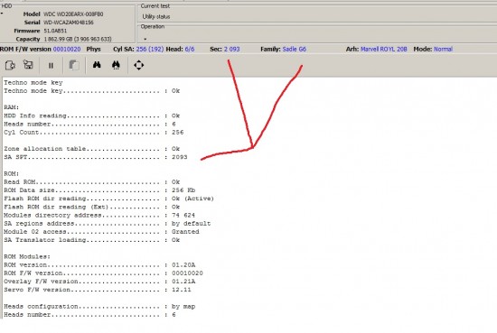

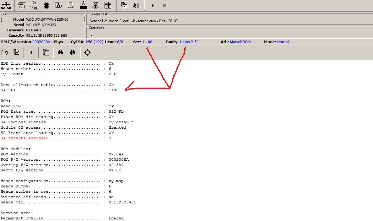

here is some of them,
you may compare it with your drive :wink:

Non-standard density, it is refurbished drive I suppose.

i don`t think so, it might be something else...
Both normal drives like the others, only i noticed their SPT looks Diff.
