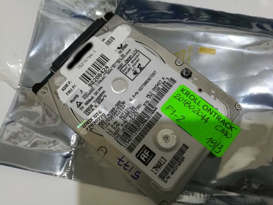

I really don`t know really how to explain this or actually how Clients thinks...
few months back client called from IT (supposed to know what he is doing) asked about McAfee Disk Encryption issue with one of the PCs a which as he said "Bad Sector" issue prevents the OS from loading, i gave him all the info. he needs to handle it but "They never listens" he left the drive with one of the freeware cloning Apps and after weeks he Killed it (now its Heads)
He came back calling me asking what to do, we told him now Its Heads cost will be Higher (he promised to send the drive to us very soon)
After Months he came with an Open drive (by OnTrack), they told him its not recoverable (and he paid Shipping + Diagnose fees) :lol: :lol: :lol:
I do believe that something can be done with it here... but really don`t know how good/bad they are?
If someone knows anyone there?
Thnx

Have you looked inside?
We a seen a few of these that have been “DIY’d to death” with platters you can see through! :-(

It was likely the customer that screwed around with it and O-Track just called it unrecoverable upon diagnosis.

I looked inside looks clean to me, client did not open it he just tried those cheap imaging free tools and ended up with heads
remember this is Mcafee Disk Encryption which means we should have a clone of the drive (as much as possible)
@ labtech
he did not open it (as he said) some clients or actually most are liars
@ Spildit
you are right, this Hitachi is really a headache
We have few donors for it but since its been opened by others and because of the clients behavior we will charge him for our 1st. donor (not refundable) if works fine if not i did not through my donor for nothing.

We did changed heads for this case again and found that 1 head is 100% gone (scratches) the other was done, so that no matter what it cannot be recovered
btw client has the Key no issues, my question was how good/bad they are? Ontrack i mean ( never had the chance to know someone)
