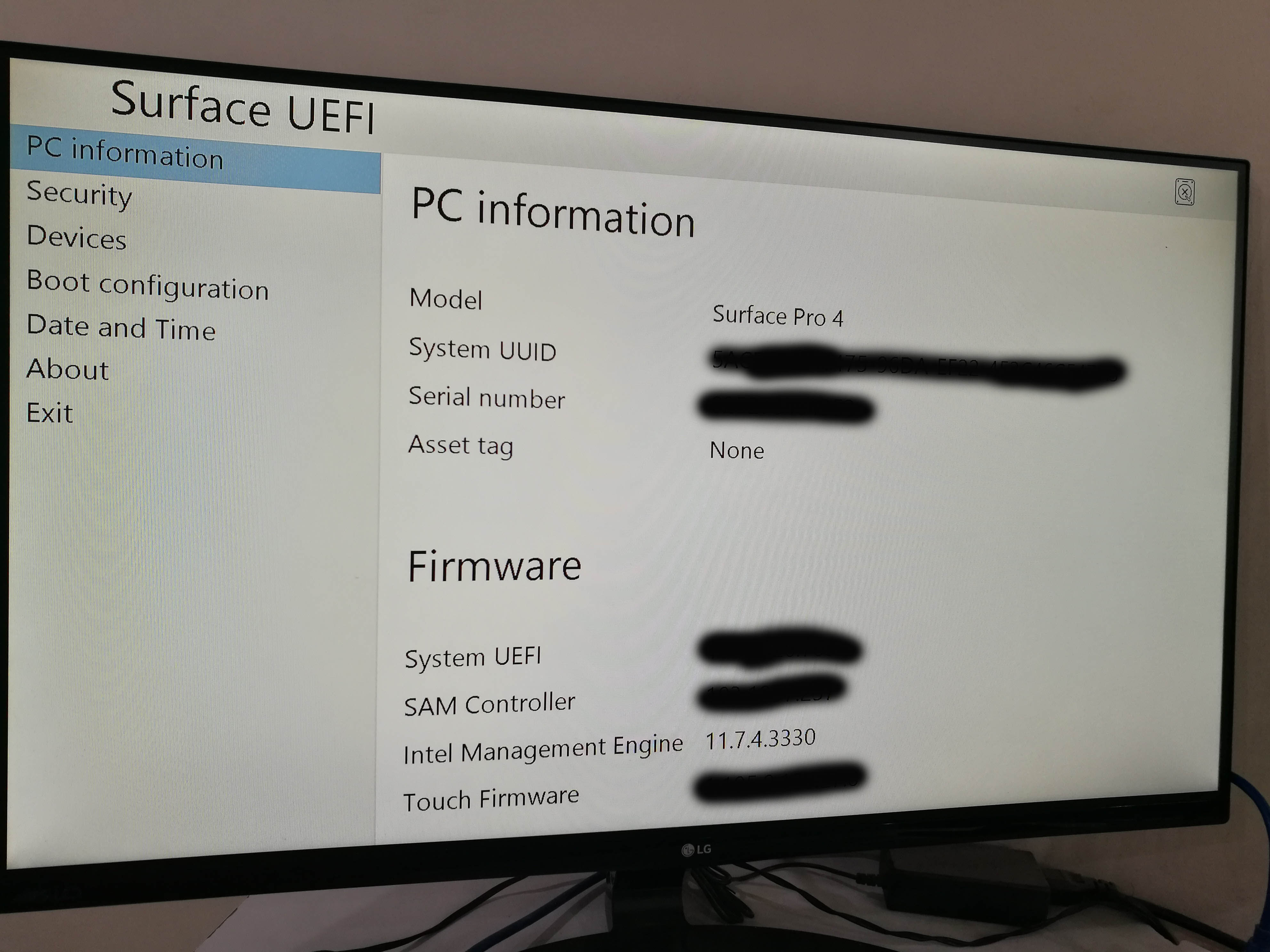

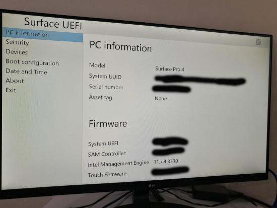

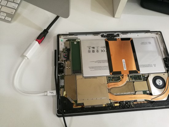

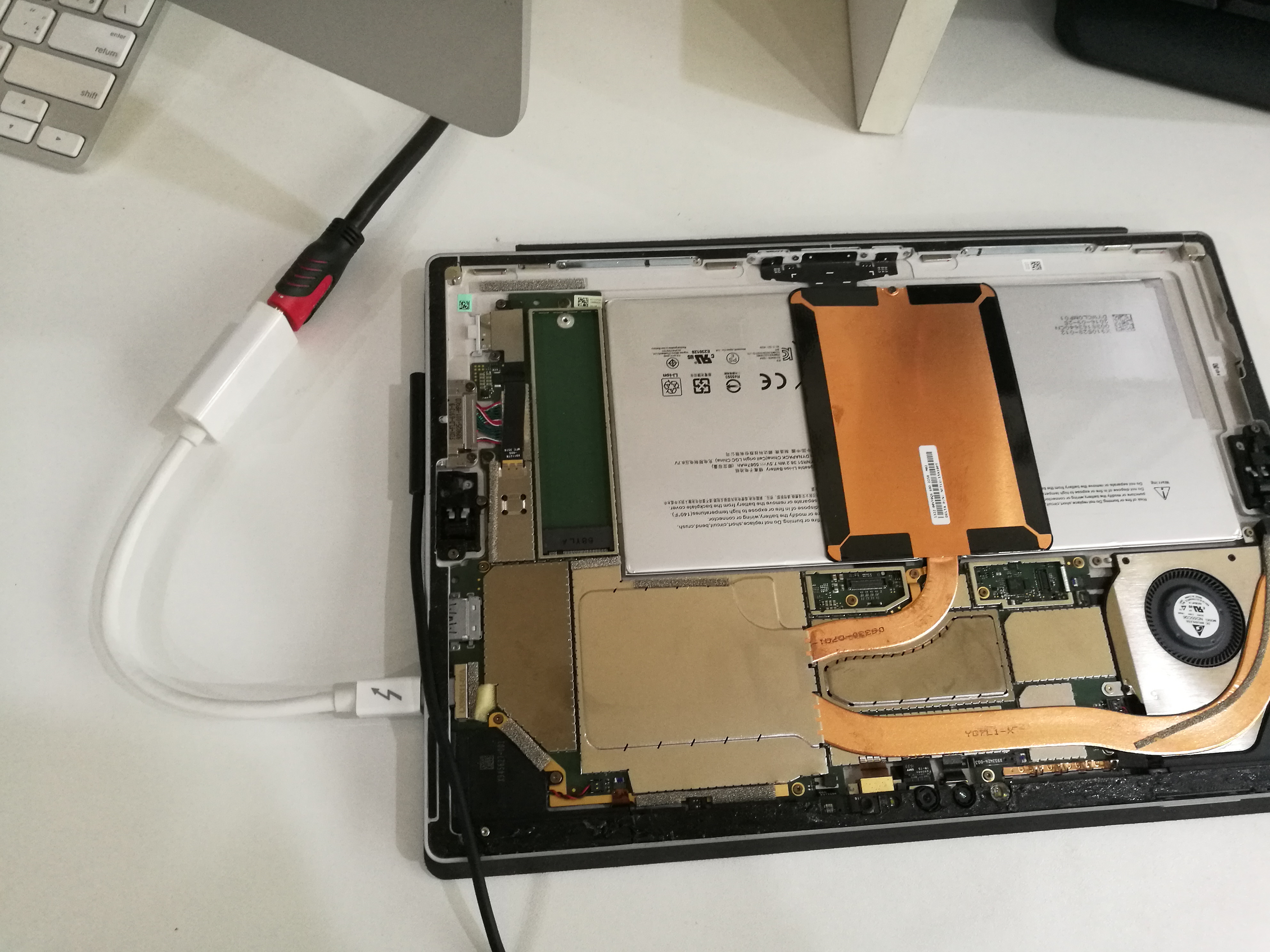

Well, i discovered this today only after wasting alot of time looking @the wrong direction...
I got a broken screen of MS Surface from one of my friends some time ago and i was planning to try something related to Bitlocker
but coz the screen is broken i left it somewhere till today..
I have 2 options, either Buy new screen >> fix it and use it.
OR
What i discovered today which might help a lot of us here...
I got this damn converter for about 10$ and we are in Biz. again... it worked (In Bios level booting), i was thinking maybe i have to configure it on windows (Clone/Split screens)
but it did work,,,
(Note: if doesn`t work from the 1st. time, leave the VGA cable connected and unplug then re-plug the power cable)
here is what i got attached here.

its regular cable,,, here is it
https://www.amazon.com/Microsoft-F7U-00 ... B01699044M
