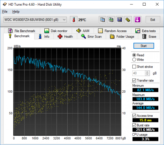

For years WD has been obfuscating the true spin speed of their "IntelliPower" models. Misleading statements from a variety of trusted sources, including WD's own support staff, claimed (incorrectly) that these models were capable of varying their spin speed from 5400 RPM to 7200 RPM according to work load. Now it appears that 7200 RPM drives are being passed off as "5400 RPM class".
For example, see the HD Tune benchmark graphs for the WD80EFZX-68UW8N0 and WD80EZZX-11CSGA0. These drives are advertised as "5400 RPM class".
http://www.hddoracle.com/viewtopic.php?f=21&t=2549&start=140
AFAICS, the width of the access time graph would suggest that these drives have a maximum rotational latency of 8ms. This corresponds to the time for one complete revolution at 7200 RPM (8.33ms). The corresponding latency for a 5400 RPM model would be 11ms.

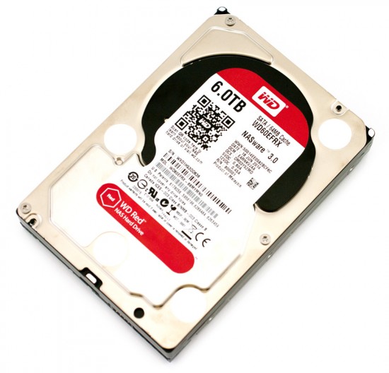

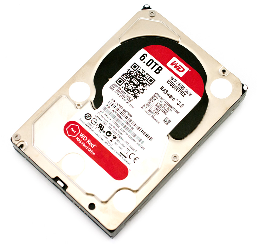

Here is a 6TB drive (WD60EFRX-68MYMN0) which is advertised as "5400 RPM class":
Note the "NASware 3.0" on the label. The WWN (50014EE ...) identifies the model as a native WD.

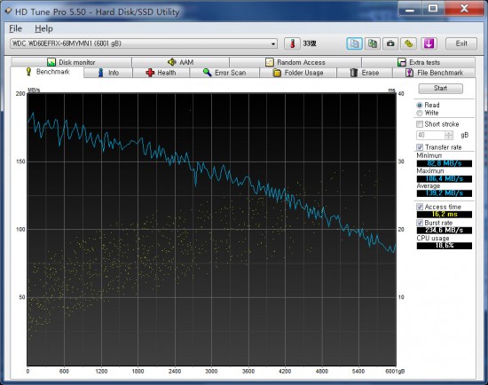

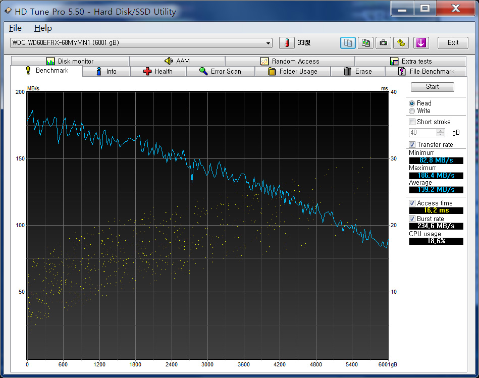

Here is a HD Tune read benchmark for a WD60EFRX-68MYMN1:
Note that spread in the access time data points is about 10ms. This corresponds to one complete revolution of a 6000 RPM drive.

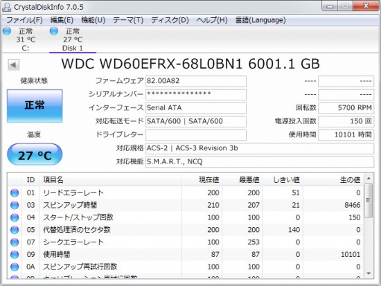

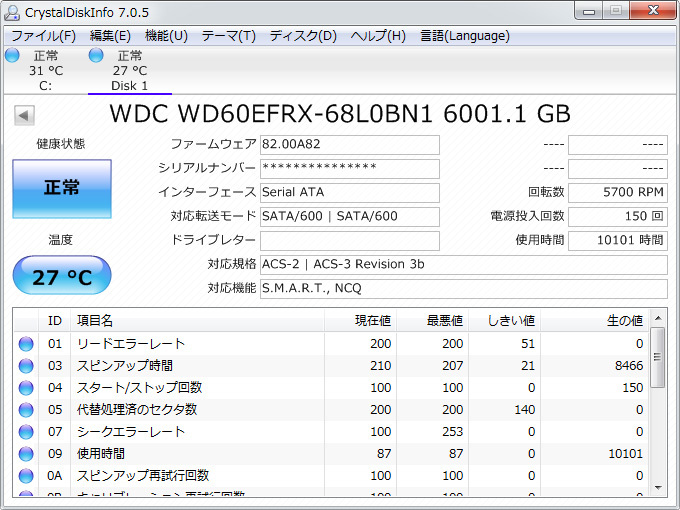

Here is a CrystalDiskInfo SMART report for a WD60EFRX-68LOBN1:
Note that the RPM is 5700. This is the speed reported by the Identify Device ATA command. Earlier "IntelliPower" models would usually report 0 for this word.

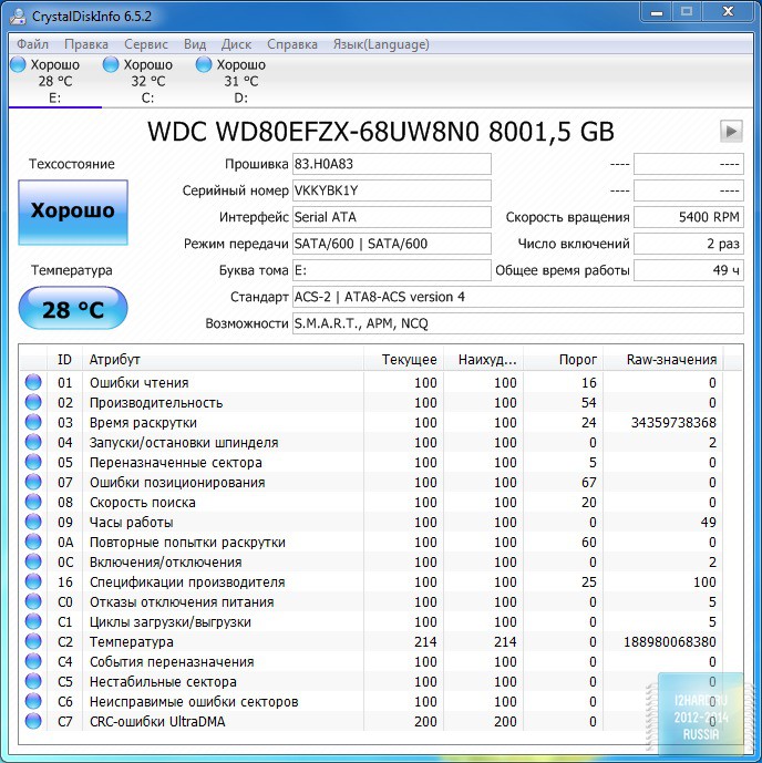

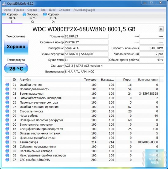

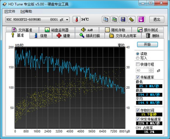

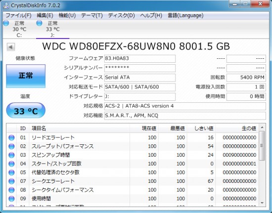

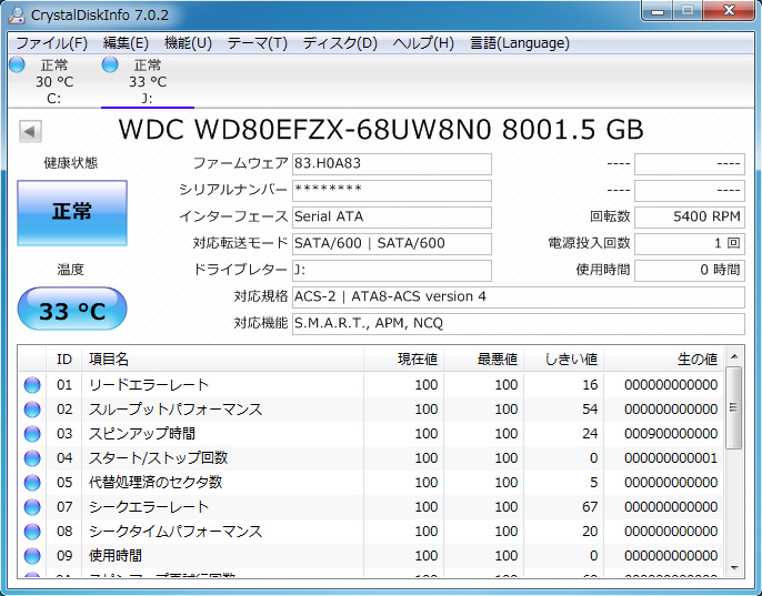

Now let's examine the WD80EFZX-68UW8N0. This time CrystalDiskInfo reports a spin speed of 5400 RPM:

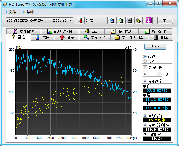

The drive's label once again proclaims "NASware 3.0", but this time the WWN identifies the model as a native Hitachi (5000CCA ...). So if the firmware is Hitachi's, then where does WD's NASware 3.0 fit in?

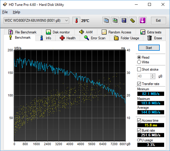

Moreover, HD Tune benchmarks show a spread in the access time data points of about 8ms. This corresponds to one complete revolution of a 7200 RPM drive.
So what is going on? Why the (apparent ?) inconsistency between the observed and reported spin speeds?

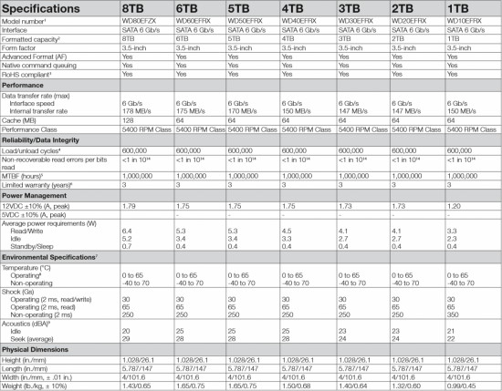

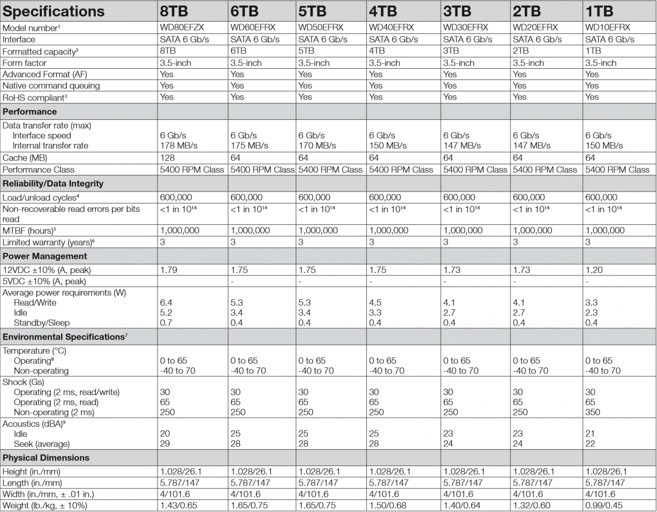

7681_02_wd-red-8tb-helium-filled-wd80efzx-nas-hdd-review_full.png [ 602.24 KiB | Viewed 48613 times ]
Western_Digital-3805661149-eng_spec_data_sheet_2879-800002.pdf [701.15 KiB]
Downloaded 2238 times

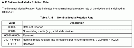

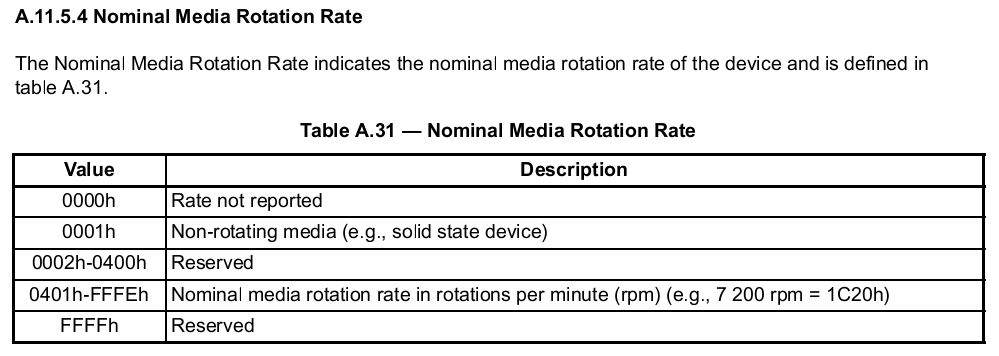

Does this mean that the ATA standard allows a manufacturer to misrepresent the actual rotation rate?

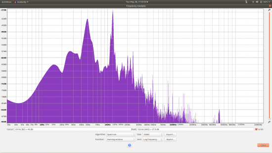

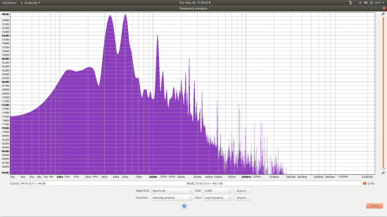

The audio sample in that thread ...
https://forum.hddguru.com/download/file.php?id=18559
... was analysed by Devonavar of Silent PC Review.
HDD off
HDD on
There is a peak at 120Hz (7200 RPM) but none at 90Hz (5400 RPM).
Devonavar of SPCR wrote:
Thanks for the recording (and thanks especially for including the start-up, which makes it very clear what the difference was between off and on). There's a lot of background noise in the recording, but, because you (@michaelchiklis) were able to get the microphone so close, the evidence is quite clear. This drive is definitely spinning at 7,200 RPM.
I've attached two screenshots which you can use as documentation; one that shows the audio spectrum with the HDD off, and the other with the HDD on. When the drive is turned on, there's very clearly a spike at exactly 120Hz (See the "Peak" box in the screenshot). This corresponds to 7,200 RPM. 7,200 Revolutions per minute / 60 seconds per minute = 120 revolutions per second, or 120Hz. The 120 Hz tone is clearly audible in the recording, and you can hear it increase in pitch as the drive powers up. There's no question in my mind that this tone is produced by the disk rotation.
If the drive was spinning at 5,400, we would expect the spike to occur at 90Hz (5,400RPM / 60 = 90Hz). Similarly, a rotation speed of 5,700 = 95Hz and 6,000 = 100Hz, so the other estimates I saw in the HDDguru thread are also incorrect.
Feel free to quote this and attribute it to me (Devonavar of SPCR) in the thread if you like. Hopefully this can resolve the question for you.

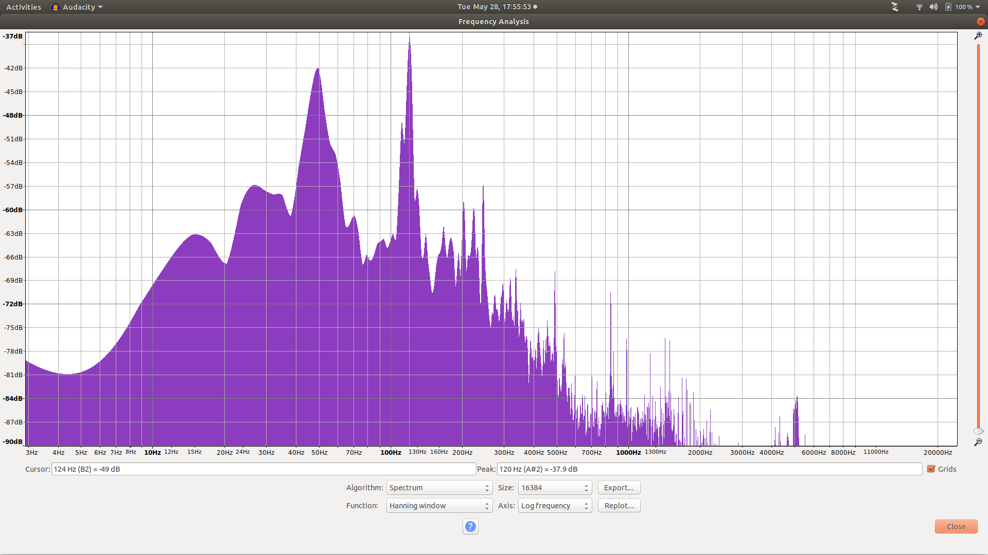

Here is a weird HD Tune benchmark:
Western Digital Red Pro WD141KFGX 14TB Review (Page 7 of 11):
https://aphnetworks.com/reviews/western-digital-red-pro-wd141kfgx-14tb/7
https://aphnetworks.com/review/western-digital-red-pro-wd141kfgx-14tb/hdtune.png
The access time graph is about 15msec wide. This corresponds to the rotational latency of a 4000 RPM drive.

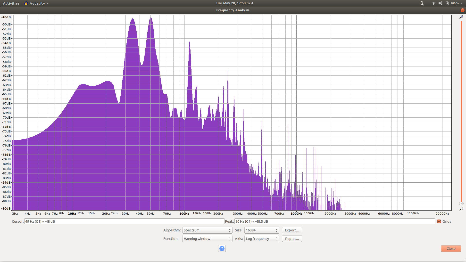

 Post subject: Re: A new twist to IntelliPower?
PostPosted: May 16th, 2020, 20:00
Posts: 17223
I was wrong about the WD141KFGX. An audio spectrum analysis proves that it does in fact spin at 7200 RPM.
https://aphnetworks.com/forums/topic/7859-5400-rpm-class-hdd-spins-at-7200-rpm/
